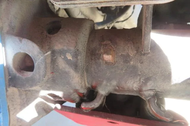

Something I found out at Rausch Creek. The SteerSmart trackbar bracket bolt hits the axle tube at full flex. You can see where the undercoating is peeled away.

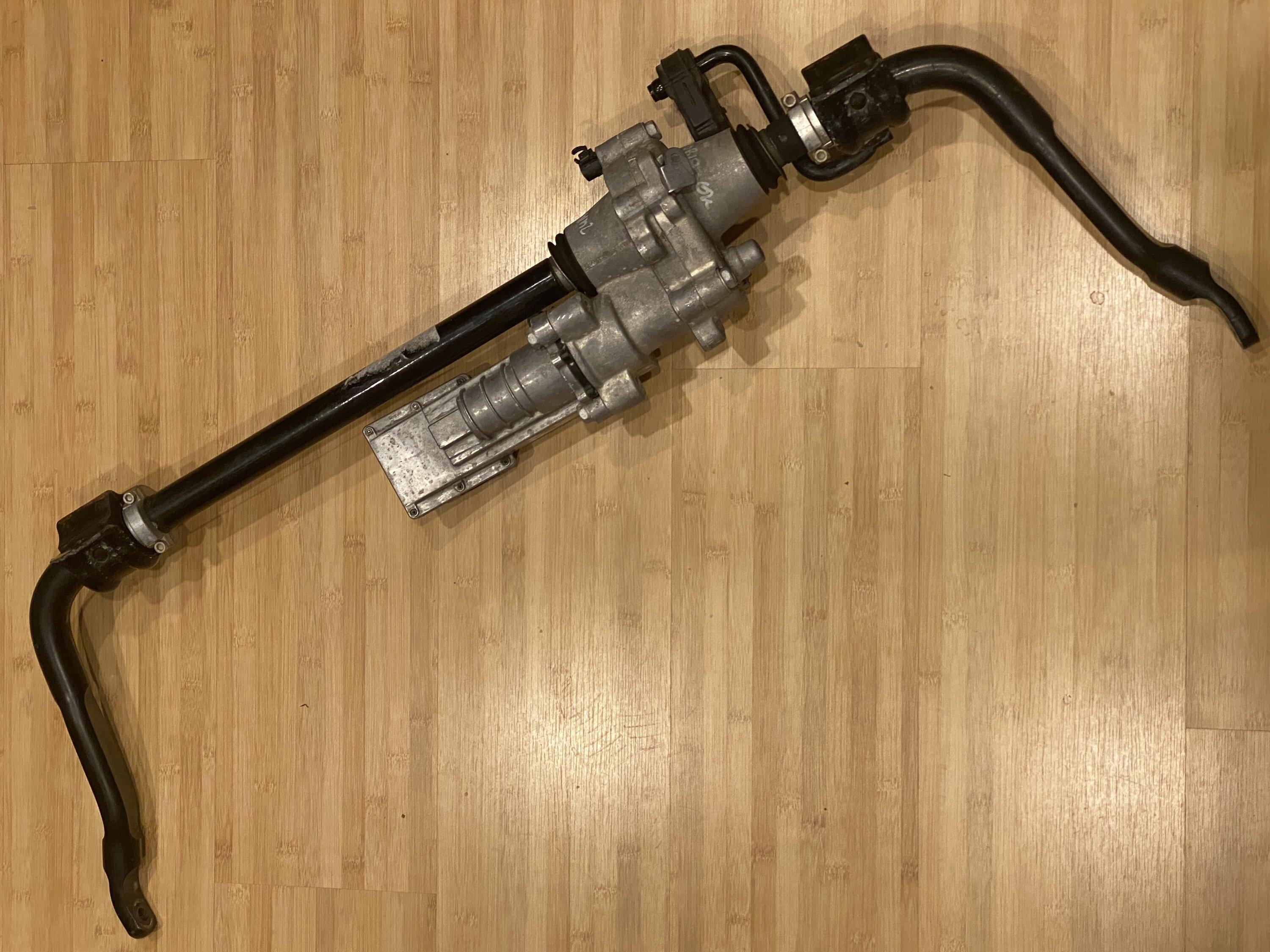

I'm in the process of doing this to my JT
Electronic Sway Bar Disconnect converted to manual disconnect using an EVO NoLimits disconnect.
Im sure you’ve probably seen this video, but figured id post it just incase.
Pretty sure he did exactly what you are doing.

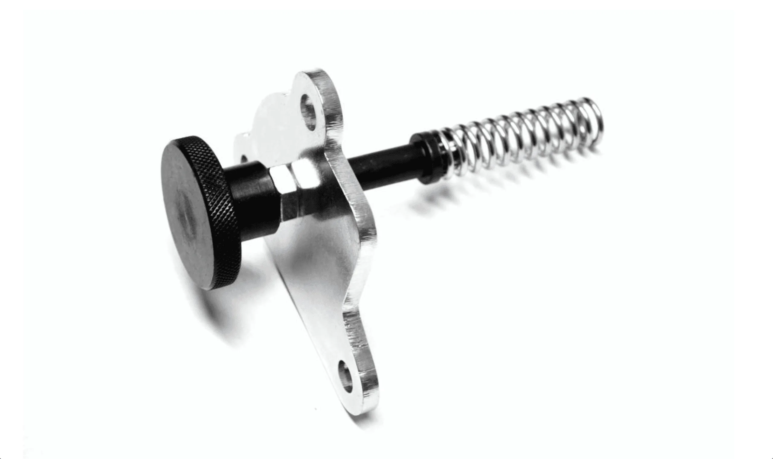

Can you guys school me on why you would do this ? I thought part of the charm of the Rubicon was the electric disconnect ???
This is so the ones that don't want to install the whole electrical system and update the computer can have an easier and quicker disconnecting sway bar. After the install of course.

I'd like to find a disconnect to install on mine - but with all my stuff and a front receiver......... likely wouldn't fit.
The other sort that replace the links - nice but the price for what they are is WOW. And with my back and all, I'd rather push a button.
This looks like the way to go and is still pushing a button in a way HAHA.
Also, I have a Sport S which comes from the factory without the Sway Bar Disconnect button.
40,514
54,044
And without the integration, the screen telling you it's connected or not and so on.....
There is a way to add a flex shaft so that you can relocate the knob in the wheel well.
