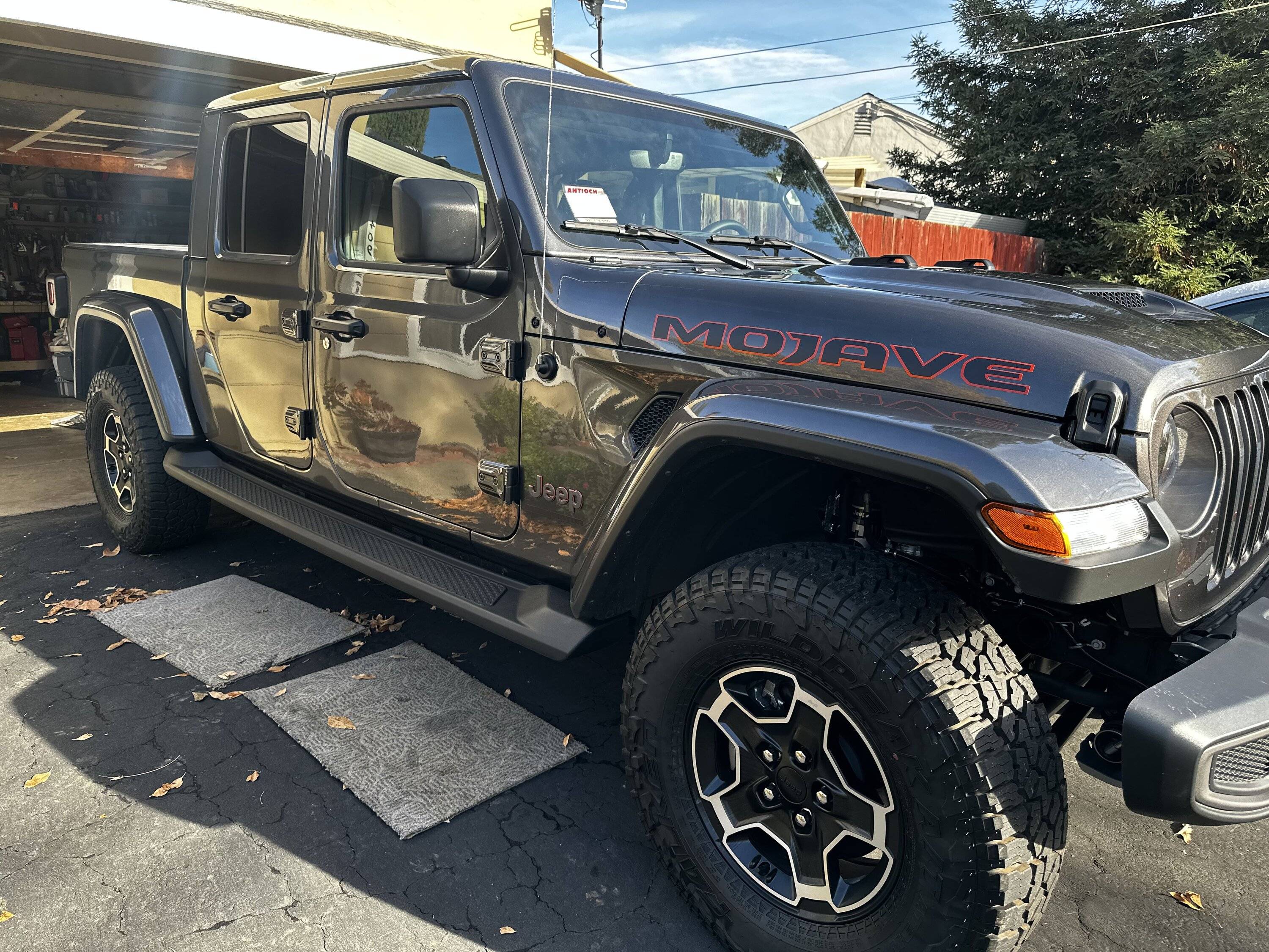

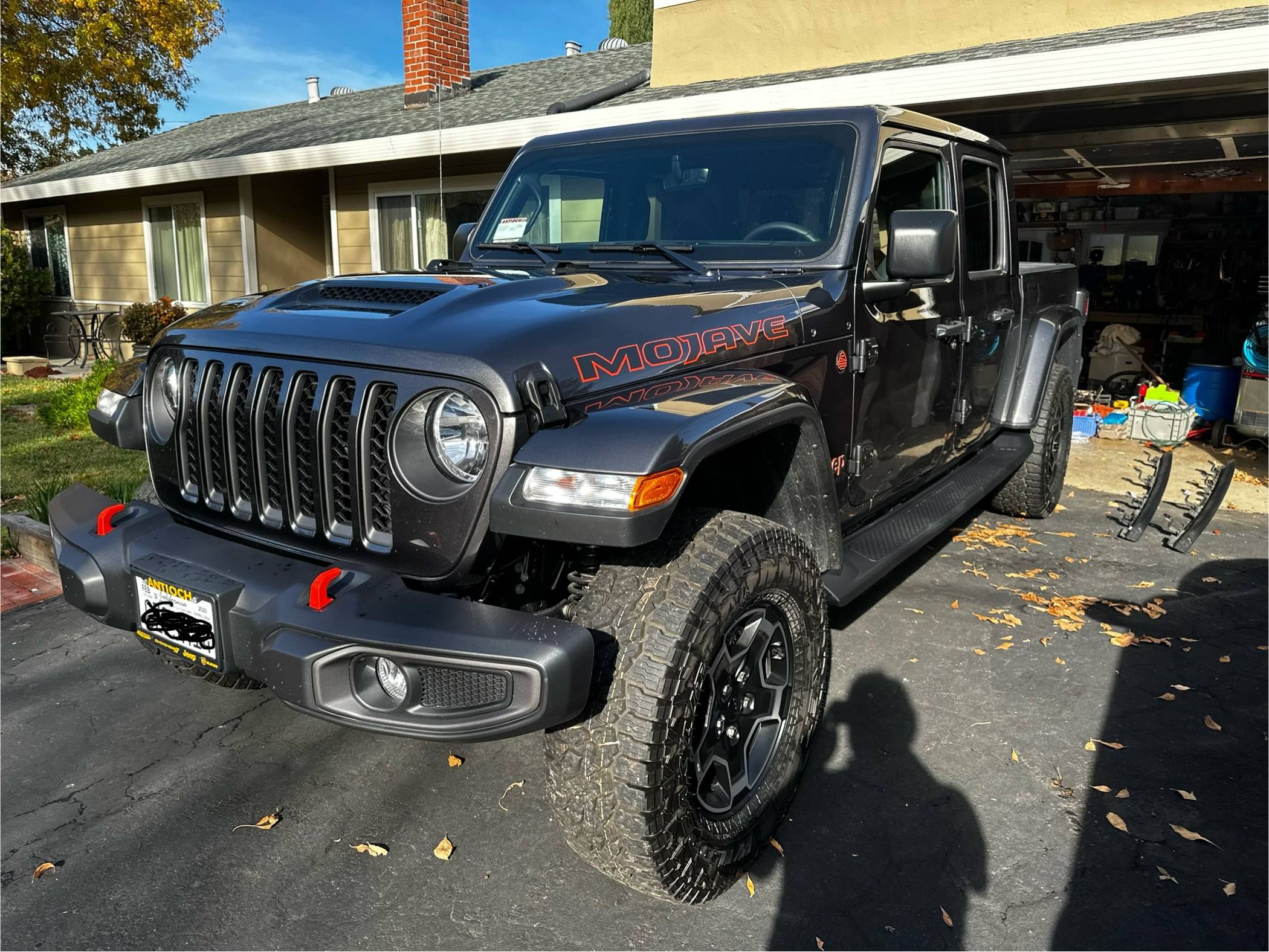

Installed the AEV procal and calibrated for the new 37s today. I'm guessing nobody at AEV has ever Installed a security gateway bypass plug or similar product like the tazer mini as they actually state that their wiring harness that requires me to pull the glove box, fish wires under the console, and add pin outs to the obd2 port (which requires removing the panel under the steering wheel which also gives easy access to the security bypass plug) is somehow "easier to install"? I'm all for fuzzy marketing but that is an out right lie. A bypass plug is easier to install than just the pin out portion of their install let alone the removing the glove box, pulling back carpet, and fishing under the console. Why even put that in their FAQs? It's not true and anyone who's ever done both will confirm that.

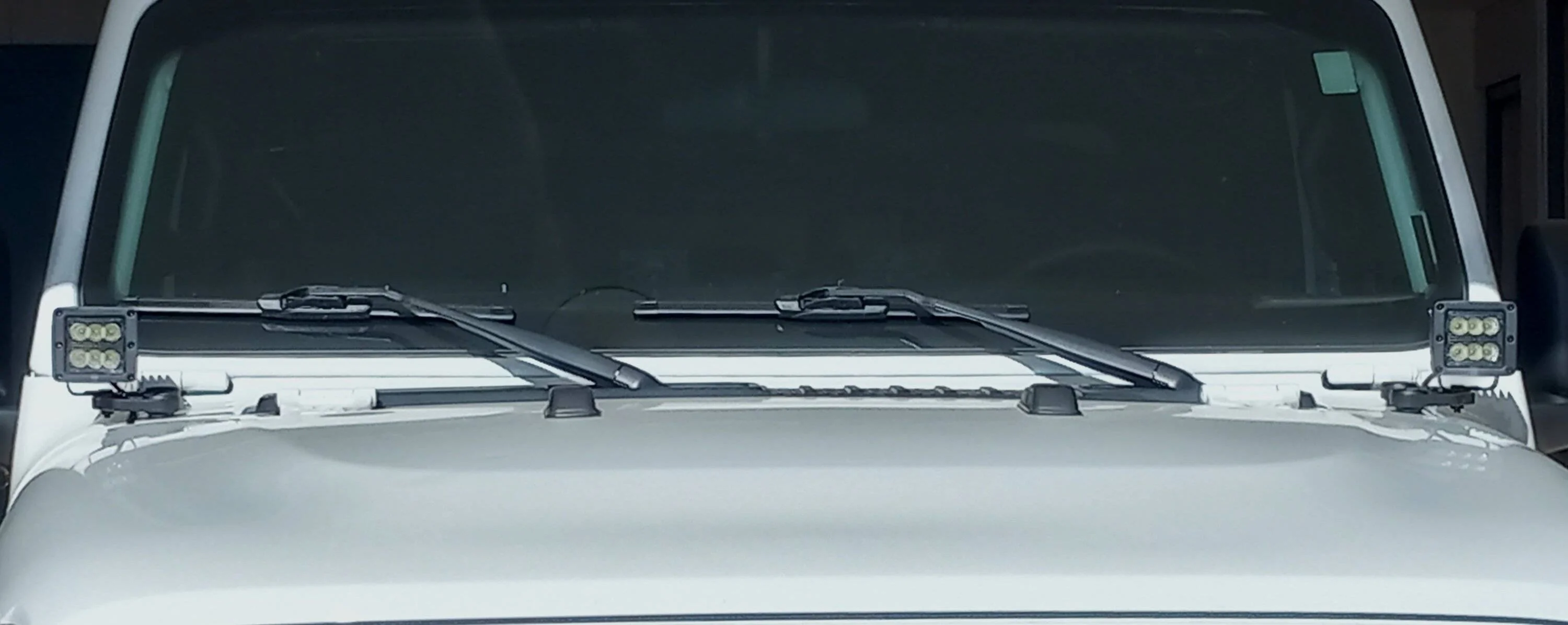

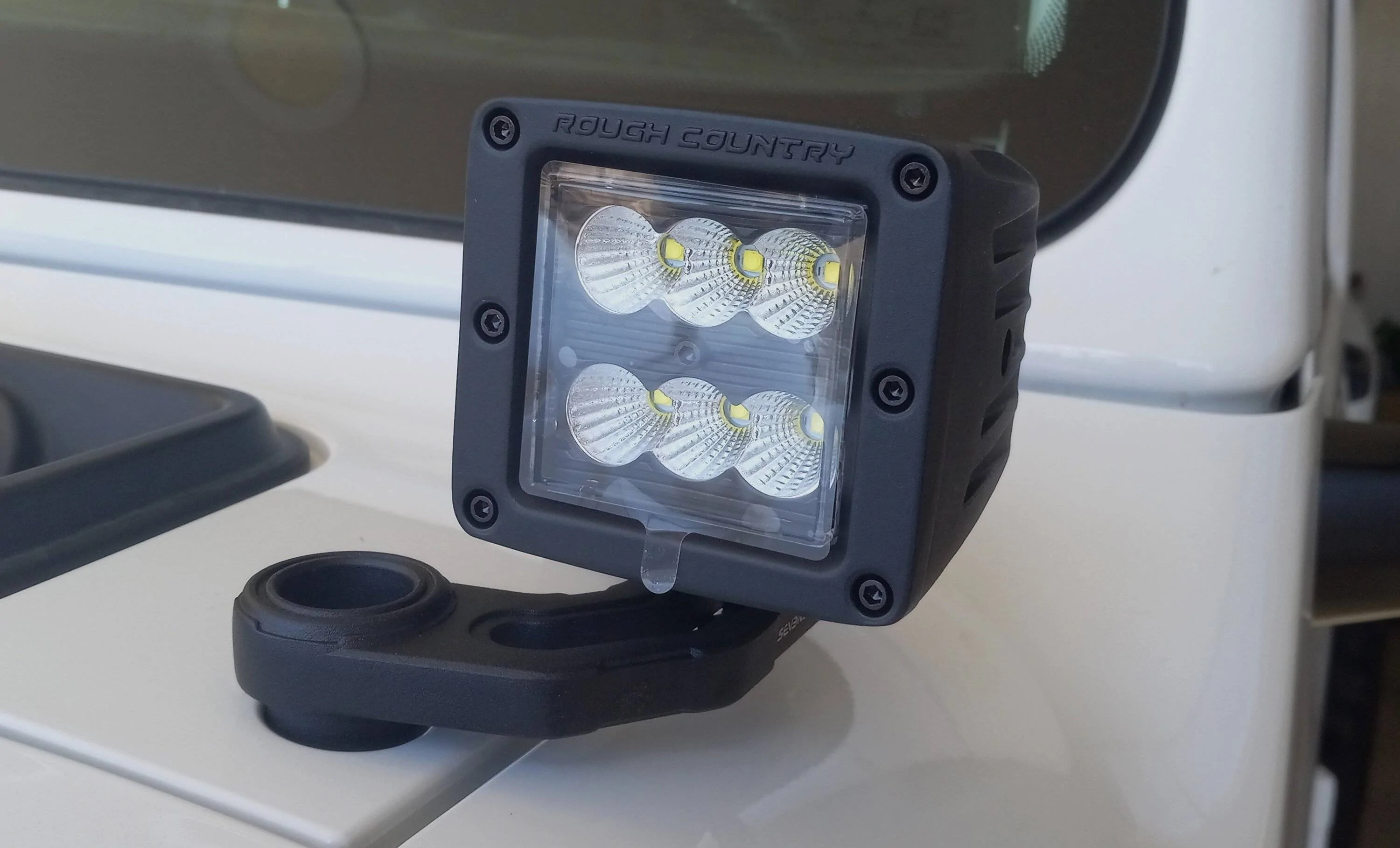

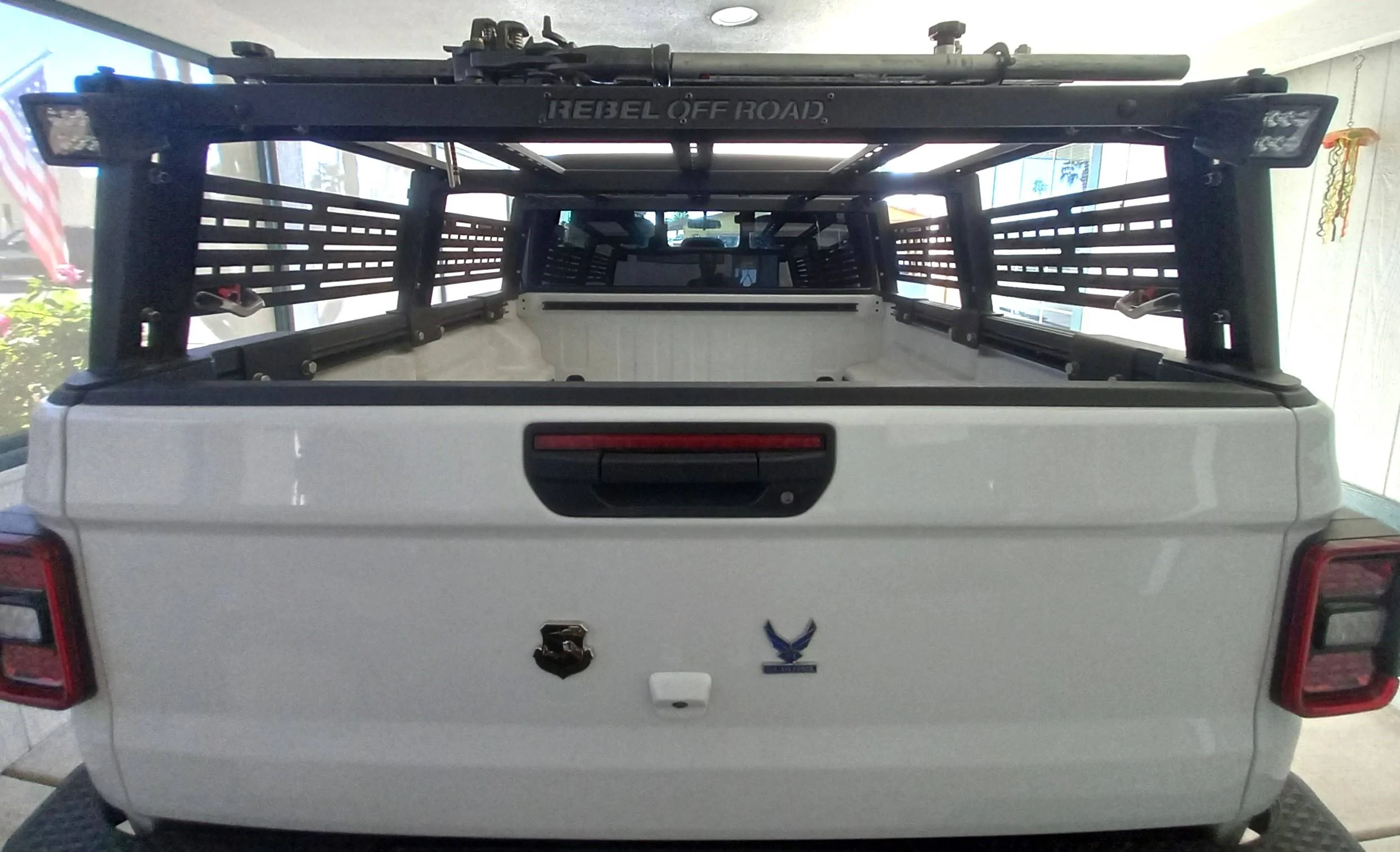

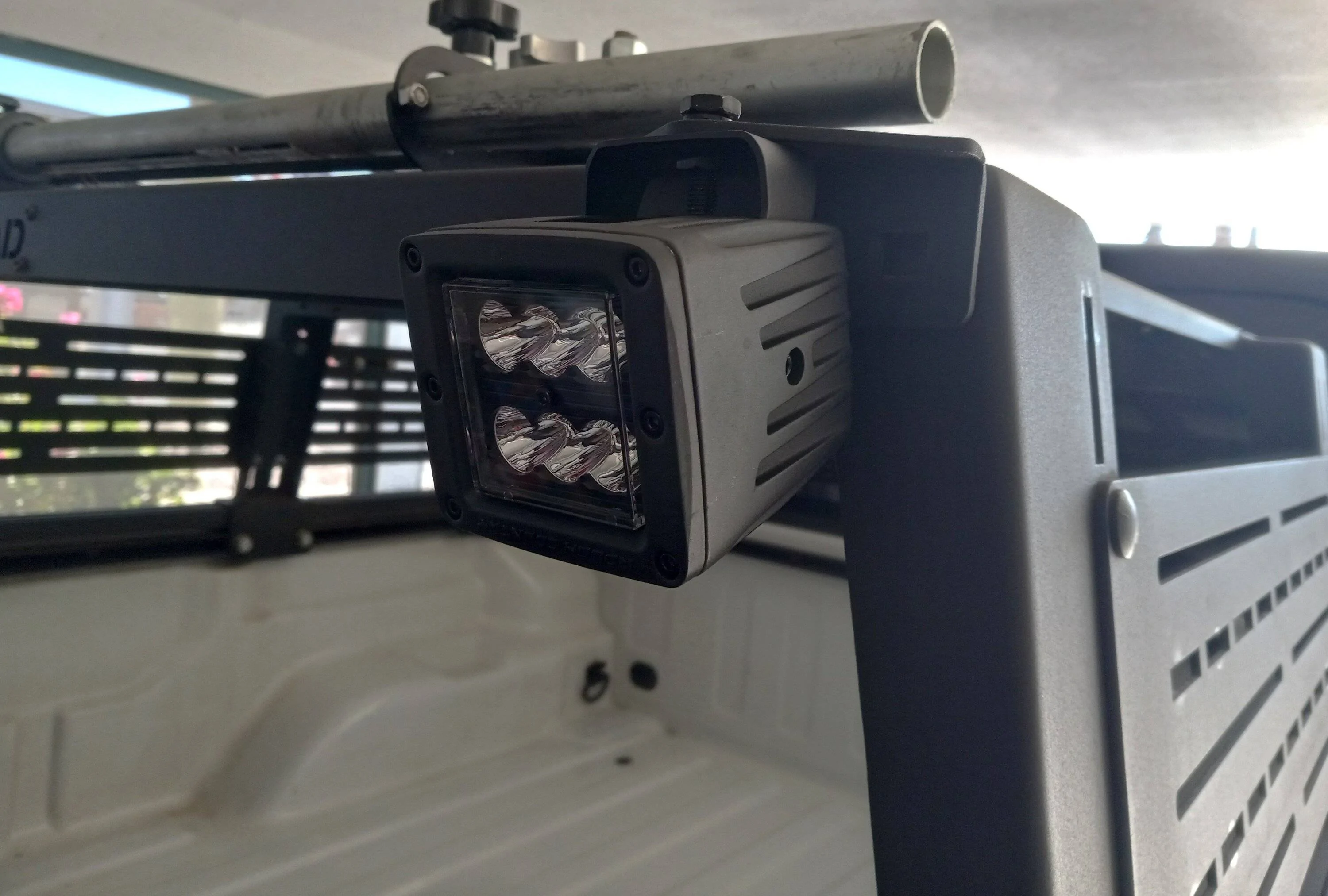

I added some Front & Rear 4 pod LED lights, a Voswitch grab handle switch pad, some front mounts and a Voswitch power center.
Here are the lights:
Jeep Gladiator What did you do TO your Gladiator today? [ADMIN WARNING: NO POLITICS, NO GUN TALK] 20231206_131023
Jeep Gladiator What did you do TO your Gladiator today? [ADMIN WARNING: NO POLITICS, NO GUN TALK] 20231206_115132
Jeep Gladiator What did you do TO your Gladiator today? [ADMIN WARNING: NO POLITICS, NO GUN TALK] 20231206_115039
Jeep Gladiator What did you do TO your Gladiator today? [ADMIN WARNING: NO POLITICS, NO GUN TALK] 20231206_115051
I may relocate the rear lights to the side of the bed rack in the slot you see at the top of the frame above the side panel. We'll see....

Looks good. How did you run the bed rack wires to the front? I’ve been thinking about doing the same. Down the front of the bed to the rail underneath?

The passenger side light conductor runs over to the driver's side underneath the U-shaped top support of the bed rack. This area also includes the harness connectors for both cables.
Then, the power conductor passes through a series of existing holes in the end flange of each top horizontal support of the bed to the corner of the bed rack at the cab.
From that top corner the conductors go down, then over the bed rail in the front, they run down the back of the cab and then are routed to the engine compartment. One passes through the firewall for the connection to the grab handle switch, the other heads to the Voswitch power center mounted near the battery.
