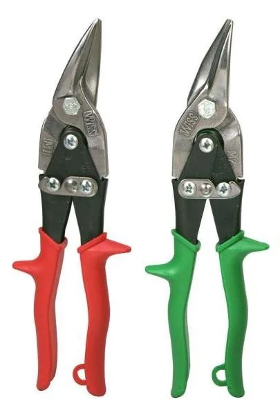

@Jeepmonster
Next time you need to cut thin plastic like that, get a set of right and left Wiss Aviation sheet metal snips.
Jeep Gladiator What did you do TO your Gladiator today? [ADMIN WARNING: NO POLITICS, NO GUN TALK] wiss-snips-m123r-64_600
They work so much easier than cutting plastic with a utility knife and not as messy as a Dremel. Dremel cutting blades are too small/expensive for real work anyways.

@Jeepmonster
I should've mentioned that I tried aviation snips as well. I wasn't able to maneuver it well enough to cut through. Mine may not have been good enough quality and needs sharpening.
