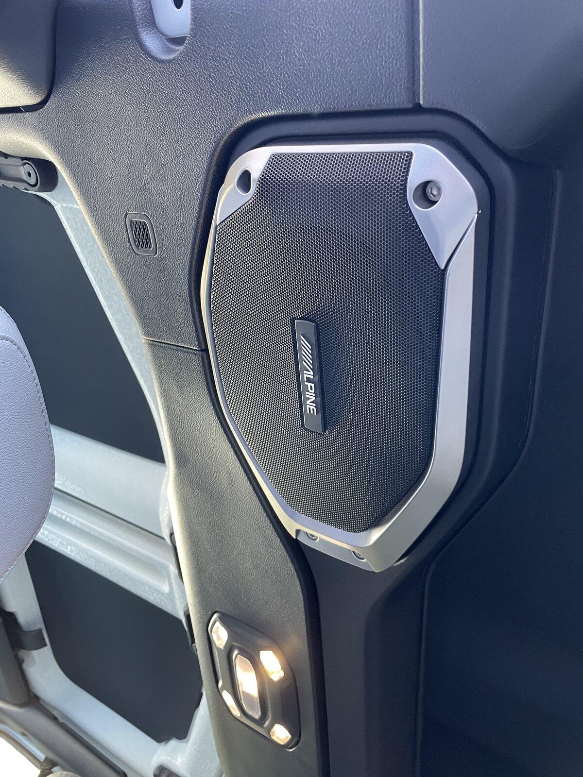

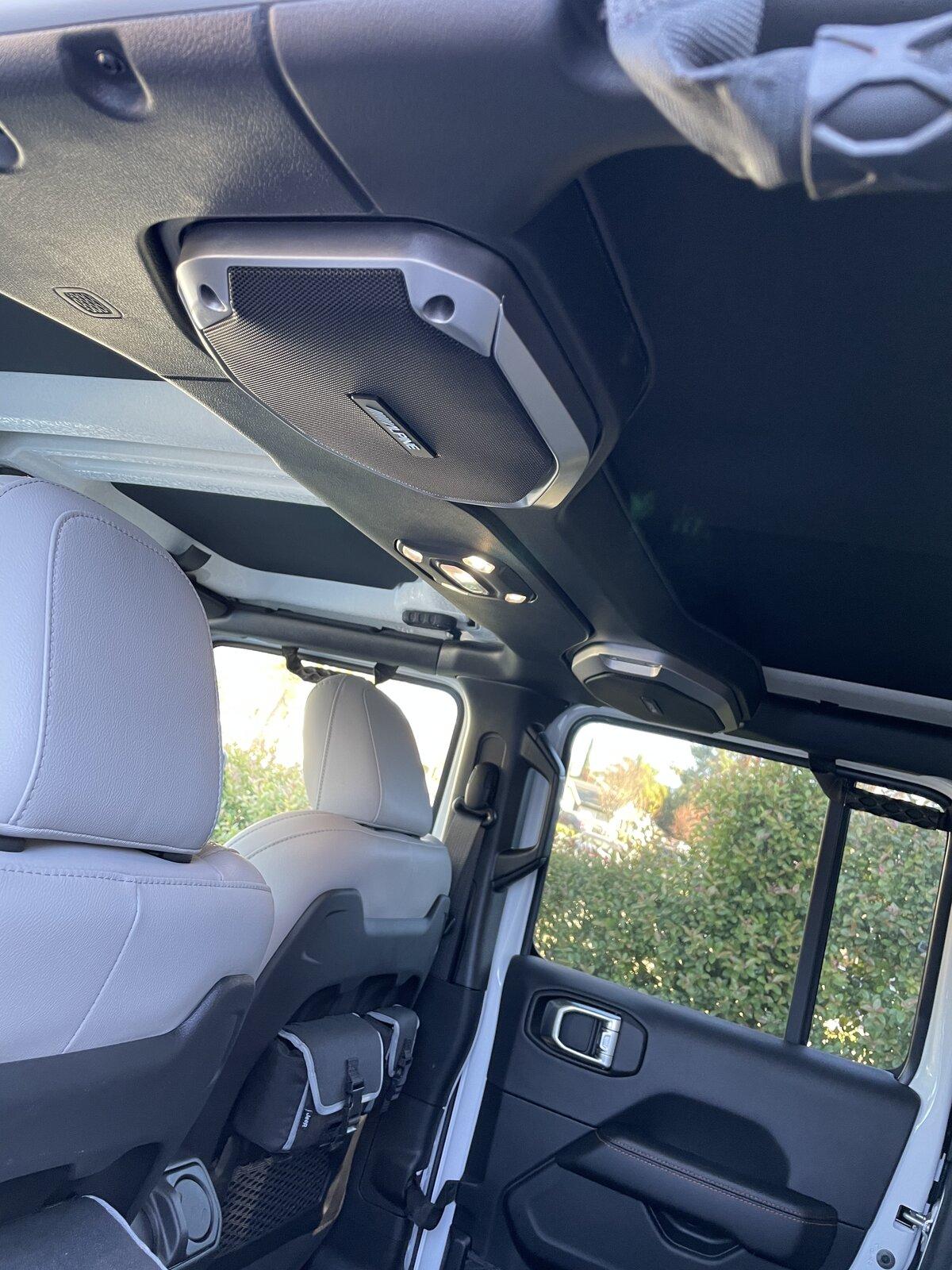

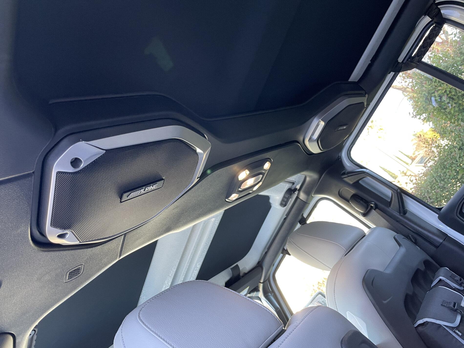

Finally got around to installing those alpine 450 dollar speakers. However first off I gave those dart kicker speakers a shot and rode around with them for a couple of days. Honestly there was little difference between the stock and the dart kickers. so today I finally got my air saw in the mail (25 bucks on Amazon) and went a cutting. i can see why they recommend the air saw as there is quite a bit of plastic to remove in there. The air saw made quick work of it and with the pattern overlay they give you it makes it easy. Literally took me 10 minutes to cut out both as well as clean up the edges and vacuum the mess. So the alpines have a built in crossover that fits off the plug from the 3.5 speaker. I used that and the speakers did work however the sound was really tinny and the 6.5 in it put out very little sound. So than it dawned on me why crutchfield gives you these speaker adapters. It’s to disconnect the cross over and directly connect the 4“ speaker wire. The 3.5 wire however I left in the crossover. After doing this it was literally a hundred times better. Better highs, mids and base. I assume the crossover is for jeeps that don’t have the alpine system and run straight off the head unit. All in all I am very happy. I was pretty worried however at first as these set me back around 500 with shipping and tax. Also the included instructions are useless. But it was easy trial and error. im contemplating even replacing the dash and kick panel speakers as they roll bar ones work so much better now. Looks wise they are nice. They stick out about a half inch more but look more professional I’d say. If you’ve got the cheddar and a little bit of time it’s very well worth it.

they are much much louder. I originally had the bar turned up a lot in the equalizer. I had to adjust it quite a bit to get it where it needed to be. They are definitely 2x or more louder than the originals. Honestly the amound of engineering jeep put into the roll bar speaker pods youd think theyd include a better speaker setup. For the cost of the premium audio they really should have upgraded the speakers as well. The included speakers are literally crap. Theyre coming with me on my next desert trip so I can lay waste to them with a fury of bullets to vent my utter disappointment in them.
I may still upgrade the dash speakers as I already bought a pair and it seems pretty easy to upgrade, but Im on the fence really about it as Im quite happy now. I certainly am not going to attempt the knee speakers though.

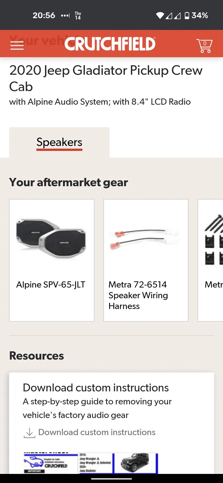

I also installed the Alpine SPV-65-JLT. Also from Crutchfield. First, I followed the instructions to connect the speakers as stated by the Alpine instructions with the connector that matched the new speakers (just one, the one that went to the tweeter) and was like "meh" with the sound. Called Alpine directly and they said to not use the mid connector ("just not needed" is what they said), but I remember reading @athous post above, and disconnected the crossover cables that were already connected with the new speakers, and used the Crutchfield connector instead and to the mid harness...and that did the trick for me. (and makes sense to use the two factory connectors, not just the one like Alpine suggests). Now the sound is a hundred times better.
What headliner is this? And are the knee speakers hard to replace?
As a complete novice I’m wondering if these alpine speakers can work with an aftermarket amp and if so, how?
those look like mopar headliners

So this thread is interesting. Quadratec claims these Alpine upgrades do not really upgrade the Premium system as they are not technically designed for it. However, you two guys said they really do make that big of a difference? I think my Premium system sounds great but always up for upgrades also for better audio.
How much improvement would you guys say you got? I don't mind dropping the cash but not if the improvement is marginal.
Also, what connectors does Crutchfield include? I do not see any mention of additional connectors? Their site also says the speakers do not work with the 8.4" premium system? Is that only because it is not direct plug and play?
the only thing the premium sound includes is a sub and a larger screen. Other than that, nothing. On top of the sound difference we’re hearing about, they’re much nicer looking as well
