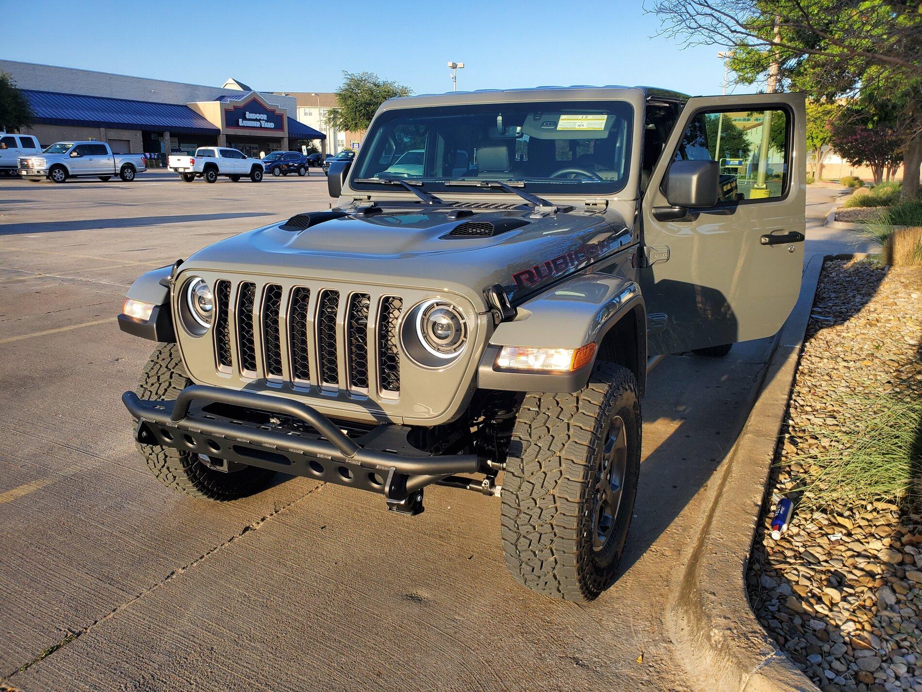

Shame it’s heavy. Something like that in aluminum would be ideal for my needs. I’m trying to keep my build as light-weight as is reasonable so as not to degrade the Mojave suspension performance.

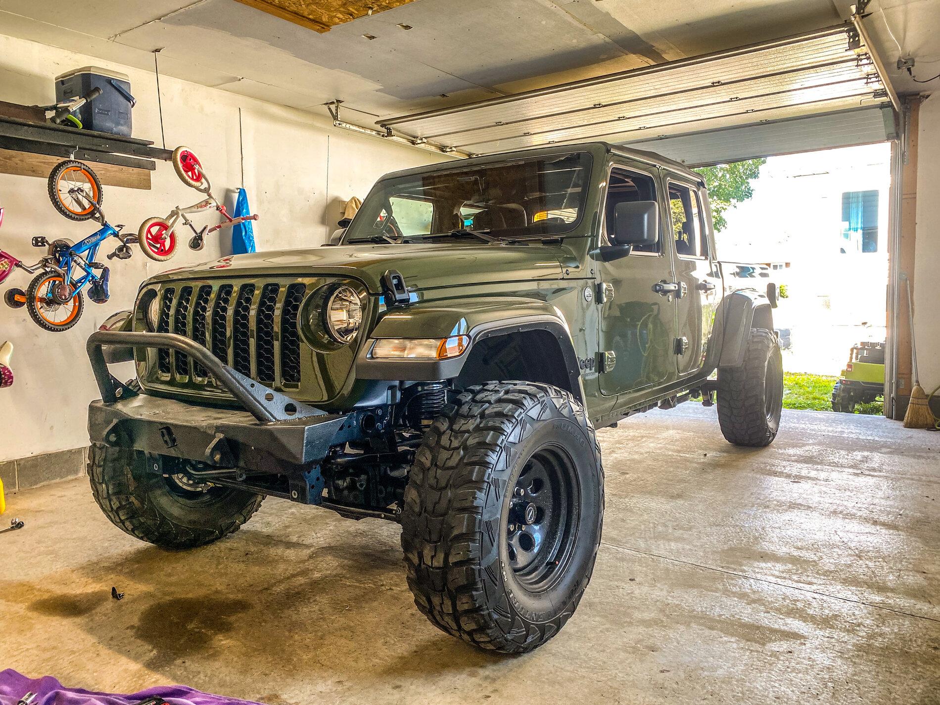

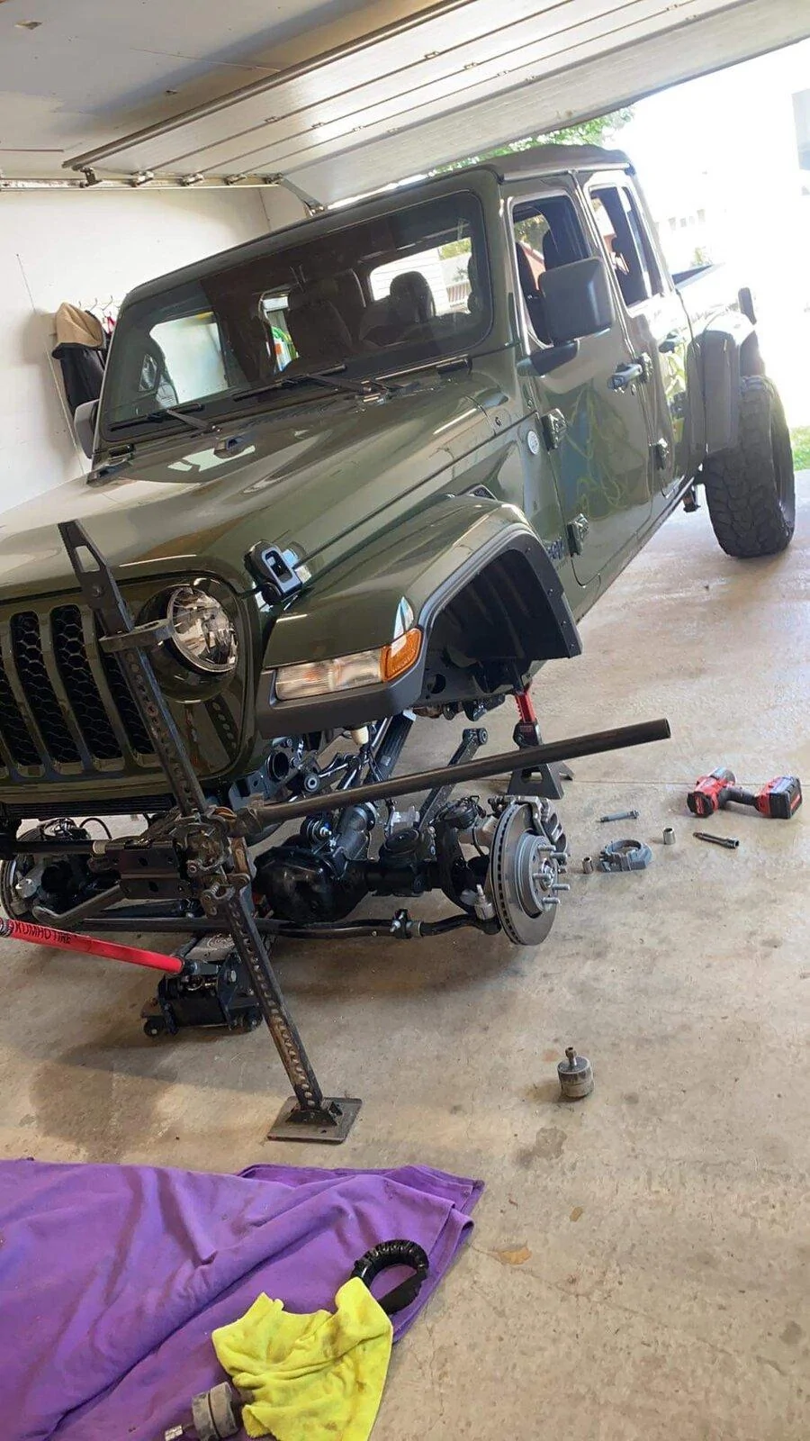

Finally got around to installing my lift, used most of my RK stuff from my JL
So much better, just need to get some new hardware to mount the 8274 up front
What front bumper are you using?

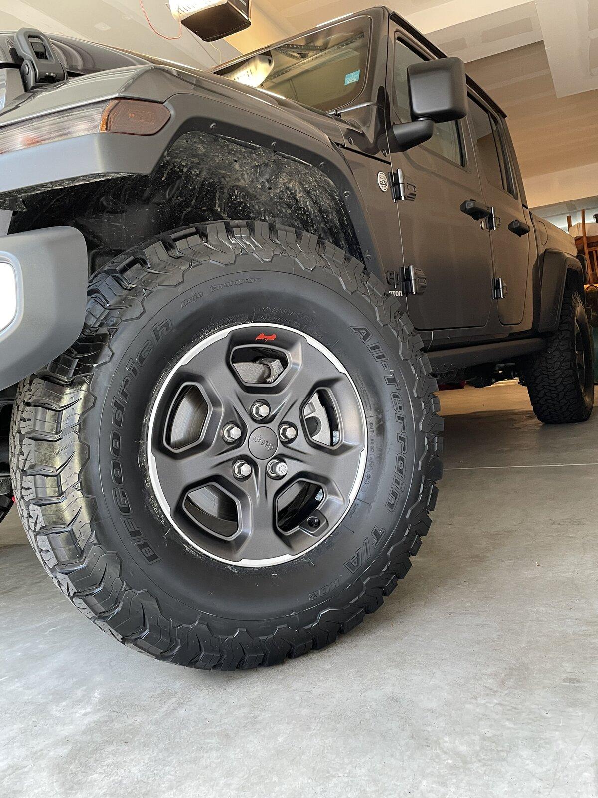

315/70/17 load C K02s mounted.
@Discount Tire your team in Aurora CO off of Havana is top notch. I’ve never seen a tire shop so busy.
Thank you for the shout out to your local CO Discount Tire store. Your JT looks awesome.
We appreciate your support.
