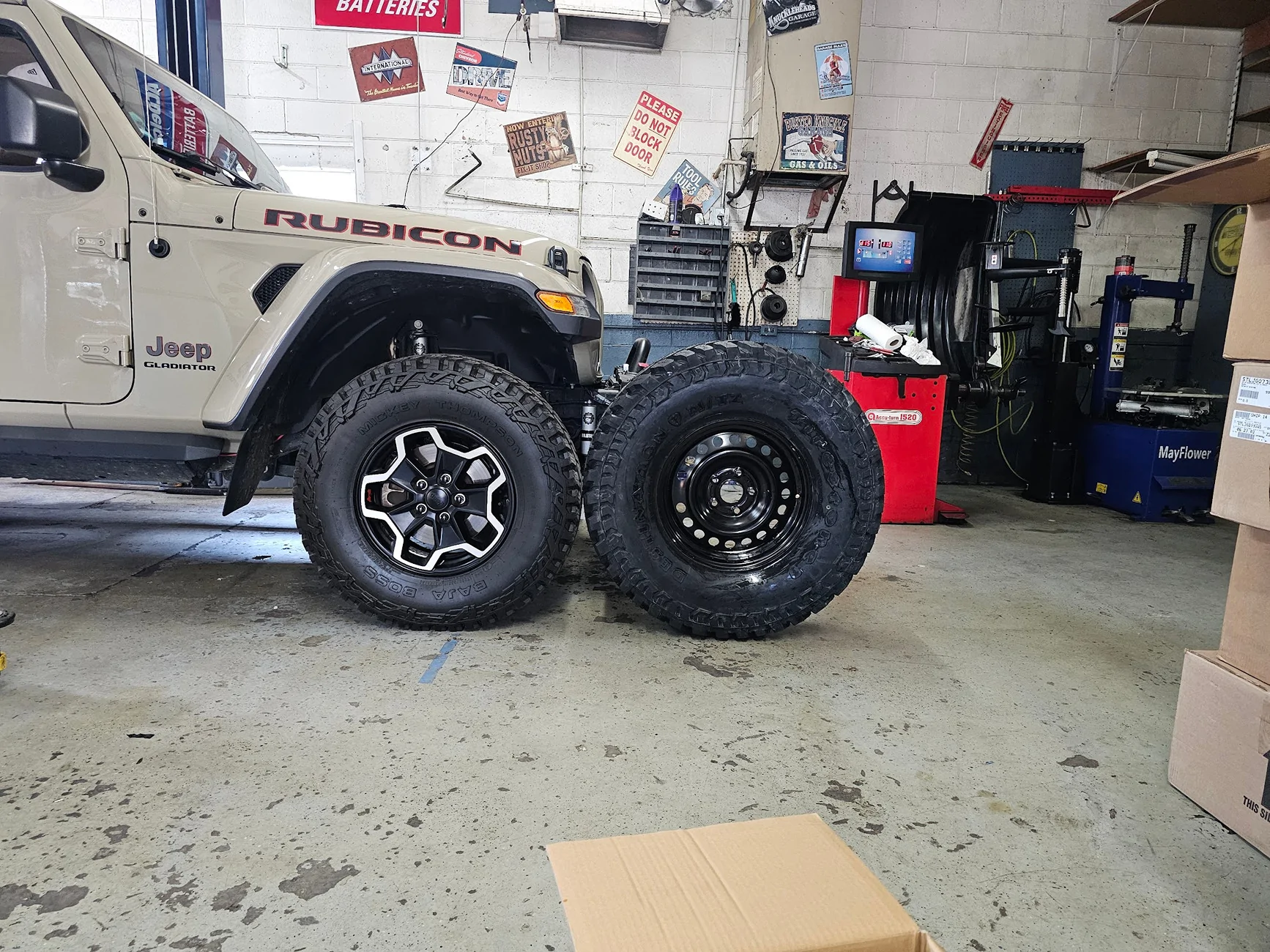

Hey Team,
Time to swap tires. 2021, Sport S, Tow Package, 4.10 gearing, 2.5" RE lift. Have a friend that is swapping his 37's for 40's. 37's (KO2's) are still fresh and shiny. For the sake of argument, If I were to strap the hand me down 37's on mine and NOT regear right now, what are the ramifications/consequences in your mind?
This is a money now money later argument.
Thoughts? and Many Thanks,
JP
