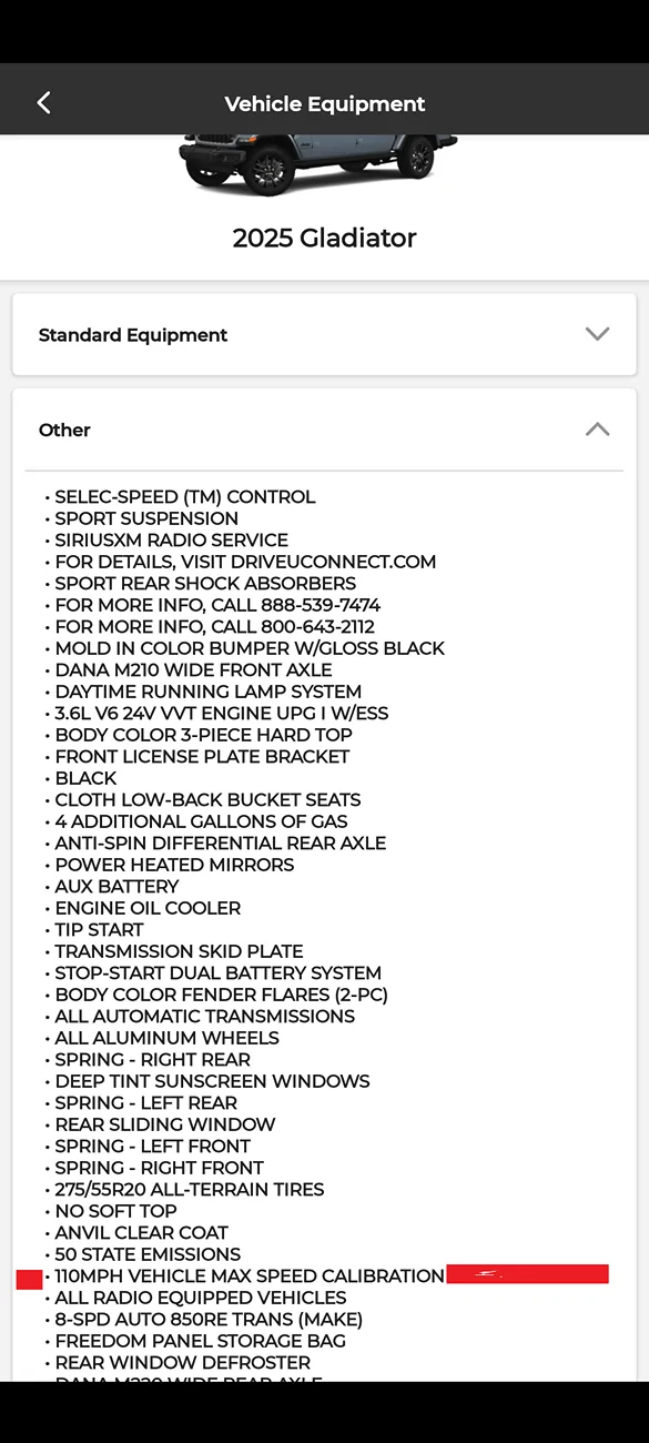

Not exactly what I was asking, that part I knew. The part I'm wondering about is max speed. My current max speed is 105. If I go up to 35's, at the same wheel RPM, I'd be going ~115.
When I say it like that, it seems like the real question is: Is the governor based on speed or RPM?
Yes, I know, Jeeps aren't supposed to be fast. Consider it an academic question.
But yes, I've had mine over 100.

It's speed based, so if you didn't recalibrate you could actually attain a higher top speed. Not sure it would be worth the drawbacks of the shifting being off? Ours are both governed at 100mph and the mojave sees that regularly in the dirt.

Most of the 2025's are limited to 95 (or is it 97?) but the Nighthawks get 105 because the larger rims mean less sidewall, so more rigid, so higher speed rating. If you tried to go 100 on 17" rims and 35" tires you'd probably be doing 115 because of how much the tires would expand, and you'd feel like you were floating!

109 for diesels 110mph for Gas but also varied by year model ranging from 97mph to 110mph on model top speed was 102mph with 2020 and 2024 and 2025 models being the slowest.
https://www.carhp.com/jeep/gladiator/0to60
you know what they say: always trust any info you find on the internet! (including my post!)
I was wrong. 2025 Nighthawk gets 110.
