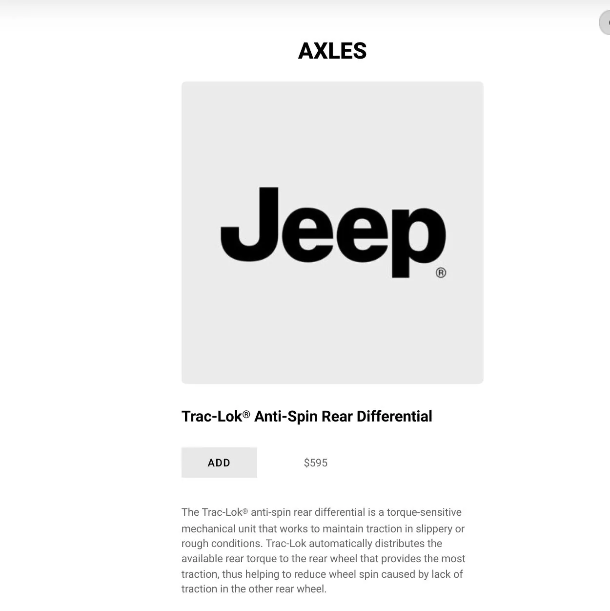

You can get the LSD on any Gladiator except Rubicon and Mojave. Where it's not standard, it's a $595 add on.
Jeep Gladiator Confirm what I have/don’t have Screenshot_20211201-234154_Firefox
40,505
54,031
You can gt the LSD on any Gladiator except Rubicon and Mojave. where it's not standard, it's a $595 add on.
It wasn't available in the Sport series in 2019 when I ordered, was in the Overland. A lot has changed in the last year or two.
