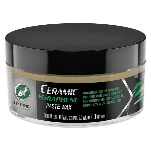

A little off topic, but have you guys tried this stuff?
Jeep Gladiator What is a good product to protect, etc. black fender flares 1638755507307
It makes the most bad-ass beads I've ever seen and it lasts for many, many months. TW did tell me not to use this one on plastic/rubber/decals, though. So I use their sprays on those but this on the paint. It's shine is killer, too. I put it on my red JL in March and it still beads like crazy. On the windshield it absolutely destroys Rain-X at shedding water and it doesn't seem to build up on wipers like Rain-X does.
I just put a coat on both my red and white JL's and it just looks amazing. Smells great, too, like all the TW products. I've done Jeeps 3x with a jar I bought in March and it looks like I've barely used any. One jar should go a looooong way. It wipes off easy, too, with now powder residue. Amazing stuff.

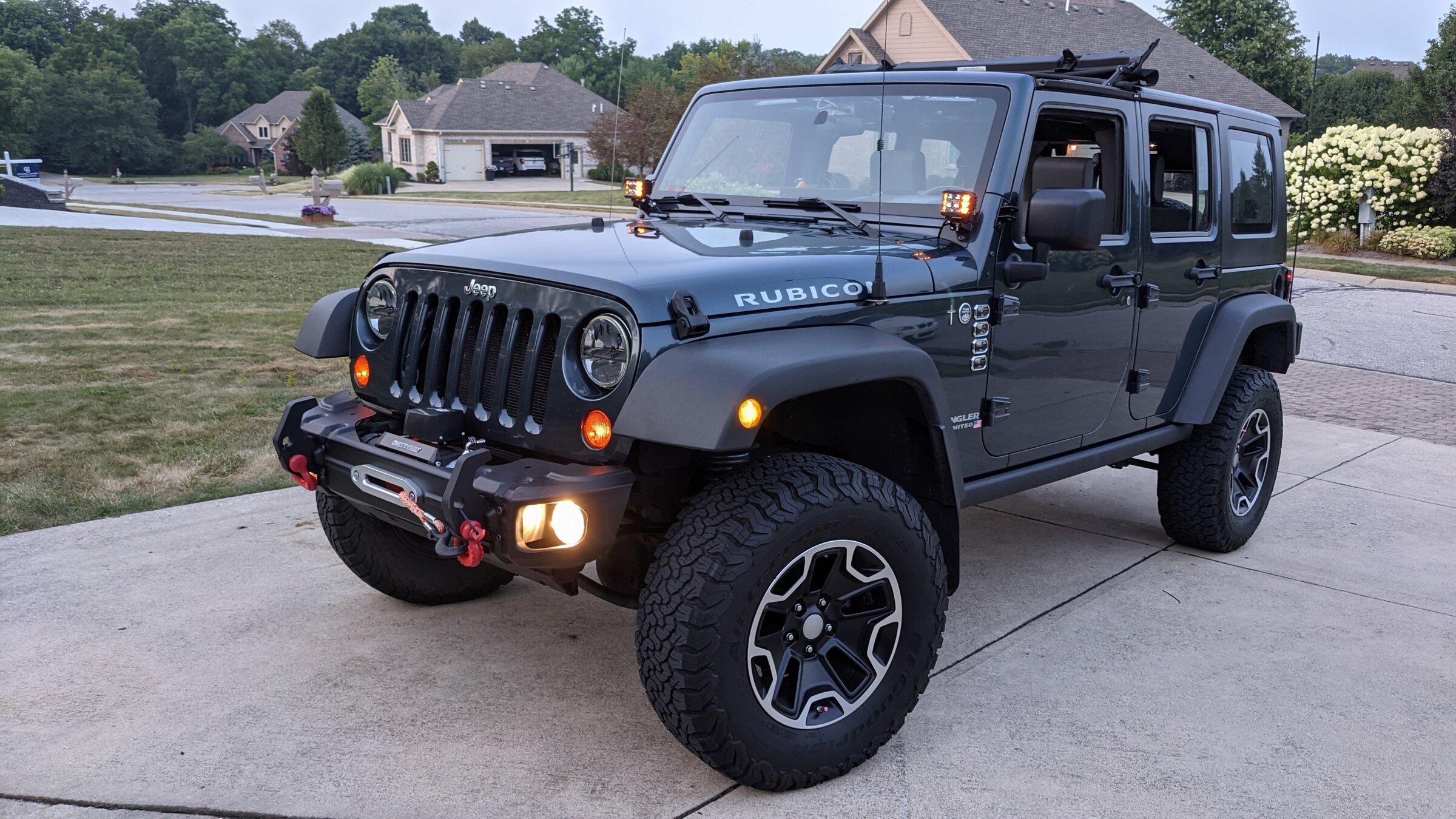

Here's the 14 year old JK after a wash and TW Seal N Shine.
Jeep Gladiator What is a good product to protect, etc. black fender flares PXL_20210809_003827461

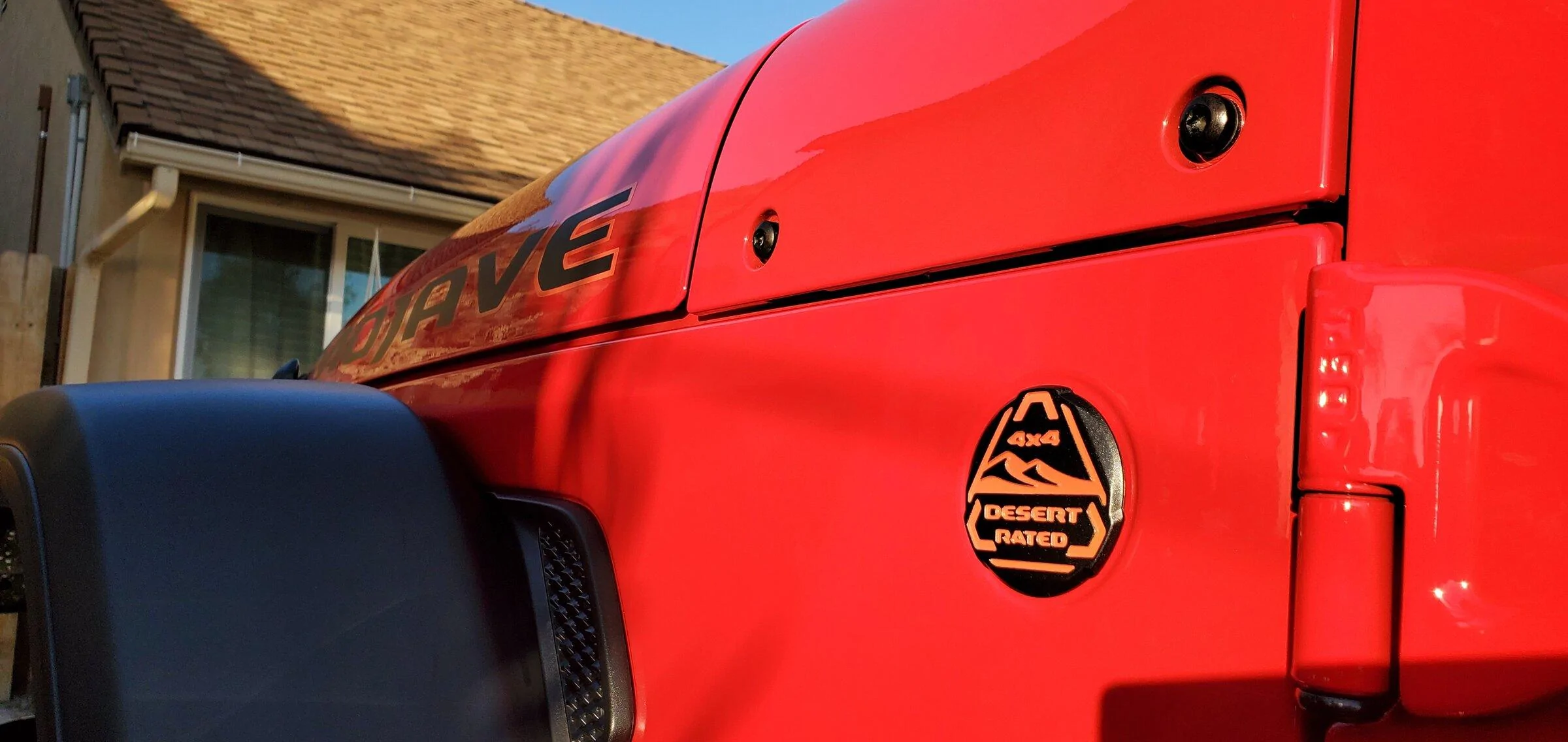

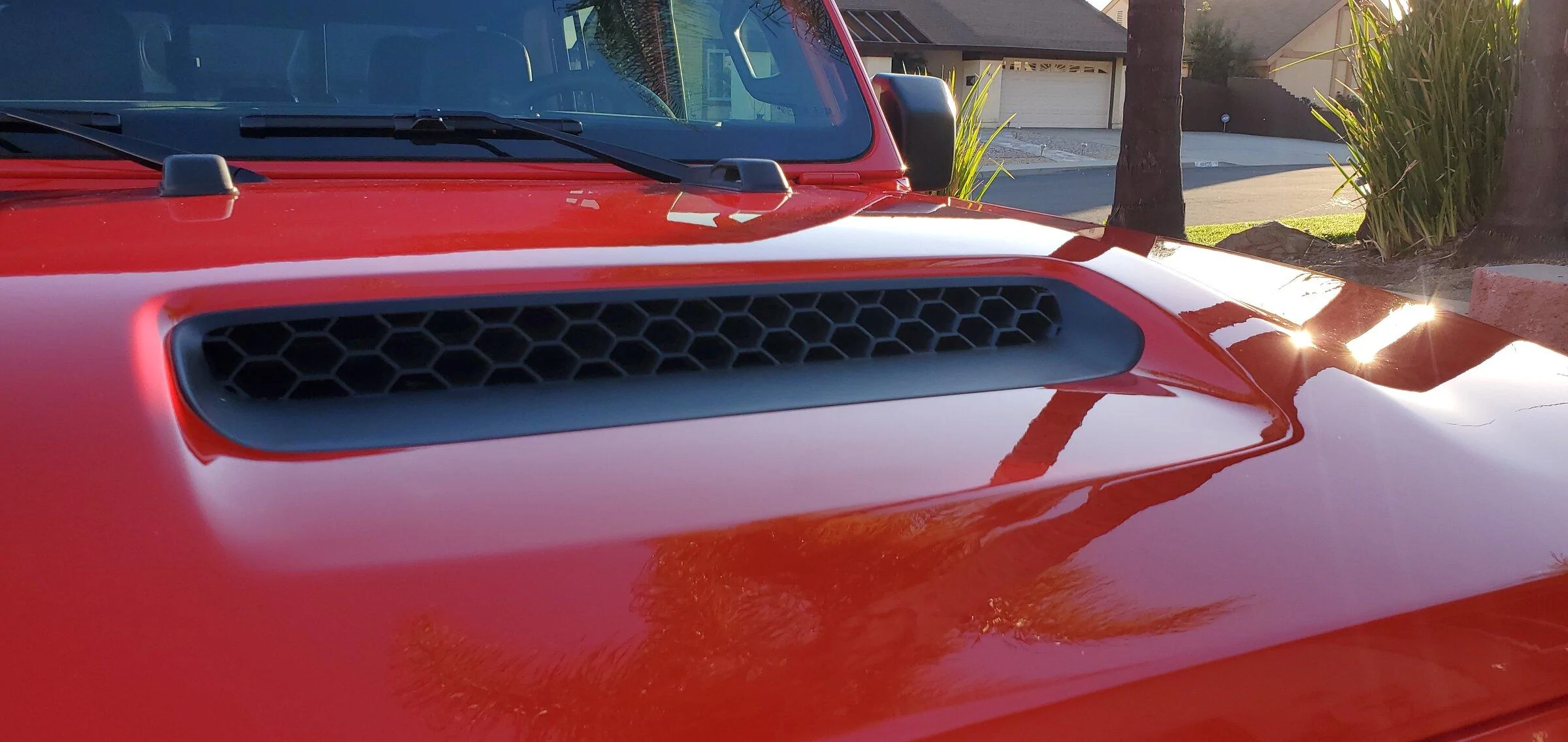

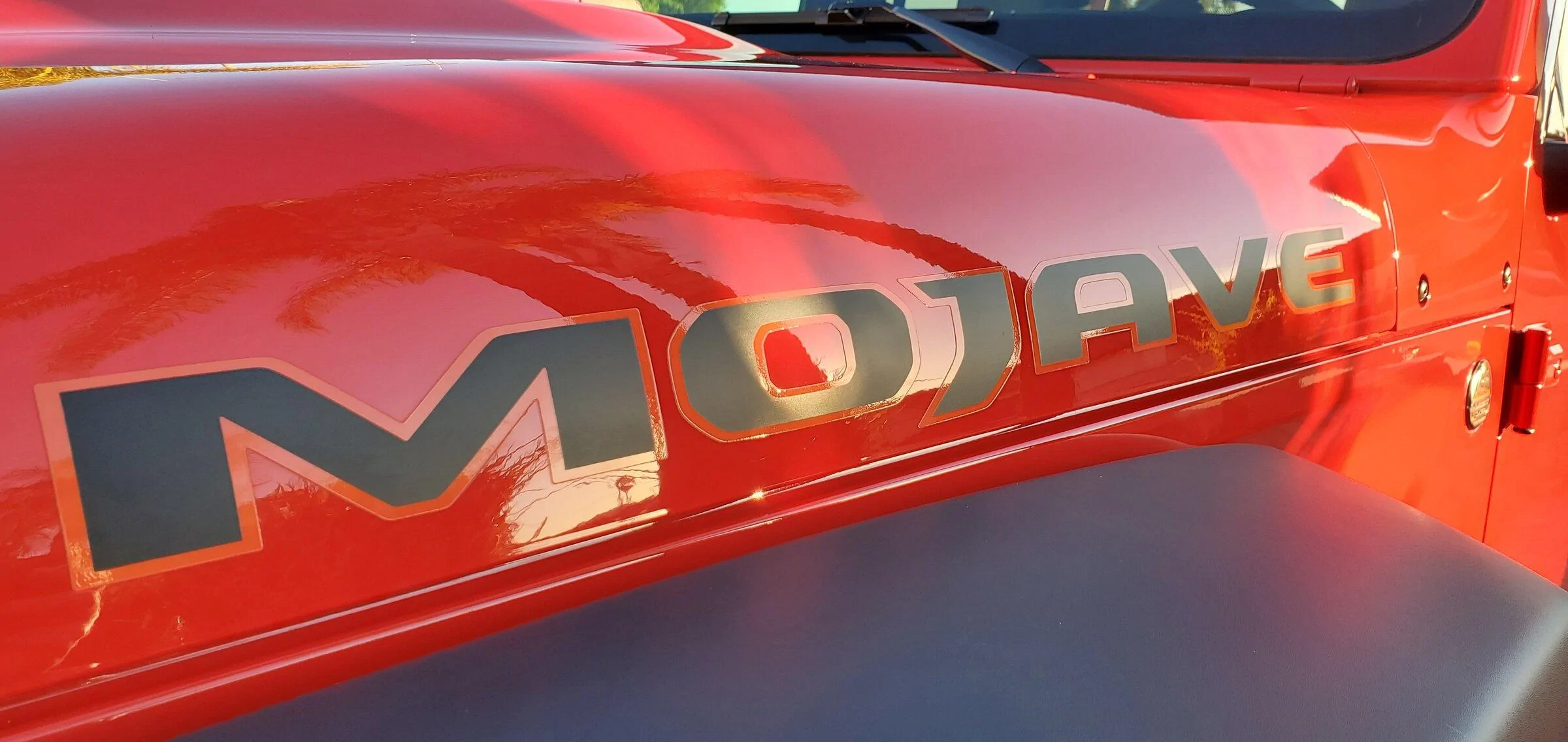

Haha long story. They have a bunch of products. I've been using the system for 20 years. ( Shelby GT500, various other cars...my wife's Acura MDX ) It is a lot of work but results and longevity will kill any other product. It's all numbers:
Z2 and Z5.... polishers...you use these and do successive layers. Accelerate curing with yet another product...ZFX. Dark colors Z5. Lighter colors Z2. The baseline you do is wash the truck with dawn dish soap. This dissolves and removes EVERYTHING. Then claybar the truck. Then do Z2 or Z5 mixed with ZFX. When done, quick detail with Z6 and do another Z2 or Z5 coat. Keep layering. After 2 or 3 coats....use Zaino CS which is clear seal and lock that paint down.
Z6 and Z8.... quick detailer and gloss enhancers. Use in between successive Z2/Z5 coats and after a wash.
Z7....car wash soap.
After reading what I typed....I want to say NO THANKS too. That said I've been using the system for 20 years like I said and results speak for themselves. New paint forever. I probably did a poor job explaining. Check out the site.
https://www.zainostore.com/mm5/merchant.mvc?Screen=beginners&Store_Code=Z
Cliff notes for what I did on my new truck:
Washed with Dawn soap and dried.
Claybarred using Z7 mixed with water as lube.
Washed with Z7 and dried.
Z5 mixed with ZFX to accelerate curing.
Wait 30, wipe down. Wipe down again with Z6 spray.
Do another Z5 mixed with ZFX coat.
Apply Zaino CS.
Done. However 5 hours have now passed.

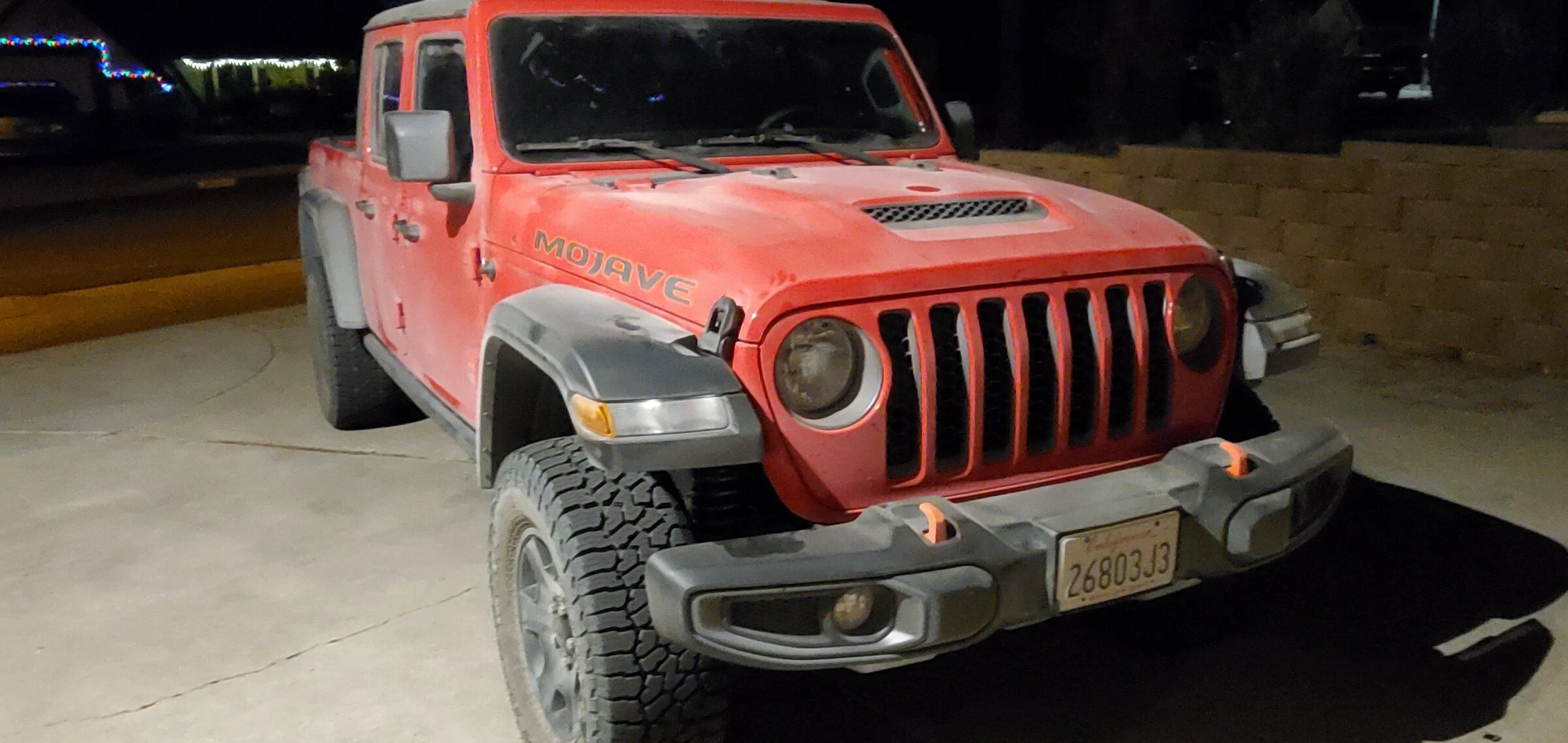

Sorry, I'm insane. That said I don't wash the truck when home from the dunes. Dirt is fine. I just wanted the massive paint lock underneath so my red won't fade. Once every 18 months I'll redo the sequence.
Post Zaino:
Jeep Gladiator What is a good product to protect, etc. black fender flares 20211121_154617
Jeep Gladiator What is a good product to protect, etc. black fender flares 20211121_154634
Jeep Gladiator What is a good product to protect, etc. black fender flares 20211121_154644
Post dunes:
Jeep Gladiator What is a good product to protect, etc. black fender flares 20211126_204237
