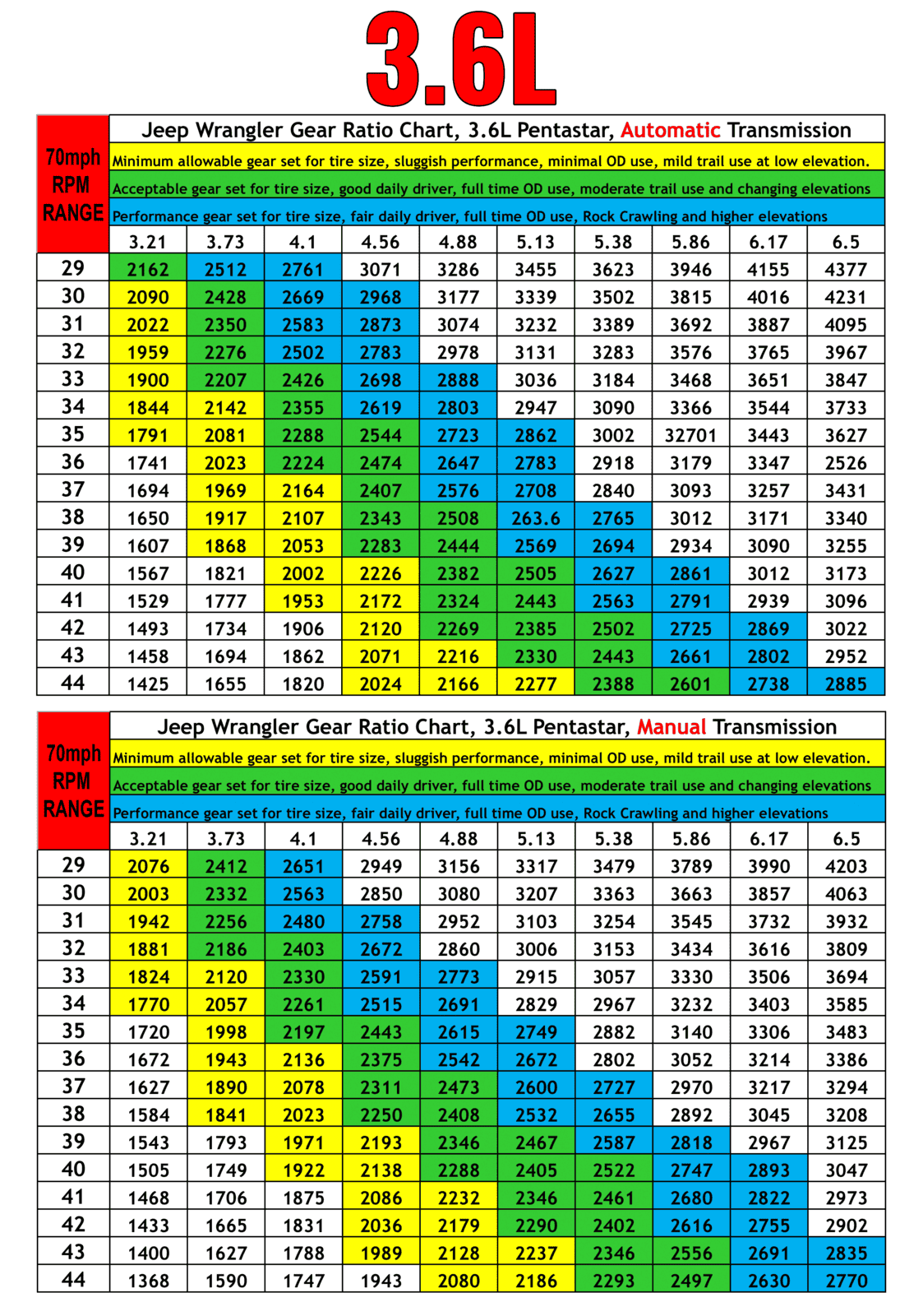

these are well done and should be helpful
Mine is a 6speed and I will be going 5.13. I am also in Colorado and drive at altitude.
