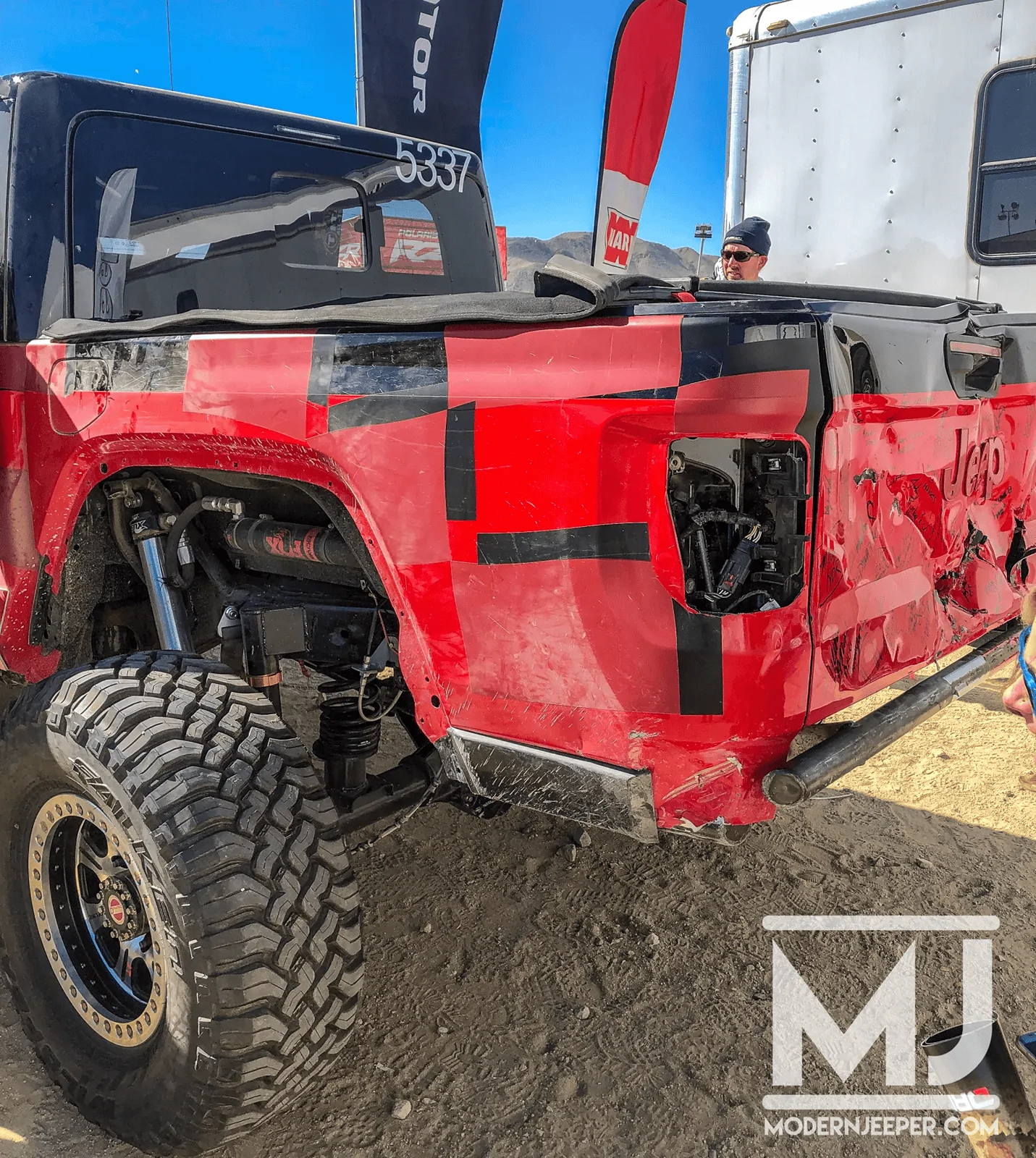

where are these trails in SoCal?
What are you in the mood for? Closest to you, and also a Jeep badge Trail, in Pinyon Canyon with the squeeze. The easier trails you'll find will be in Anza Borrego national Park, including truckhaven. Next up is the Big Bear trails: Dishpan, Holcomb Creek, Gold Mountain, John bull, Mottino Wash, etc. The big boy stuff is going to be Johnson Valley, home of King of the Hammers. There the easier trails are Big Johnson and Claw Hammer, stepping up to the real hammers trails. While a gladiator did finish KOH once, it wasn't pretty.
