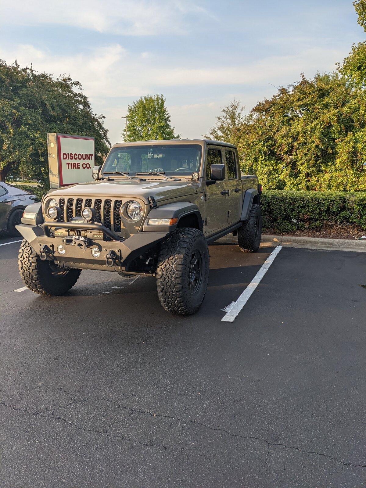

I can clear with my stock wheels and 37's without spacers. I put the Goodyear Kevlar MTR 37 12.5 17's on without my spacers and I had clearance at full lock side to side. I can't speak for 37 13.5 17's but I could run the 37 12.5 17 Kanati's i just had put on without spacers as well. I just prefer the wider stance. I got a Max Tow with the Wider Axles like the Rubi has. I still have my stock lower control arms on mine, and am lifted about 3-1/4 inches.

I got a Readylift 2.5 inch SST spacer lift and Rubicon front springs installed. It sits 2 inches in the rear and 3-1/4 in the front with the Rubicon front springs installed.
