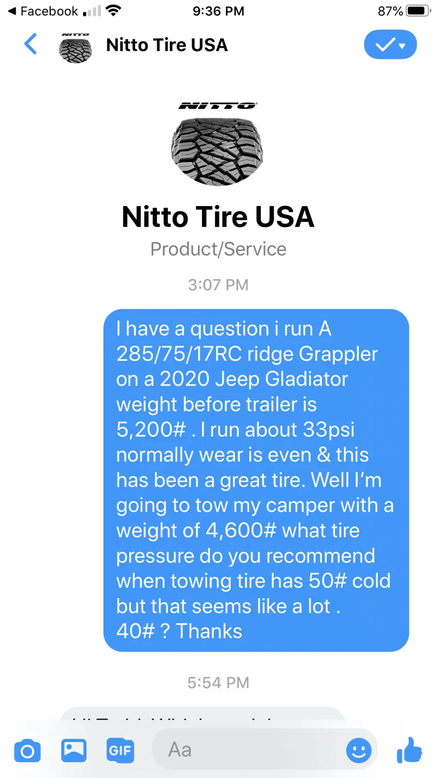

Ok so i have the optimal tire pressure on my rig unloaded just every day driver. But when towing my camper i have to air up more obviously. My tire says max 50 psi i run 30 to 32 normally unloaded. Jeep door says 37psi . I’m thinking run 40psi . 4,600# camper with 285/75/r17C ridge grapplers . What do y’all think i haven’t towed this camper yet with my Gladiator

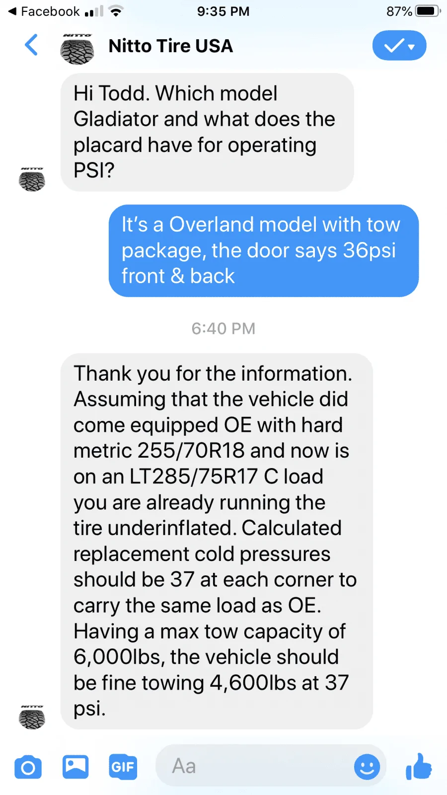

So I’m gonna go camping this weekend & towing my camper finally. I reached out to Nitto & they asked a lot about my Jeep factory specs weight tow rates door pressure & for the 285/75/17c ridge grapplers, he recommends 37# all the time. Towing or not.
