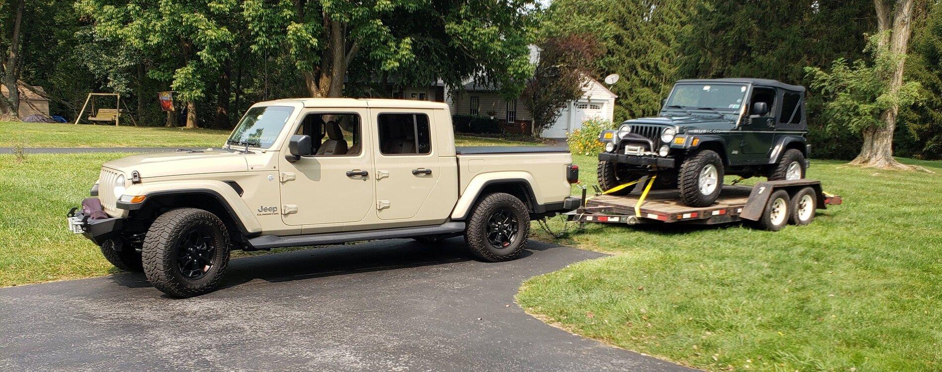

Trailer loaded - 5600. Tongue weight at 10% - 560. That's over half your payload.
Assuming you have nothing else in the truck with you and nothing in the back, how does it sit - or do you use a WDH with your car hauler?
I set about 500 - 550 pounds of block on one of those receiver mounted carriers and the back of mine squatted like a dog crapping in the yard. (thus my change to max tow springs in the rear - squat solved)
When I used my car hauler to go pick up some old dealership signs - 1600 pounds trailer and load - my truck couldn't get out of its own way on I80 west of Des Moines. Yeah, I was trying to keep up the speed limit, 70-75 but I was shocked at how it struggled and the transmission hunted so badly all the way home.
I keep seeing folks talk of how well their Overland did and wonder what the hell is wrong with mine?
Handling was great, stopping was great, but the transmission shifted literally 2 or 3 times a minute and it felt like the brakes were on.
It sits a little squat but not bad at all. No WDH, with a car hauler moving the car can distribute the weight. I don't get manic about payload numbers it's usually just my son and I and some camping equipment. Pic below. Like you mentioned, handling and stopping are great.

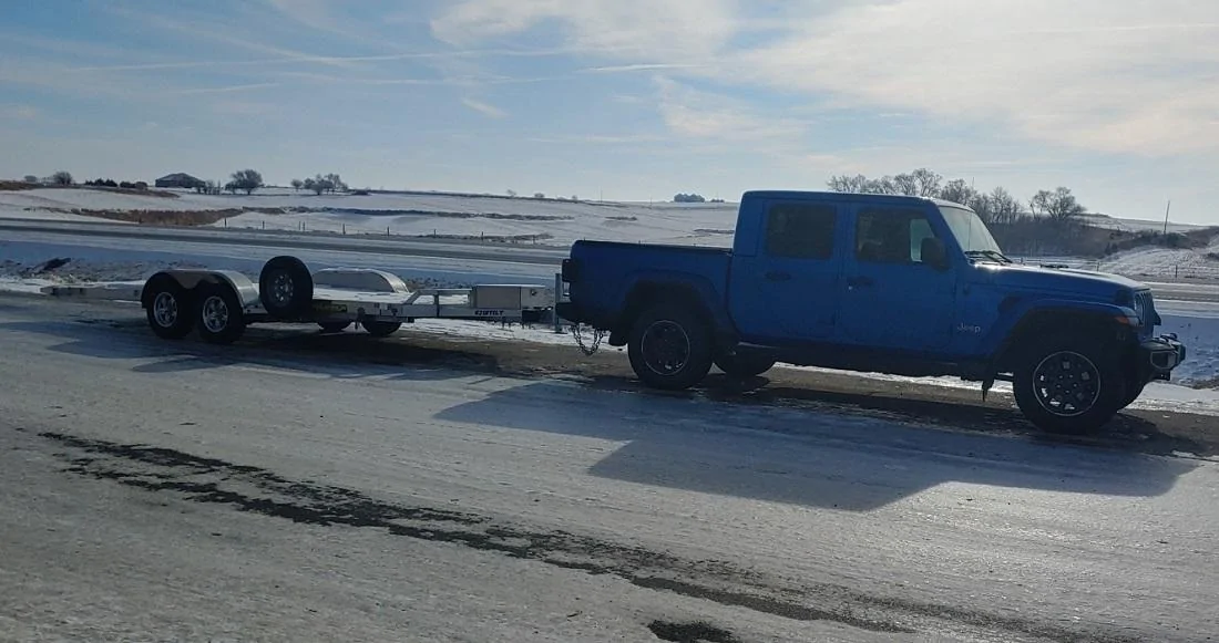

On my only towing outing so far -
Everything was flat as far as the load - the trailer sits low and was unloaded going TO Omaha to pick up the signs.
Here's my empty trailer going to Omaha - trailer is 1500 pounds empty, I figure 1600 with the spare tire and aluminum tool box.

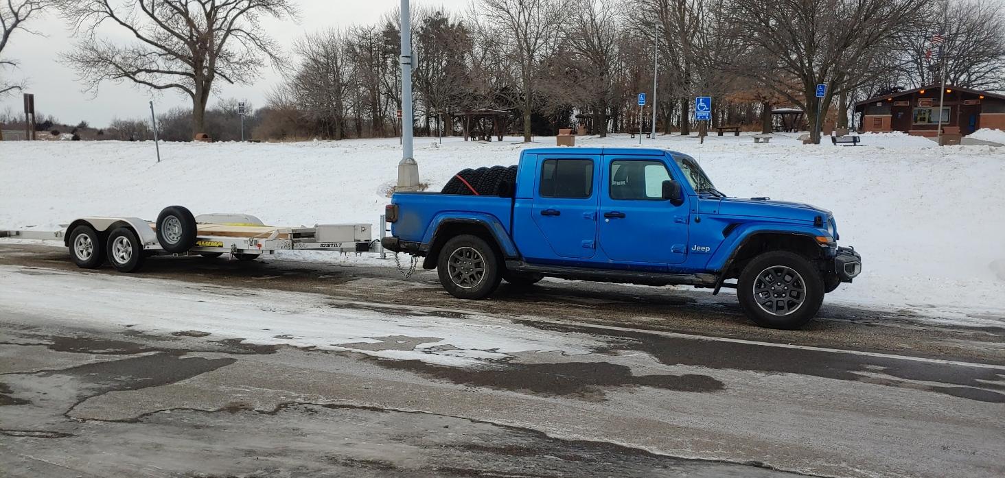

Here's what I was towing coming back - the signs are light - I can carry each one without trouble. They laid flat with 1/4" plywood strapped over them to keep the wind from whipping them to pieces. Plastic dealer signs in aluminum frames. They sit lower than the tool box on the trailer.

That's weird. You shouldn't have any issues at all towing that. Like it's not back there. I have a 1000# utility trailer and with a 400# mower I could barely feel it.
40,503
54,023
My thoughts exactly. But between the transmission hunting and my having to really lean on the throttle to keep it up to speed, especially on hills - it was like towing a heavy load except it didn't feel like a heavy load. As far as "feeling it" - yeah, I knew it was back there, but not really. My Chevy towed that thing like it was not even back there. In fact, I'd keep looking in the mirrors to be sure it hadn't dropped off somehow. This truck felt it, but the biggest thing was how it acted like there was several thousands pounds back there.
I'll find out more in the first week of September when I haul my car into IL on that trailer.
It's been flashed since that tow, it's got a whole lot more miles on it (18,000 vs what was probably a couple thousand when I towed it empty) and I now have a brake controller in the truck.
