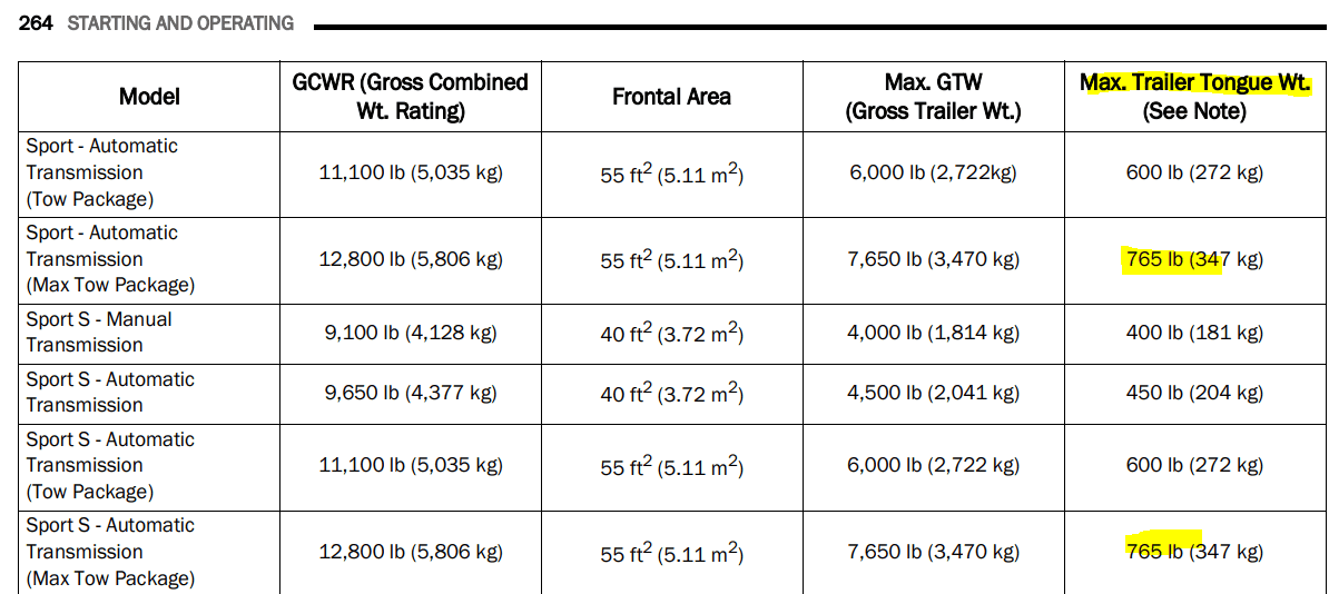

The hitches used are only rated up to something like 765 pounds or so. The class used should be much more, but if you look up the hitch and then look up the specs, these hitches are rated lower than others in their class.
I can't find the link I had last month, but a couple of the MOPAR places selling these receivers also listed maximum tongue weight of 765. It was in the published specs for the receiver. Apparently they are either not using a true IV or they are stating that because that's all the truck will handle where these are mounted. Doesn't matter what the receiver will do if the truck won't. Weakest link.
Compared to the Curt receiver I put on my little SX4, the mounting points on these are weak.
Thats scary if thats true. The mopar site listed some forum member's JTs tow ratings at 8k and up at one point. How could they calculate that if the hitch maxes out so low? Also it seems kind of unsafe for them to market even what they do if that is the hitch max. Especially things like travel trailers that tend to be hitch heavy

The mopar site was full of bovine excrement. Piggy poo, whatever. It was waaay out there. JeepCares even looked into it and it was quickly modified and that part was removed.
Check the hitch or tongue weight max in the owner manual - if you buy one of the MOPAR hitches - the EXACT same part number as our trucks have on them, some of them state that max tongue weight.
Tongue weight is also "way back there" compared to anything else you'd put in the truck -people, a load of sand for the kids, landscape block, etc. - so there's a heck of a lot of leverage that weight back there has. Putting 800 pounds on the ball mount is a lot different than 800 pounds over the axles.

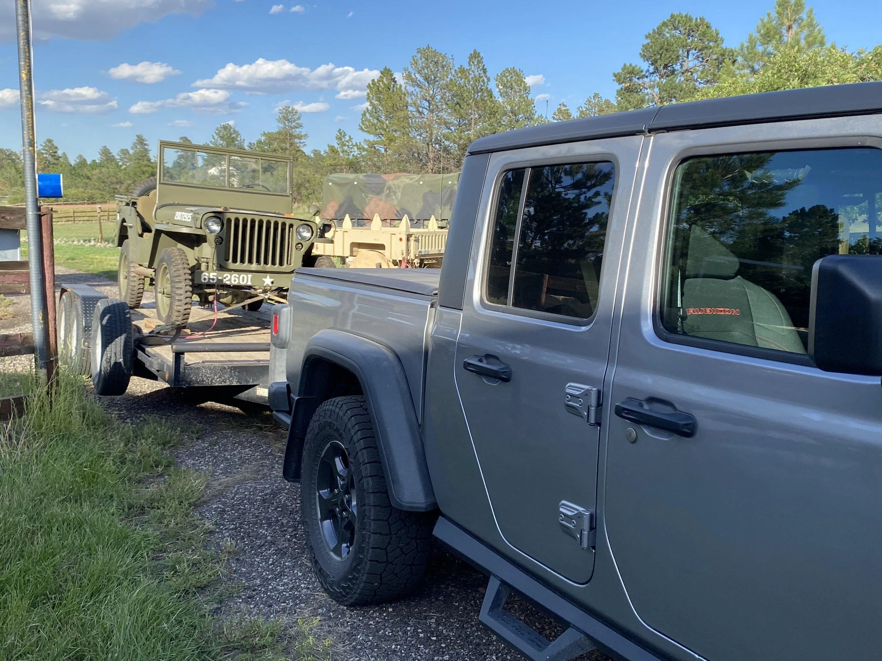

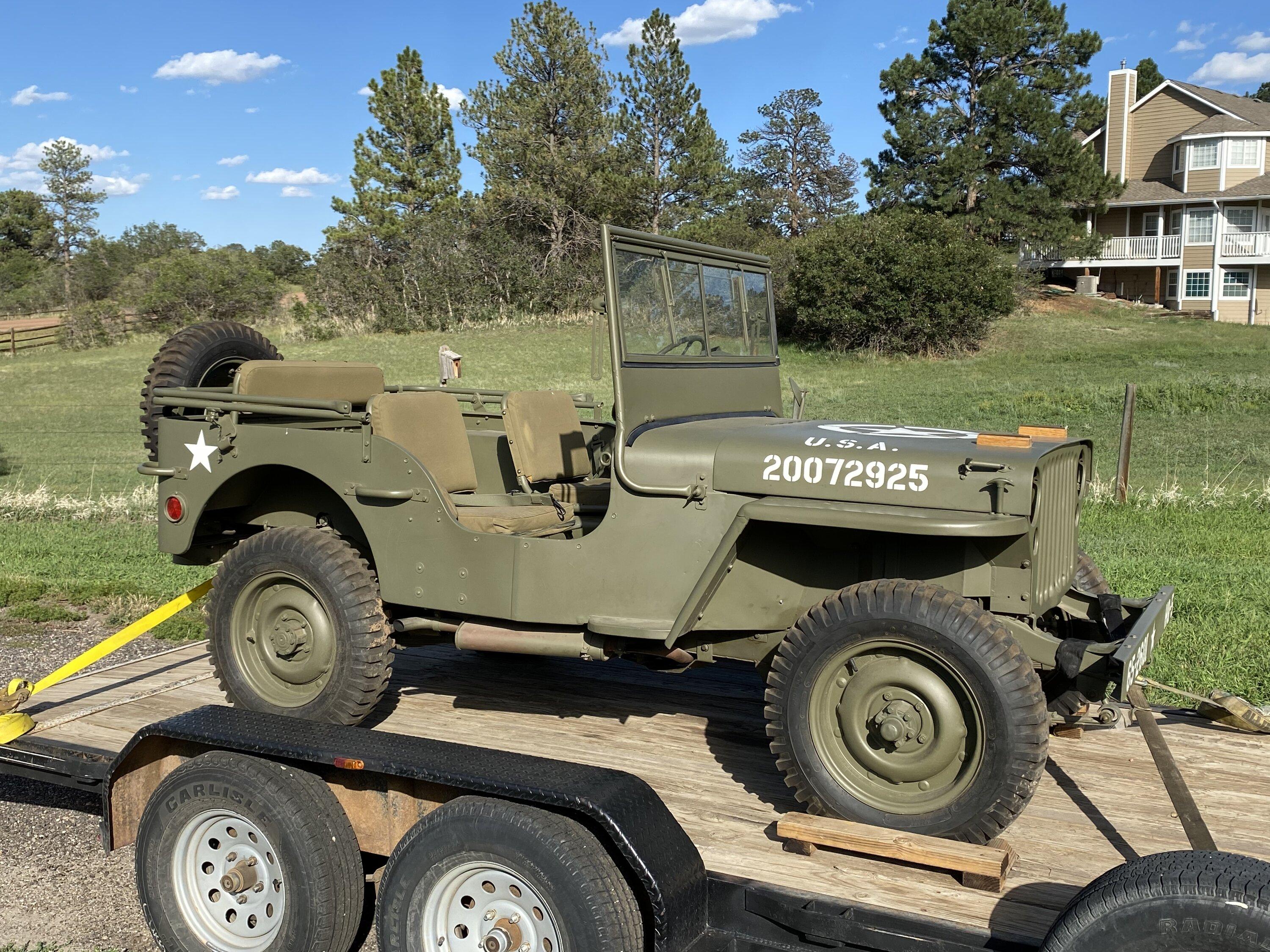

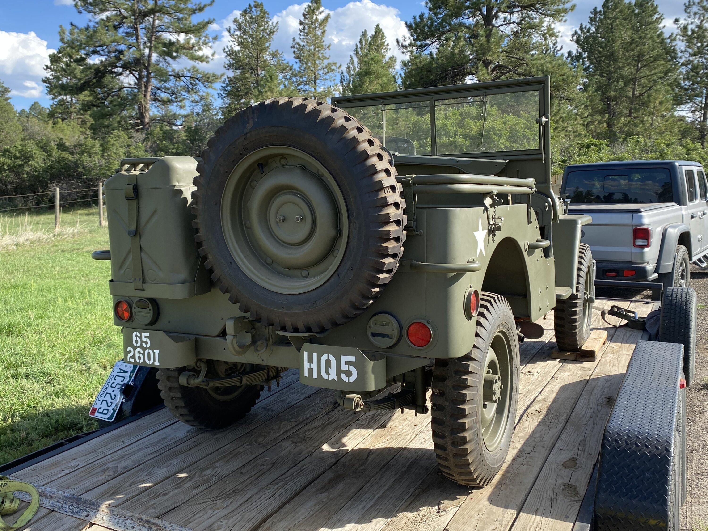

4000lbs total. Funny that the Jeep and trailer weight are within a few pounds of each other. 450 measured at hitch. Played with the chock placement on the trailer to get that hitch weight. At 65 tows like a dream. No WDH. Brakes both trailer axles. That’s a 1944 Willys MB on the trailer.

The trucks with tow package all have the same hitch, so it's actually just 10% of the tow rating. Has nothing to do with the hitch itself, but that they want 10% of the trailer weight on the tongue at max weight. You'll need a WD hitch to achieve this properly, and weigh on scales to verify. To wit, I have a 25' airstream, 5600lbs. Should be no problem with 7000lb tow rating except the tongue weight is 860lbs. So I have to use 1000lb bars and tension them properly to get the weight distributed evenly, leaves me with about 600lbs on the truck axles and at 1150lbs payload, capacity of around 500lbs in the truck and I have to make sure I don't load a bunch of cargo in the front of the trailer. Tows perfectly though.

You are still exceeding the tongue weight limit, then.
If a truck is limited to 765 pound tongue weight, then your tongue should not weigh over 765 pounds no matter what. It's a myth that a WDH "reduces tongue weight".

WDH does not reduce tongue weight - so if that thing it limited to 765, you can't tow with a 900 pound tongue weight just because it's a WDH.
