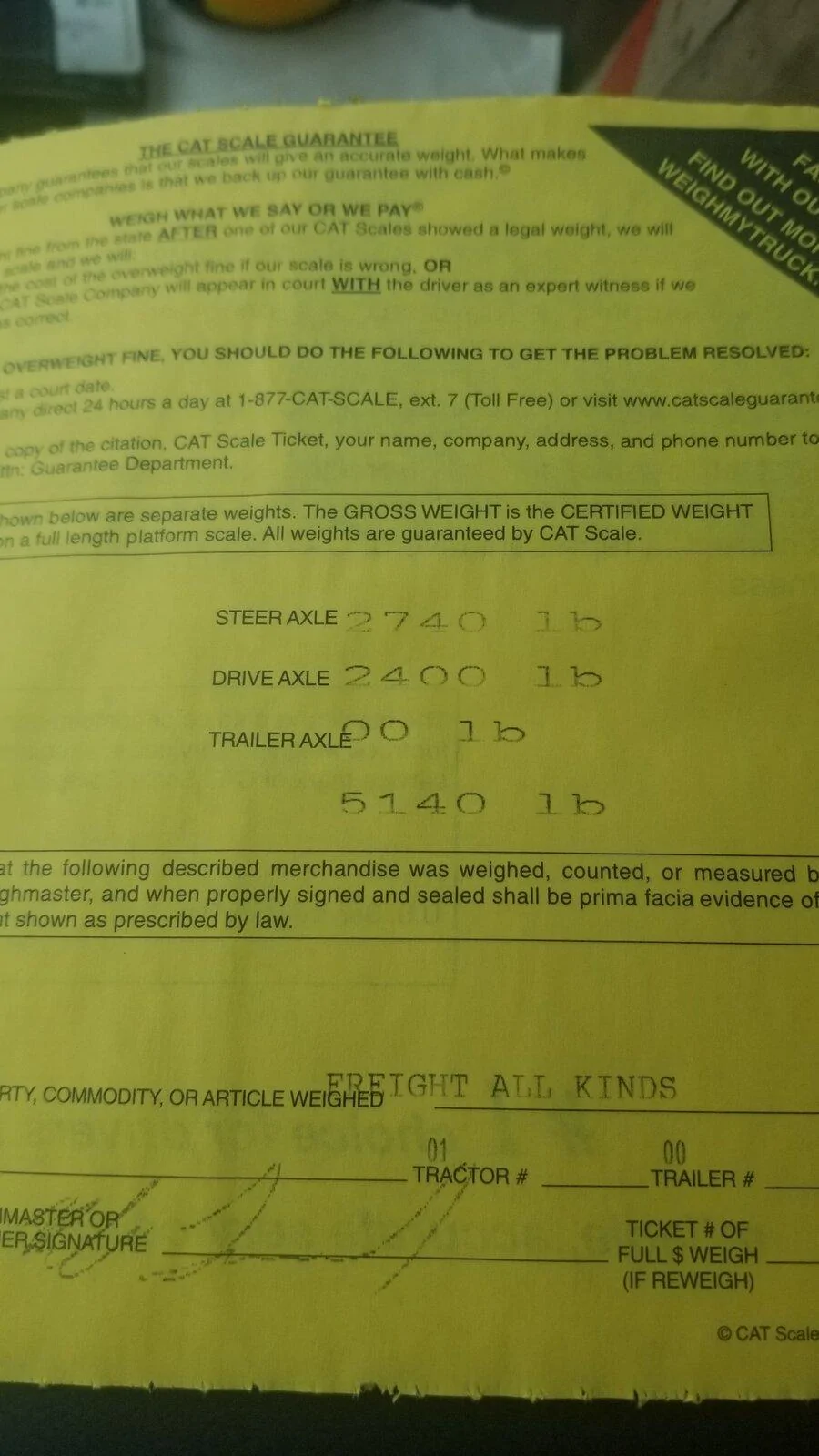

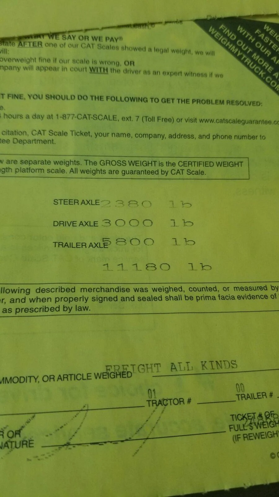

You are still exceeding the tongue weight limit, then.

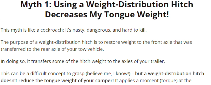

If a truck is limited to 765 pound tongue weight, then your tongue should not weigh over 765 pounds no matter what. It's a myth that a WDH "reduces tongue weight".
WDH does not reduce tongue weight - so if that thing it limited to 765, you can't tow with a 900 pound tongue weight just because it's a WDH.
It reduces weight on the truck, which is what the spec is meant for. As is obvious, jeep is just quoting 10% of the max trailer weight for tongue weight and do not quote a WD hitch limit. A properly set up equilized hitch will put 1/3 of the tongue weight on the trailer axles and front and rear axle of the truck, respectively. So all of the weight hits the hitch, yes (and all 5600lbs of the trailer weight pushes and pulls in it while actually driving, not just the tongue weight), but will keep all axle and other weight ratings in line. Unless you think there's something magic on the max tow that lets it handle 765lbs tongue weight vs. 700lbs on the Rubicon, even though they have identical hitches, axles and frame. Jeep is just quoting 10% of the max rating.
Besides, I can lower my tongue height and get the actual tongue weight down to 600lbs, but that will make it tow worse and be harder on the truck and trailer, not easier.
