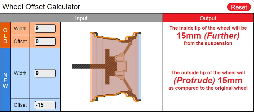

I've been using the handy tool on https://tiresize.com/wheel-offset-calculator/ and have a question. When you change the offset coverter tab and plug in a say 9" wide wheel vs the stock 7.5" and set the offest to say -6 vs the stock 44, does it fsctor that in when you go back to the offset calculator tab?
I'm looking at some procomp 17" x 9" wide in a -6mm offset which would be around 4.7(?)ish backspacing and want to make sure what Im looking at is correct. Thinking I could use them for the current 285 70 17 BFG's I already have then eventually maybe go to a 315 70 17 one day with them. But not sure how that calculator works for sure either other than the obvious on the 1 tab

Is there any benefit of going with the -15 offset?
I get the more it wil stick out of the fender etc but other than that? Any other issues with travel or rubbing over the other? Driveability or steering radius?
Discount Tire
Feb 3, 2020
891
862
Arizona, USA
discountti.re
All Things JEEP
Tire & Wheel Specialists
@The Yeti not a considerable difference. I guess it just comes down to what is readily available and whether or not you want a wider stance. Increased turning radius and lower center of gravity.
Jeep Gladiator Wheels specs and fitament 1699047606588
It may be the difference between squeezing through a narrow gap or not. :like:

Good point. Im not worried about rock crawling through a narrow gap or anything main issue on width would be scratching the body on bush on a skinny trail but most off roading and wheeling would be in the snow for me, on a back road or unmaintained trail or making my own trail on a road everyone stops going down when the snow starts piling up. Now I'm going back and forth between 9" wide wheel vs 8.5" wide wheel both with 0 offest (or the 9" comes in -15 too) between the 0 offest wheels I can save $200 on a set if I go with the 8.5" (but $200 now is better spent than selling a buying again later) so just thinking on that now. Im not against woder track width, but taller skinny is what I assume might be best for me(?). Also I like the look of the 35 x 12.5 but honestly the bigger heavier just for the look probably isn't my smartest ootion for a daily driver (other than for looks) thinking maybe in the future a 295 70 17 (or 75 if I could find it) would make the most sense for real world use vs looks compromise and might honestly be the most functional too. Where do I go to use that tire size calc you screenshotted. I've been using another one and Im not sure how it changes or if it even does, factor in rim width
