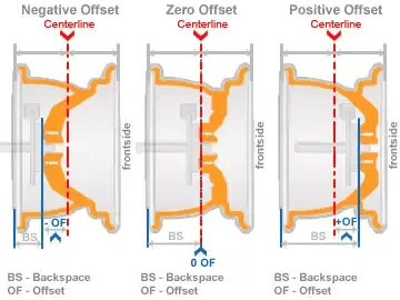

It's the width of the wheel, so mine are 17x8.5, which are probably closer to what you would want/need. I think the minimum width for a 35 may be 7.5" depending on tire manufacturer specs.
Backspacing/Offset have to do with where the hub is in relation to the centerline of the wheel.
In the diagram below they label backspacing (BS) and offset (OF) to show examples of positive/negative offset and amounts of backspacing.

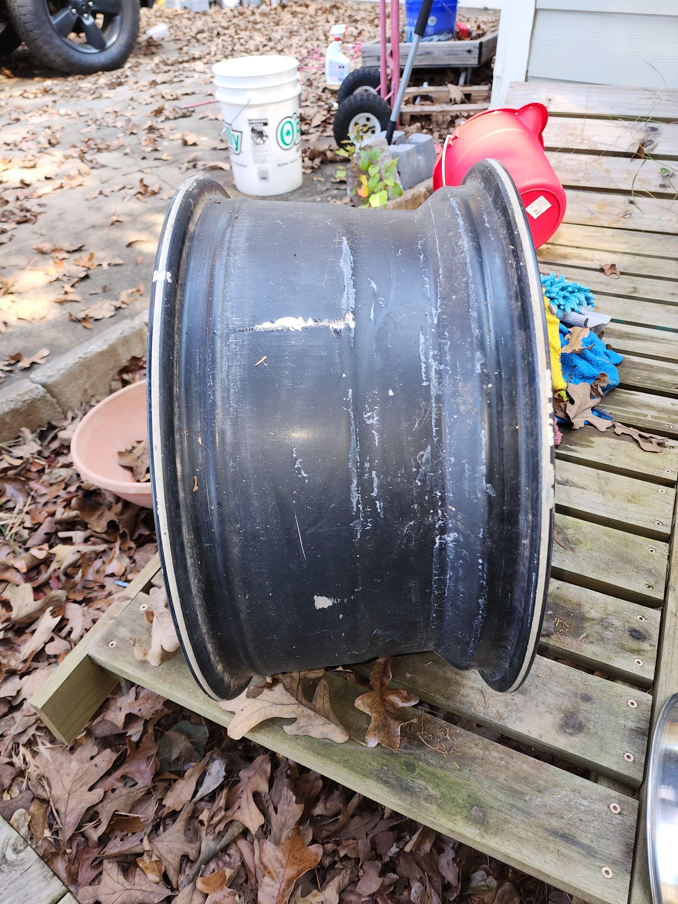

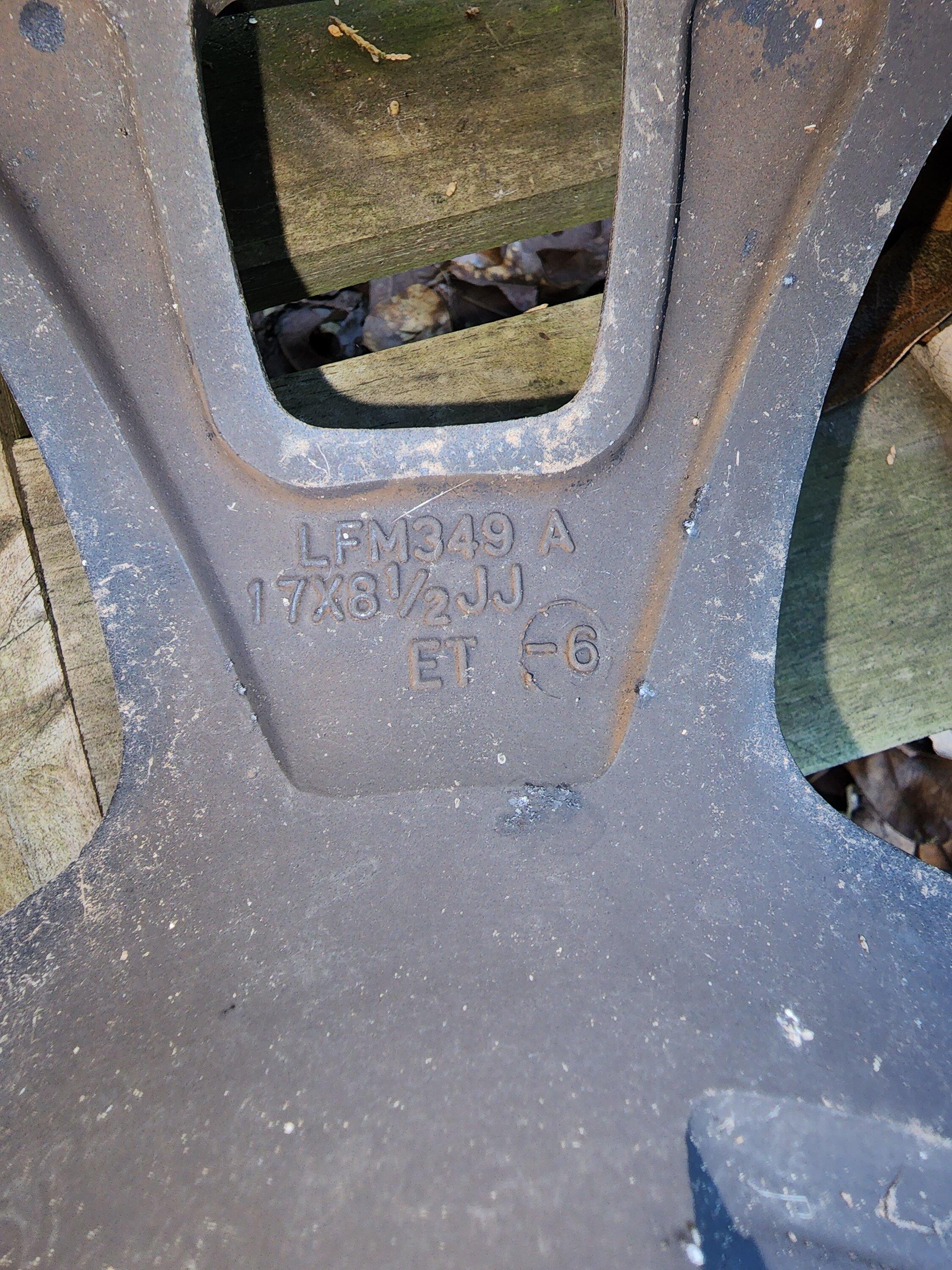

Can you post a pic of the stamping you see?
They are likely 6" backspacing and 7" or 7.5" wide. I don't think Jeep put a 6" wide wheel on Commanders.
Bolt pattern is 5 on 5, so you're good there.
Do you still have tires on the wheels, or can you measure between the bead mounting surfaces to get the wheel width?

Those are 17x8.5 with an offset of -6, or a 4.5" backspace.

@AHenry014 is correct, 17x8.5 with -6mm offset and 4.5" backspacing.
I thought you had stock Commander wheels, but you never said that.
You'll have plenty of room for 12.50 wide tires with these wheels. The tires will stick out 2-3" past the flares.

Sorry for not being clear on the wheels not being stock. Thanks for the help...now to clean them up and but some rubber on them.
