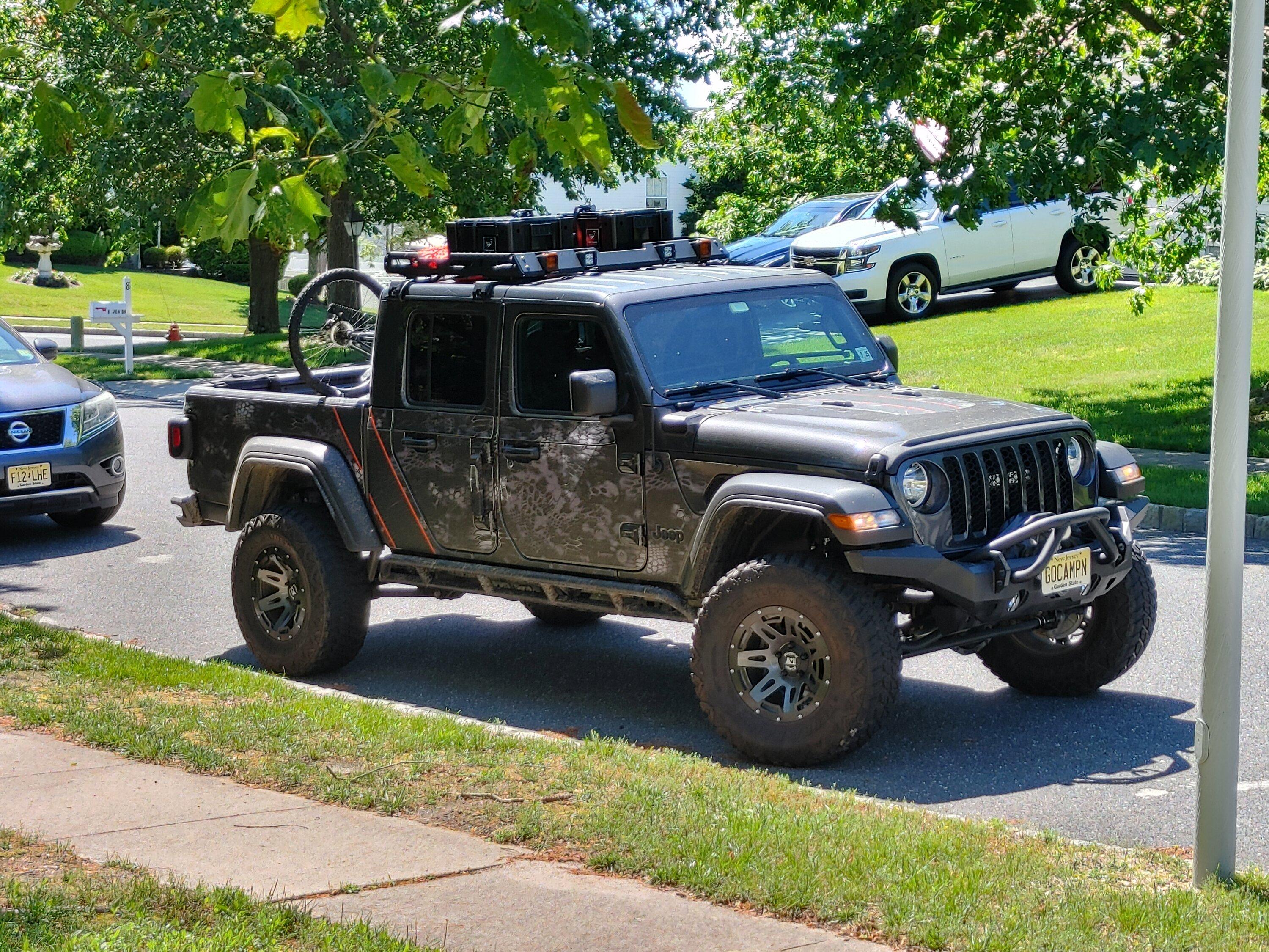

Correct, I have the HD on my JT. I only wanted full width to protect the fenders. I had the XHD on my JK with all 3 different end caps, was a cool idea but I ended up running the mid-width full time and never touched the others. I don't believe they ever released an XHD for the JT, closest modular option would be their Venator or whatever.

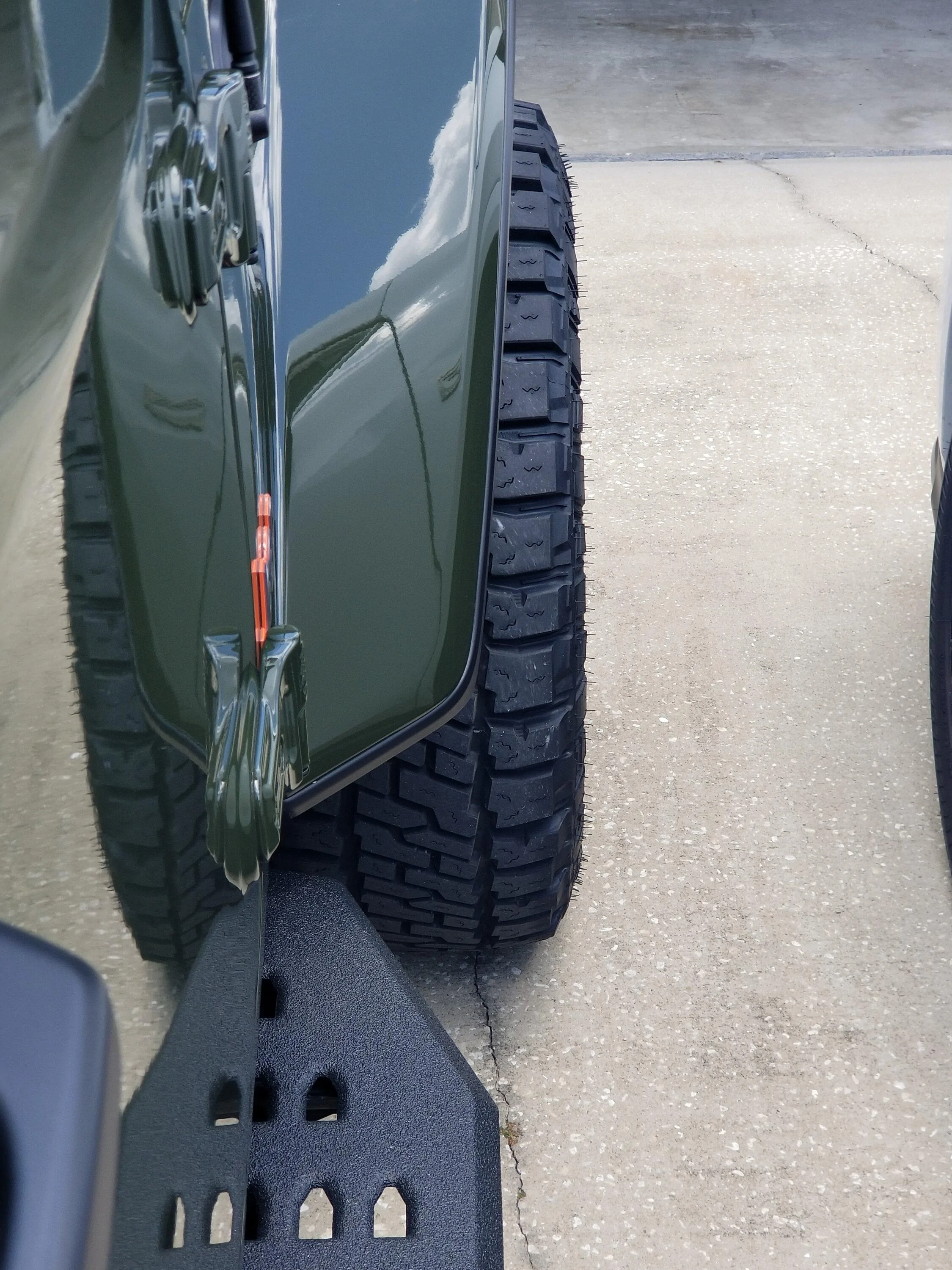

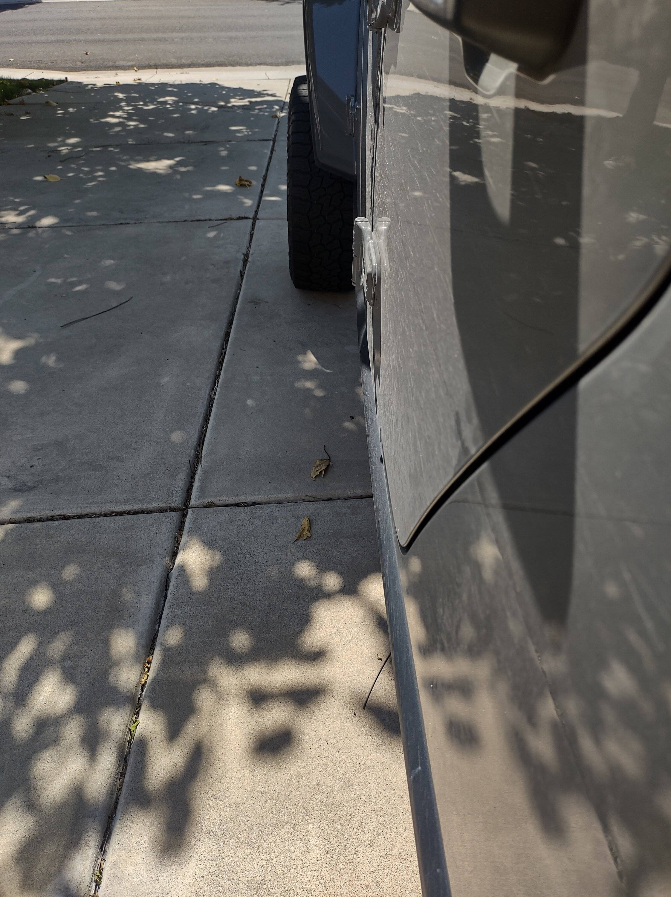

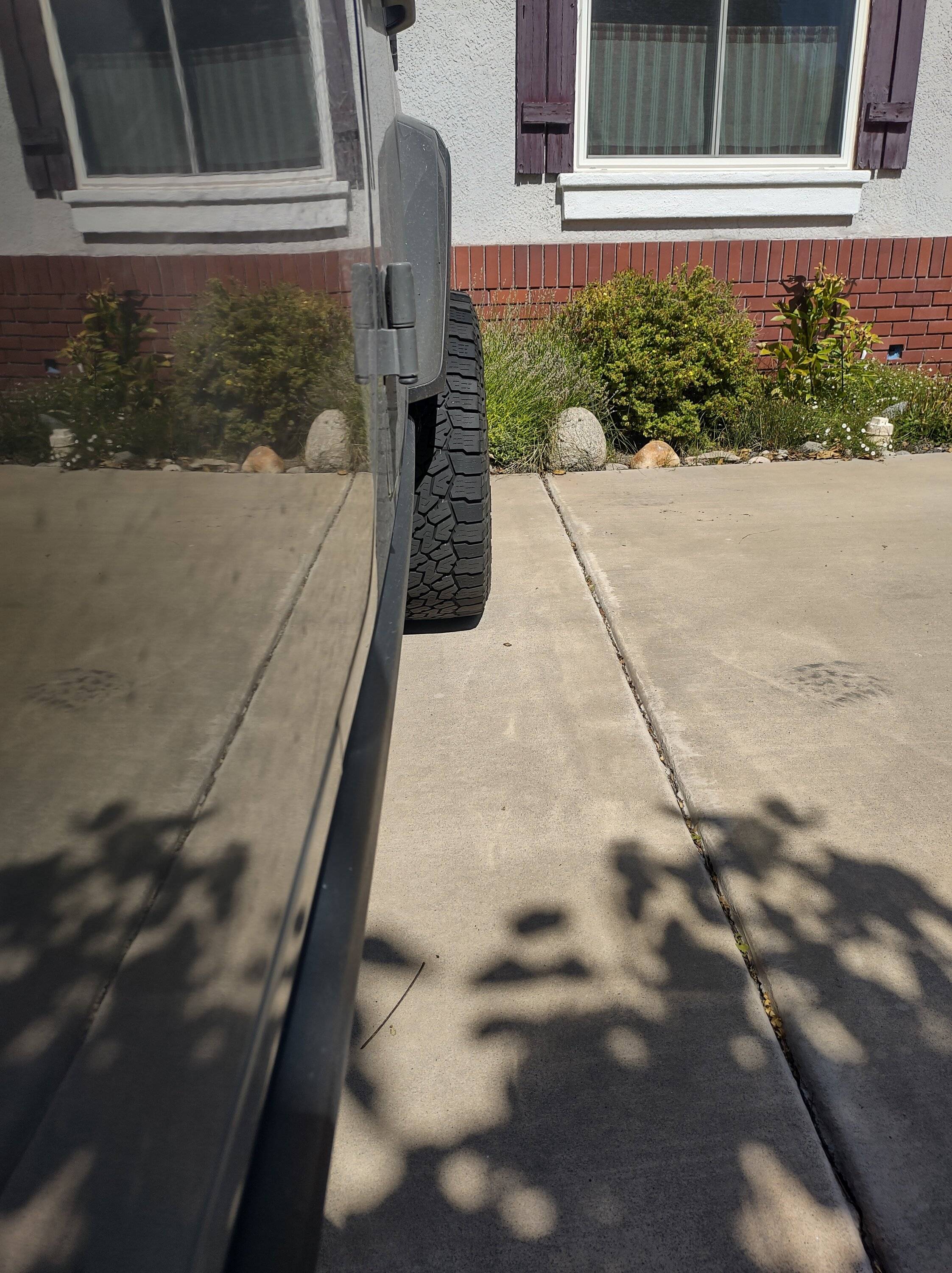

I ended up on a Sport S Ecodiesel with a 2.5 Clayton Overland kit and Icon Rebound Pros -6 I think it's a good amount of poke not to much. Front wheel turned slightly.
Jeep Gladiator "perfect" wheel specs? IMG_20230919_134937028_HDR
Jeep Gladiator "perfect" wheel specs? IMG_20230919_134859447_HDR
Jeep Gladiator "perfect" wheel specs? IMG_20230919_134913771_HDR
