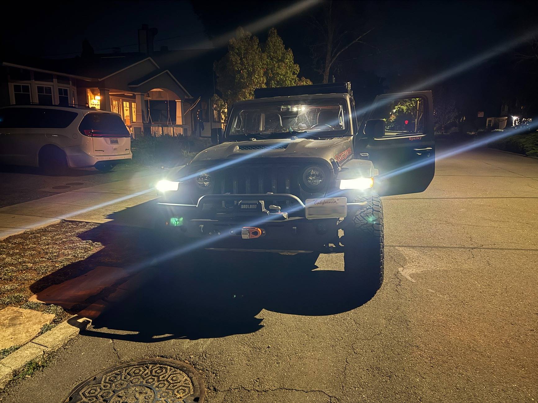

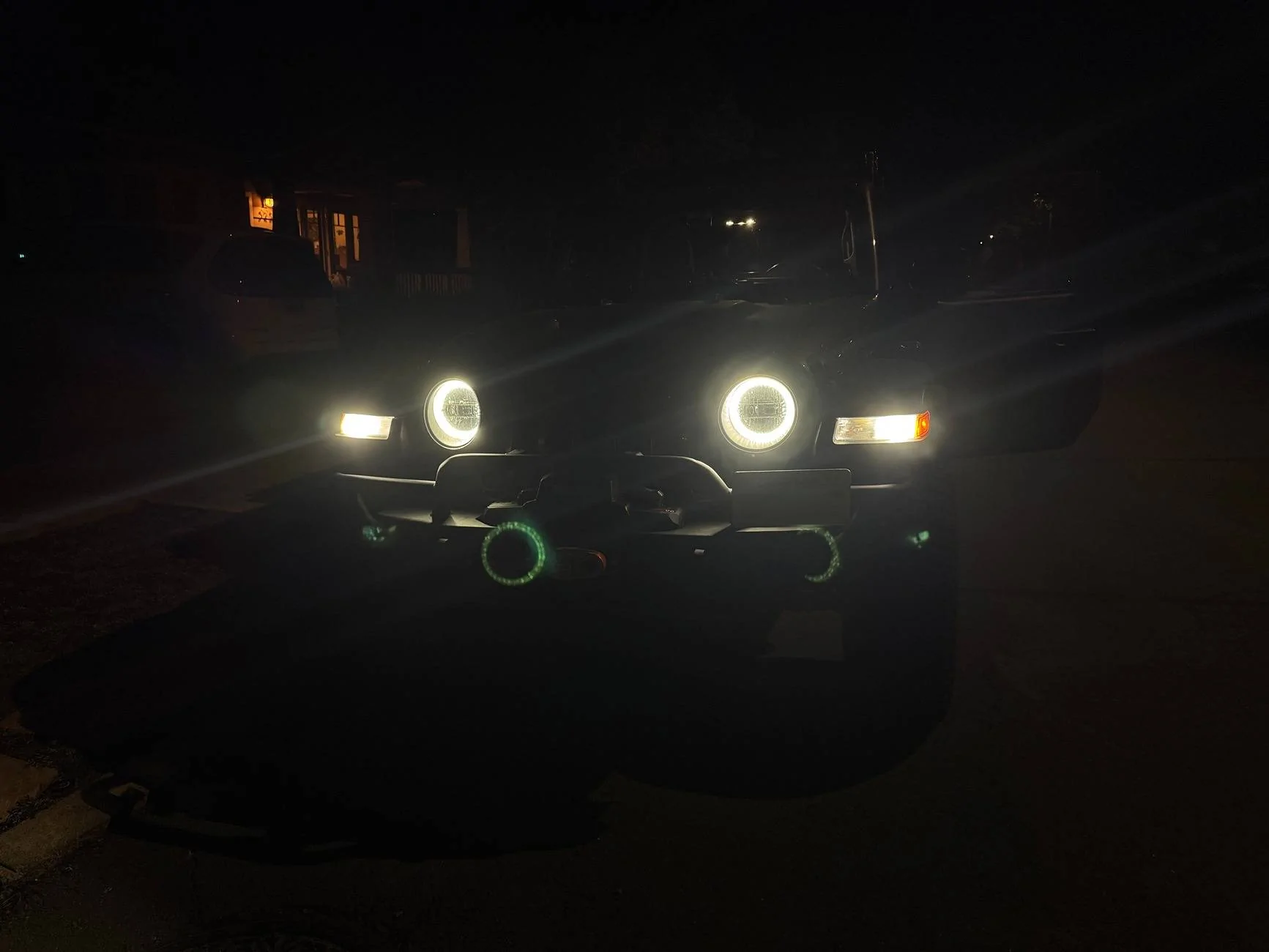

Do you have a pic of the lights at night?

Here are a couple of pics.... sorry about the quality, but you did ask for a night pic 🤣
Jeep Gladiator Which Switchback LED Turn Signal Bulb For JT Mojave? Turns1
Jeep Gladiator Which Switchback LED Turn Signal Bulb For JT Mojave? Turns2
