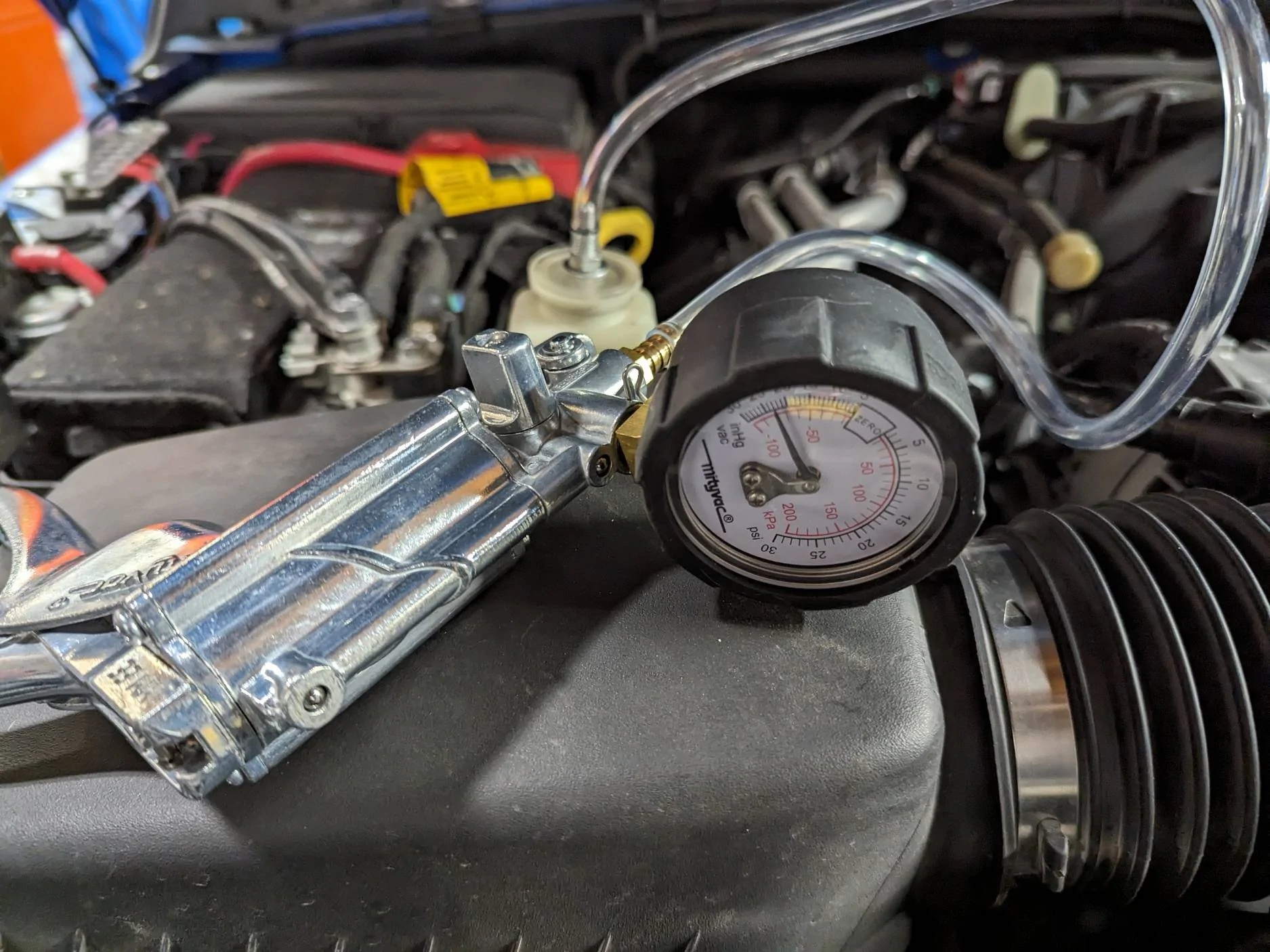

Steering pump is electric, that's what you're hearing.
Shouldn't be very loud - could indicate air in the system if there's a whine.
These pumps are really quiet, IMO. I only hear mine if I have the hood open and turning the steering wheel. A loud enough whine isn't normal. Even the old engine-driven pumps shouldn't whine, and a whine usually indicated an excessive load, air/low fluid or a worn pump.
Air in the system can be checked and purged -
Jeep Gladiator Whining noise from steering wheel PXL_20231108_222856578
