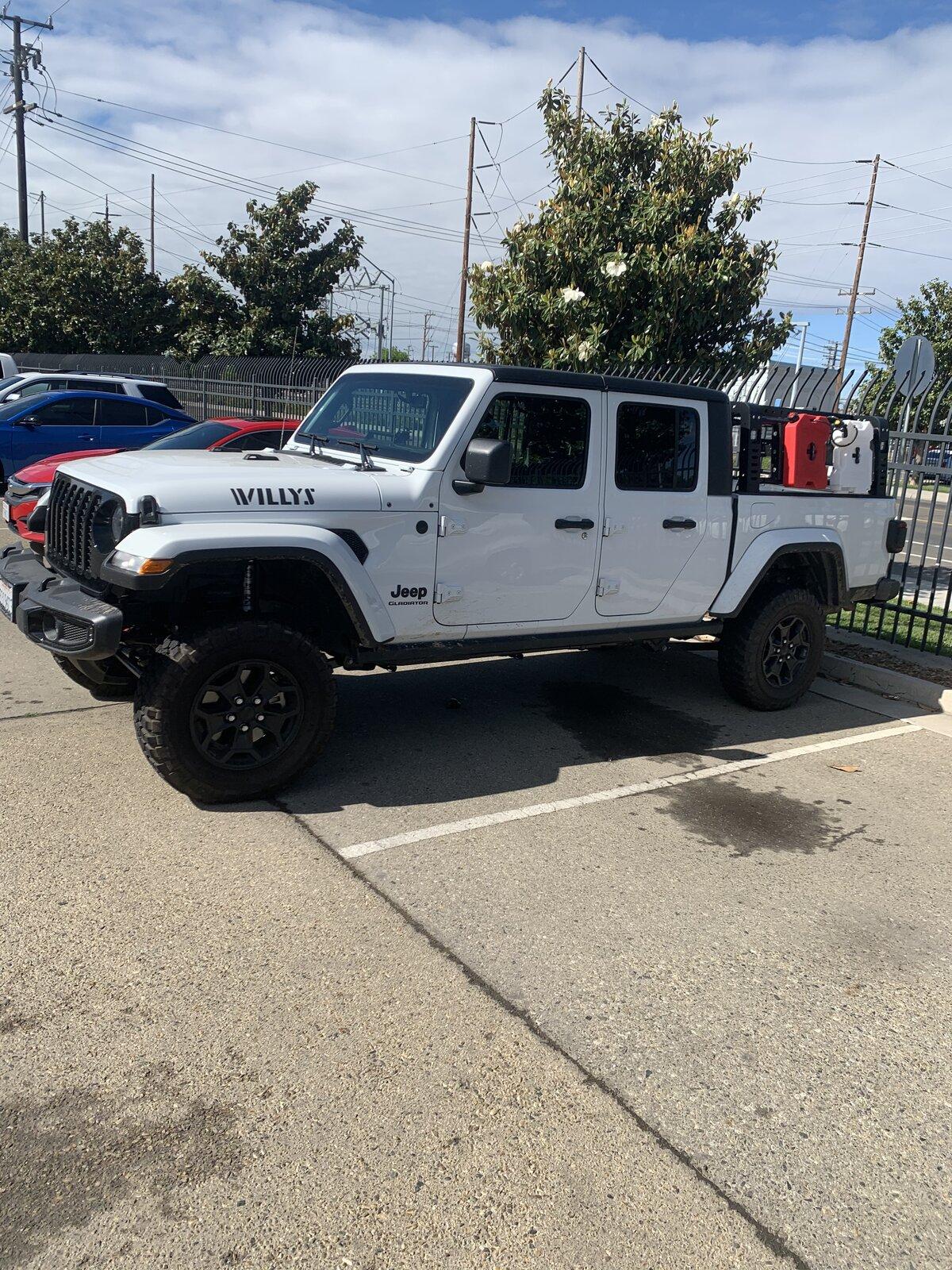

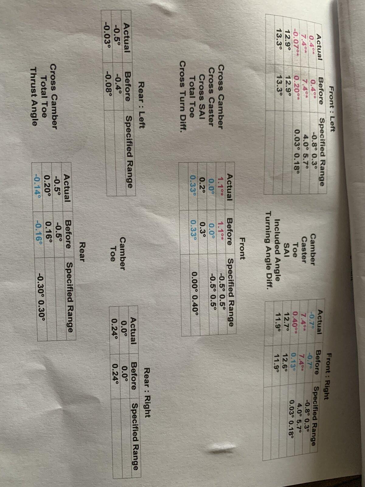

My appointment for my alignment is tomorrow. I just got the adjustable LCA’s on took it for a ride around the block to make sure everything all was good. Still had the creaking and found my steering wheel to be off center. I got back under the jeep to adjust my drag link when I noticed one of the bolts on the sector shaft brace had moved from the paint mark from when it had been torqued on. I tightened the bolt and from what I can tell no more creaking noise.

Installed a mopar lift with 1.5 teraflex level, yeti track bar,fox steering stabilizer and synergy sector shaft brace. Caster was definitely off pulls right and felt terrible going over bumps and a little bit of wobble. Put on a geometry correction bracket rides way better still pulls right slightly, but now I’m getting a creaking noise when turning steering wheel can’t quite pin point where it’s coming from definitely nothing rubbing. Taking it into the alignment shop today to see what they can do. Any ideas of what that could be?
