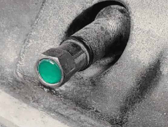

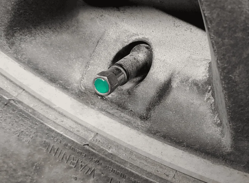

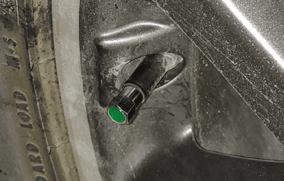

I was told only the dealer can remove the green caps
Why, does it take a special tool?
Maybe they are metric. I wonder what size wrench they take. Please don't say 10mm!

Anybody else dumb enough to take the factory green valve stem caps off and replace them with after market ones that SIEZE UP AND CORRODE???? ???
I always put a little anti-seize grease on the threads of the value stem. Never had an issue.

So, 80 posts abut green caps, nitrogen and beet juice (I run the beet juice in my tractor tires here NH), did the OP ever get his seized caps off?
Had the same issue when my wife put some aftermarket pink caps on her Jeep. I used a shaft drive dremel and a thin cutoff wheel, and cut the cap on a diagonal to the threads. Just like we used to do with frozen nuts in the machine shop. Be careful, you usually don't even need to go all the way through, chances are as you get close the heat from the cuttoff wheel will cause the remaining metal to crack when you get close to the threads. If they are really frozen on cut again on the opposite side rather than going crazy and damaging the stem pulling and twisting. You can do it without damaging the stem or the wheel.
Then I replaced them with pink plastic caps to make her happy.
