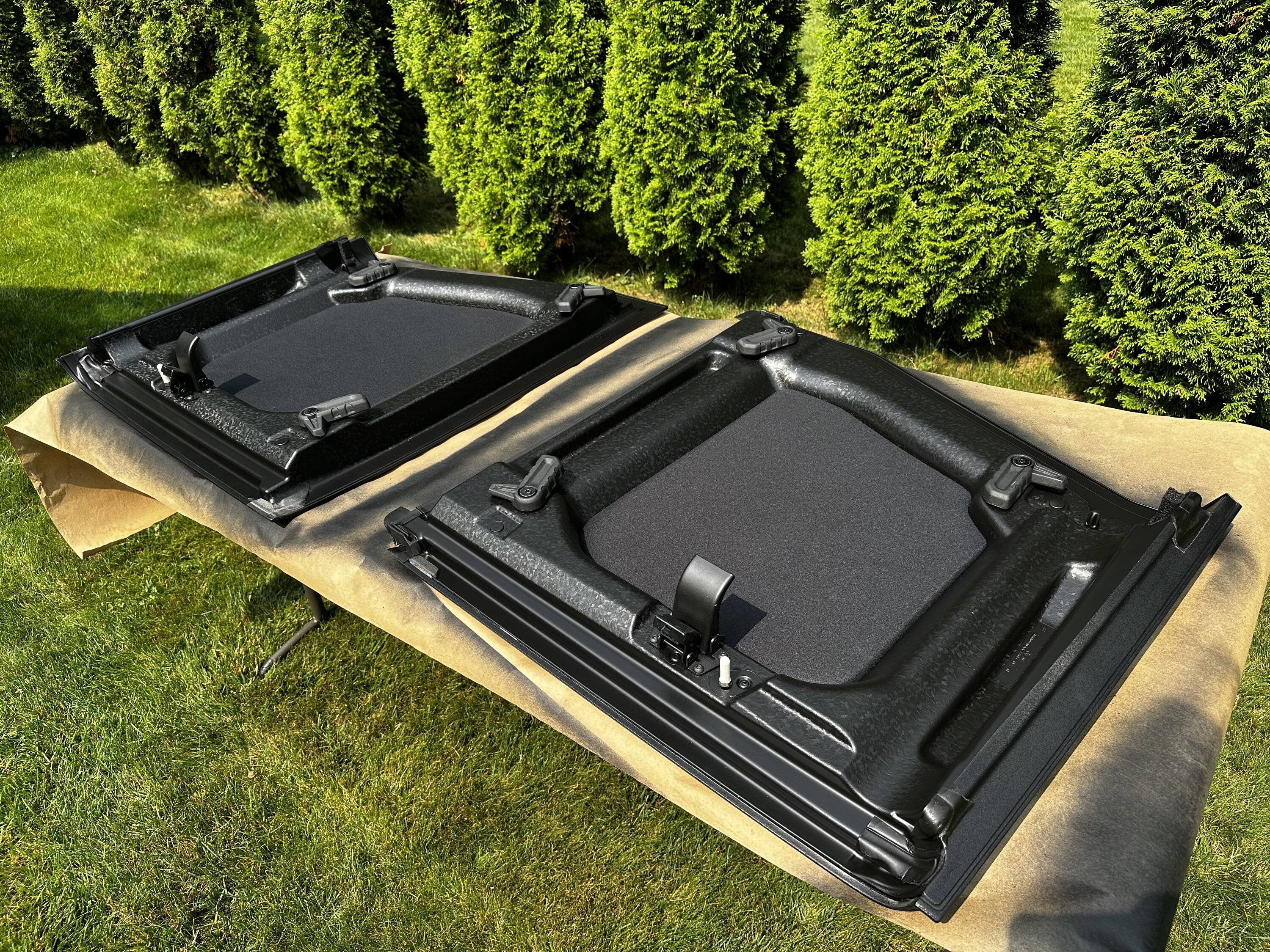

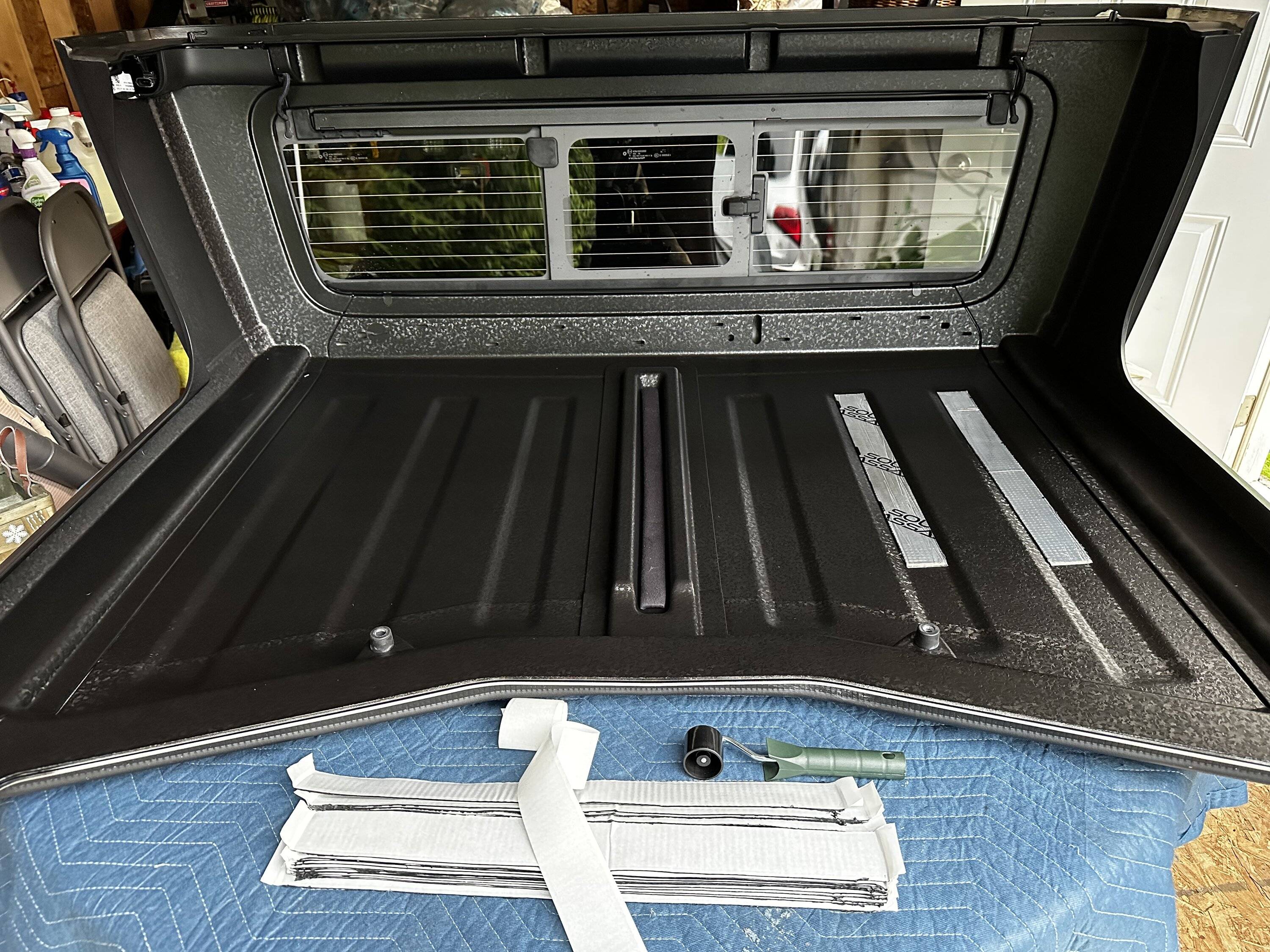

Having previously painted the inside of my JKUR hardtop, it was a no brainer to give the Gladiator the same treatment, with the addition of a @Hothead Headliners and sound assassin package.

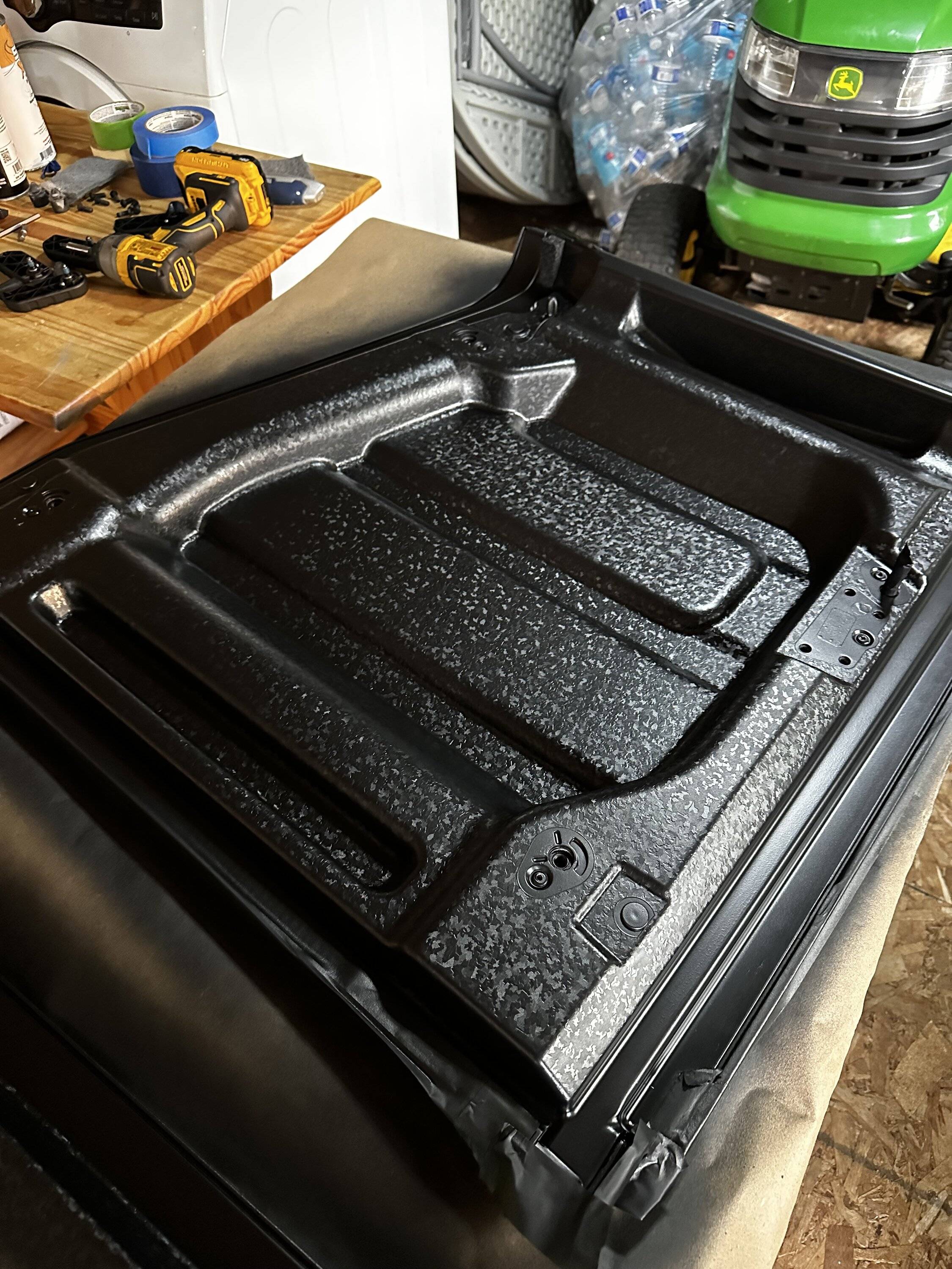

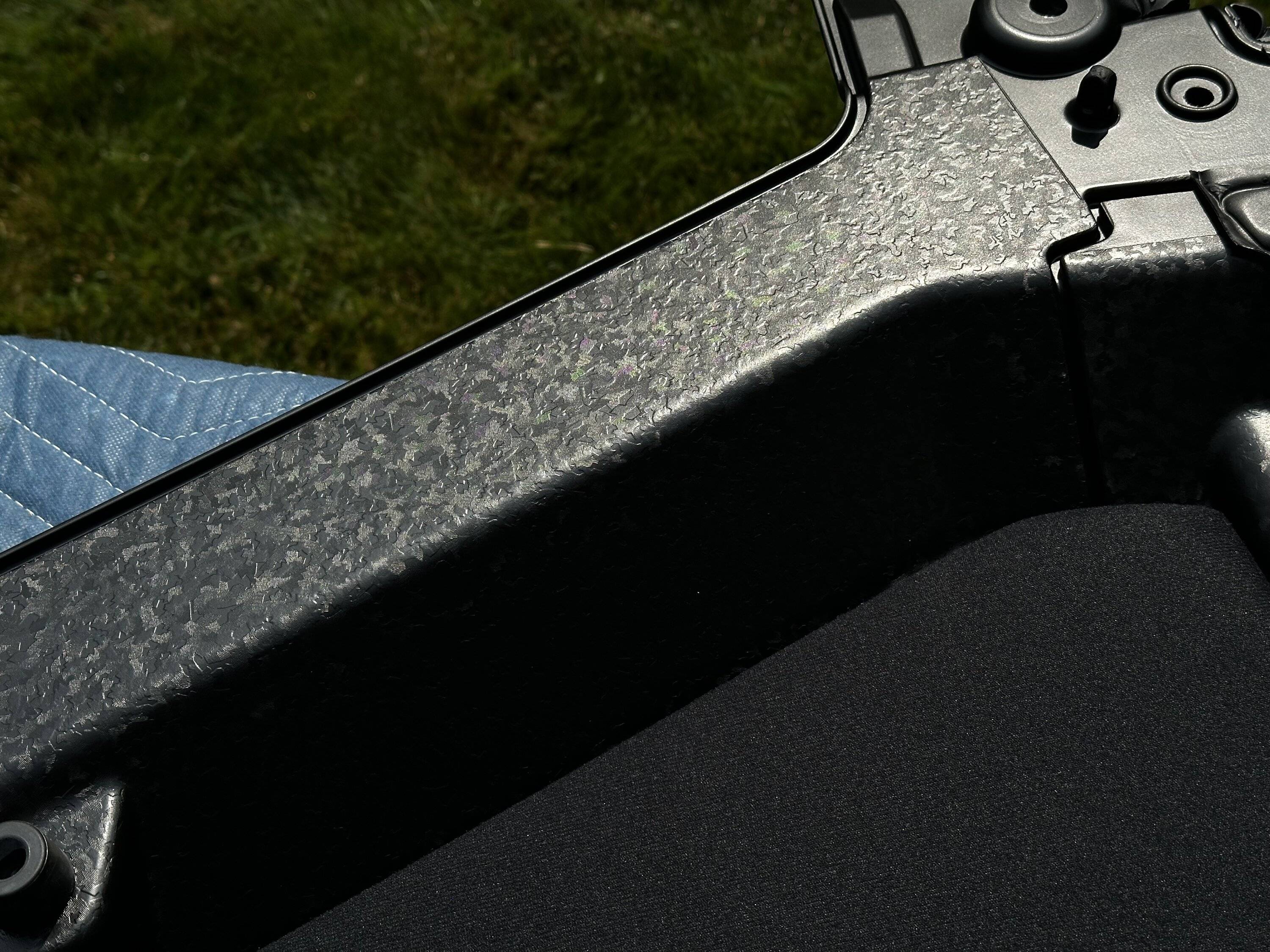

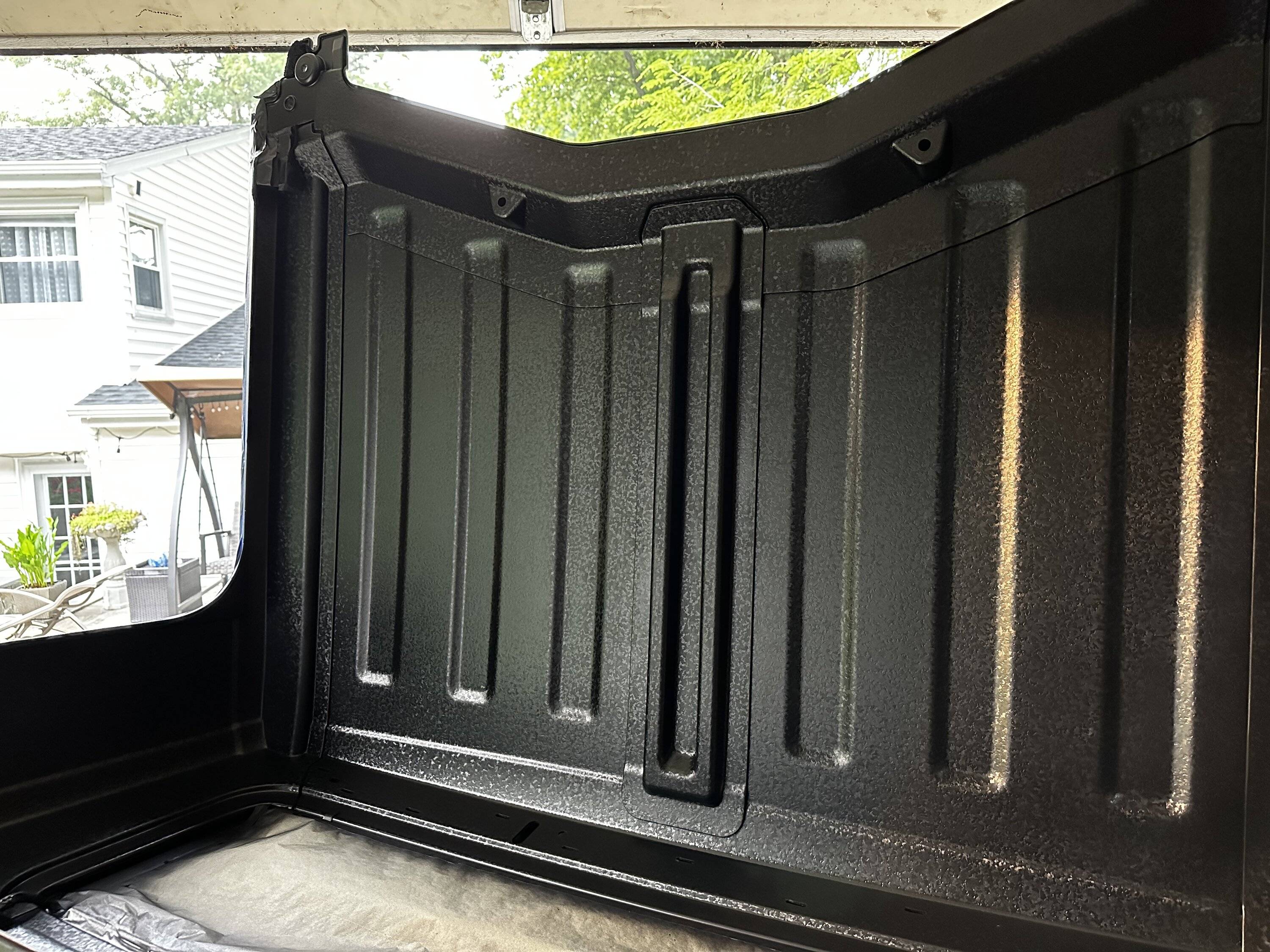

I began by taking off the hardtop, removing all hardware, and scuffing with black scotchbrite. Quick wipe down with wax and grease remover and it was ready for paint! I used SEM Trim Ultra satin paint. I used the same stuff on my JKUR and it does a great job matching the factory black plastic. If you’re not installing a headliner, the all black headliner looks killer! The factory hardtop design stands out so much more in black! Check it out:
Jeep Gladiator Why isn’t this factory? Full Hotheads Headliner, with an OEM+ twist. IMG_8473
Jeep Gladiator Why isn’t this factory? Full Hotheads Headliner, with an OEM+ twist. IMG_8474
Next up was reinstalling all factory hardware and sound assassin strips. I didn’t take pictures of them all installed, but it looks just like the install pics from Hotheads.
Jeep Gladiator Why isn’t this factory? Full Hotheads Headliner, with an OEM+ twist. IMG_8476

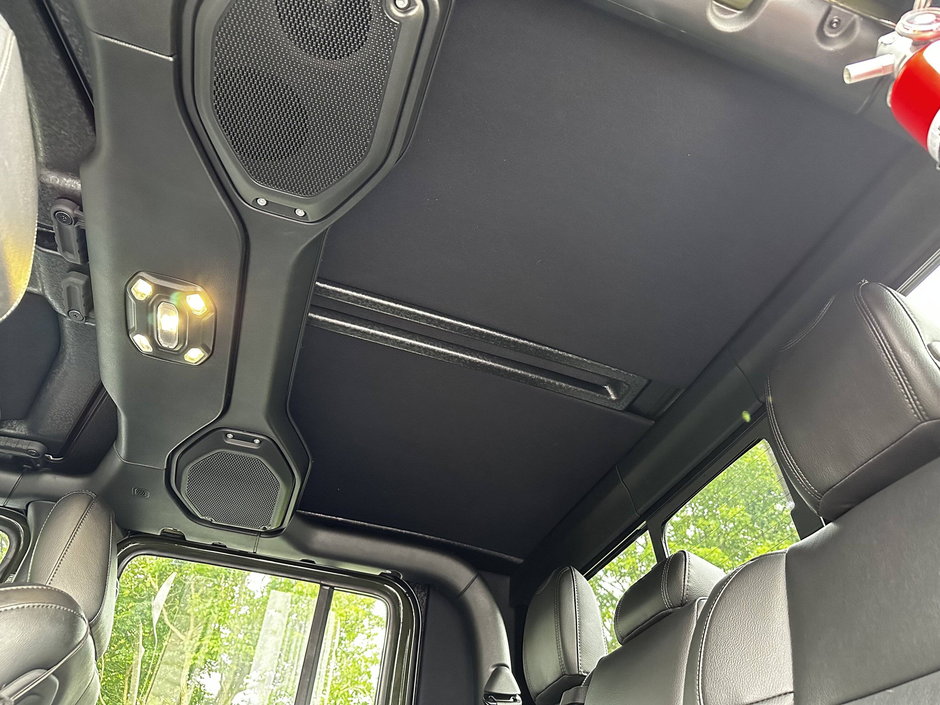

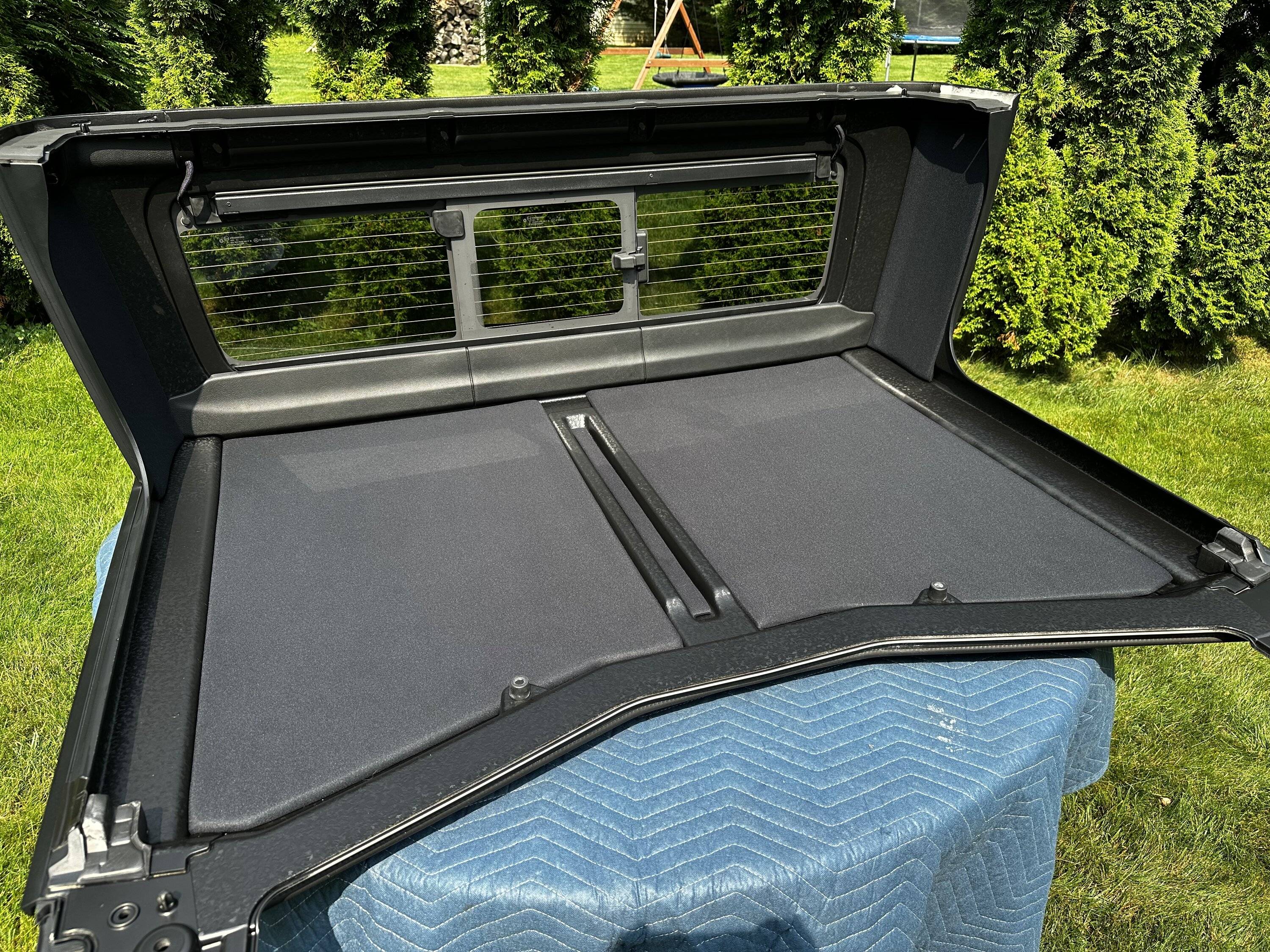

Finally, I installed the headliners themselves and let it all air out over night and most of the following day. The headliner had a more pronounced smell than the paint itself. It’s still a bit smelly, so hopefully that goes away in the next couple of days.

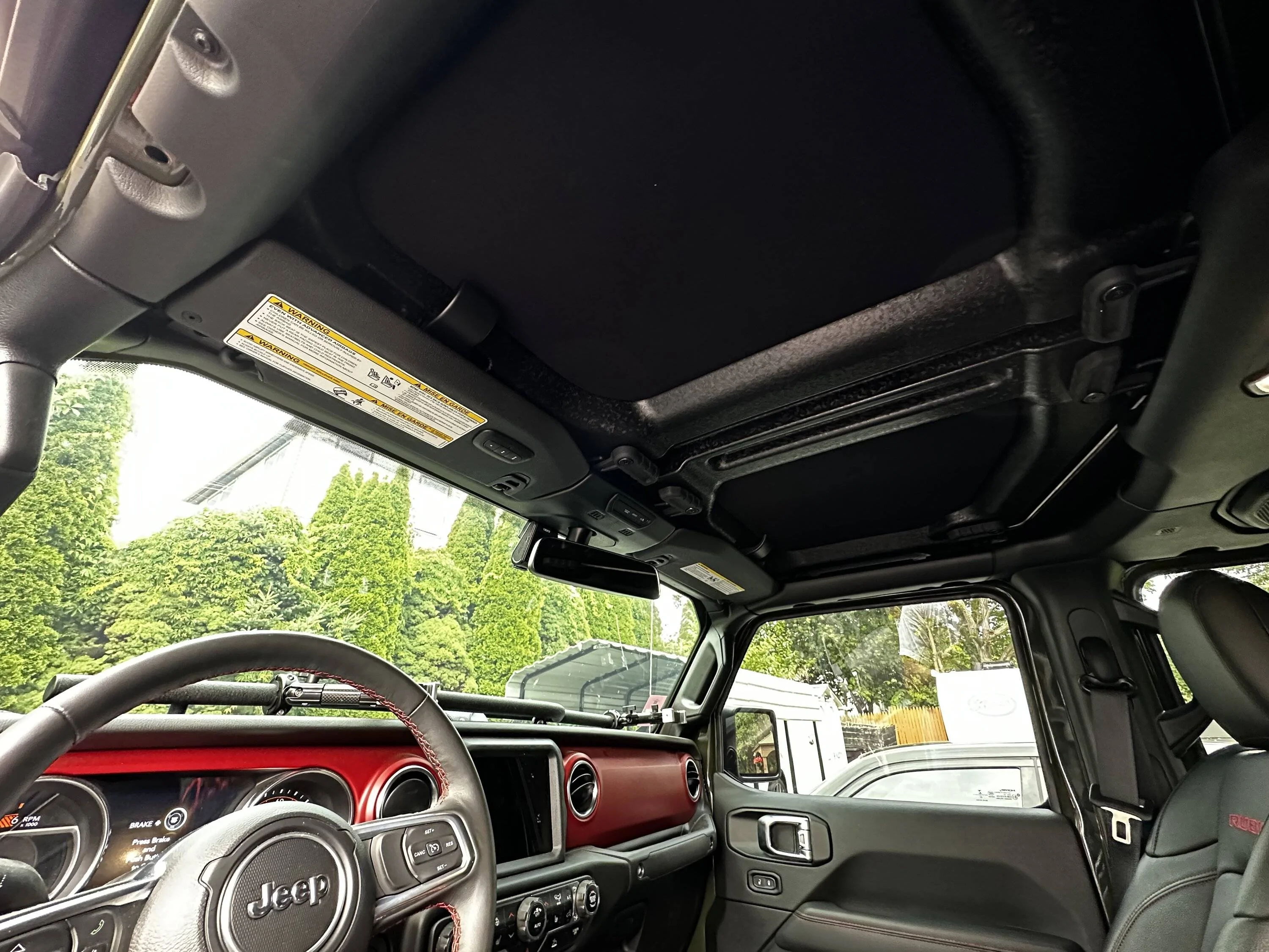

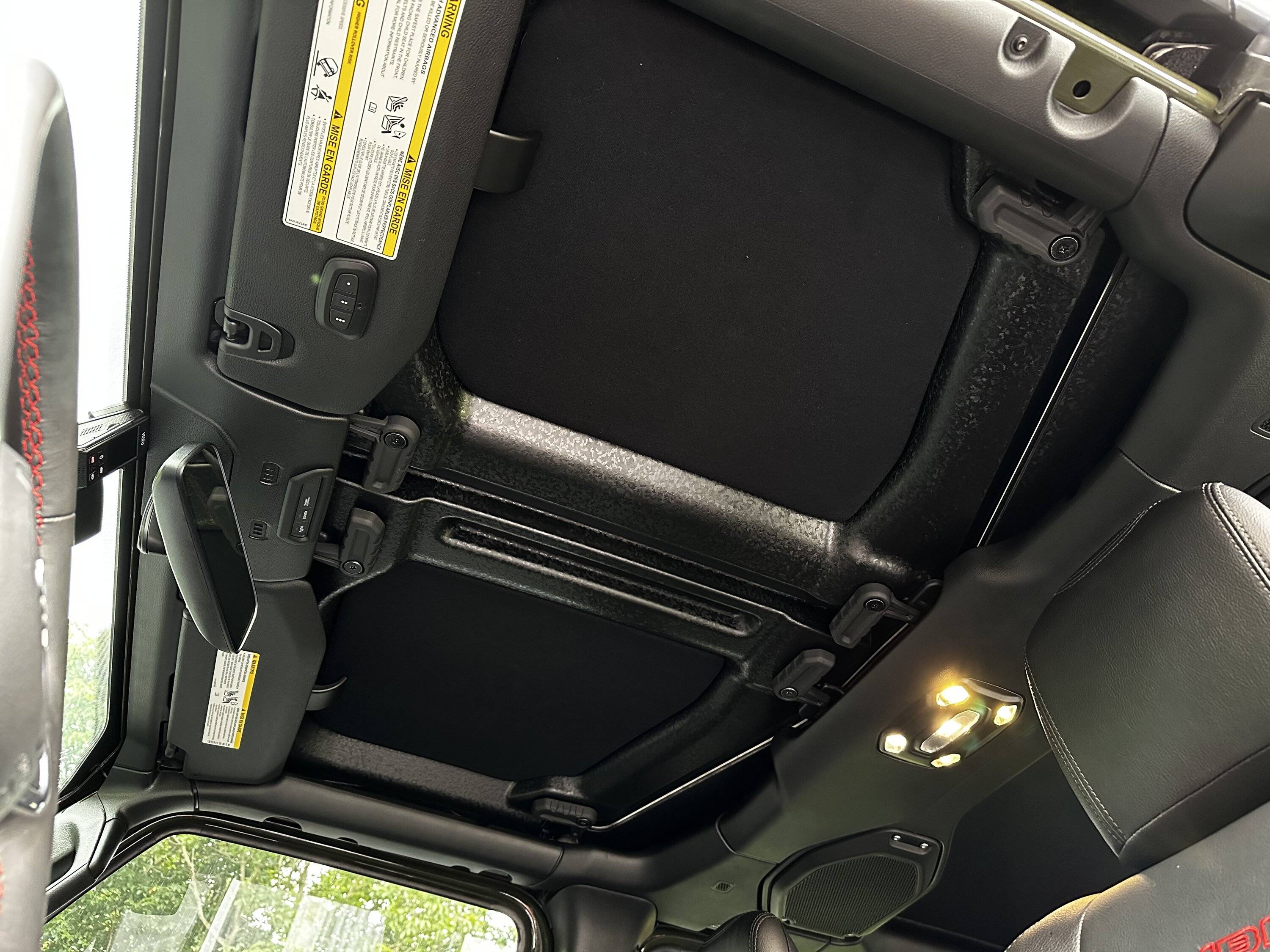

In my opinion, the black paint + headliner is the way the top should come from the factory. It gives the interior a much better, finished look! Take a look for yourself:
Jeep Gladiator Why isn’t this factory? Full Hotheads Headliner, with an OEM+ twist. IMG_8492
Jeep Gladiator Why isn’t this factory? Full Hotheads Headliner, with an OEM+ twist. IMG_8493
Jeep Gladiator Why isn’t this factory? Full Hotheads Headliner, with an OEM+ twist. IMG_8494
Jeep Gladiator Why isn’t this factory? Full Hotheads Headliner, with an OEM+ twist. IMG_8500
Jeep Gladiator Why isn’t this factory? Full Hotheads Headliner, with an OEM+ twist. IMG_8502
Jeep Gladiator Why isn’t this factory? Full Hotheads Headliner, with an OEM+ twist. IMG_8504
Very happy with the results! Haven’t had a chance to test out any difference in acoustics or temperature control, but the looks themselves are worth it to me! Cheers!

Very nice job. It looks like you removed the rear window during prep too?
Thanks! No way would I touch that thing! Lol it was just masked with paper.
