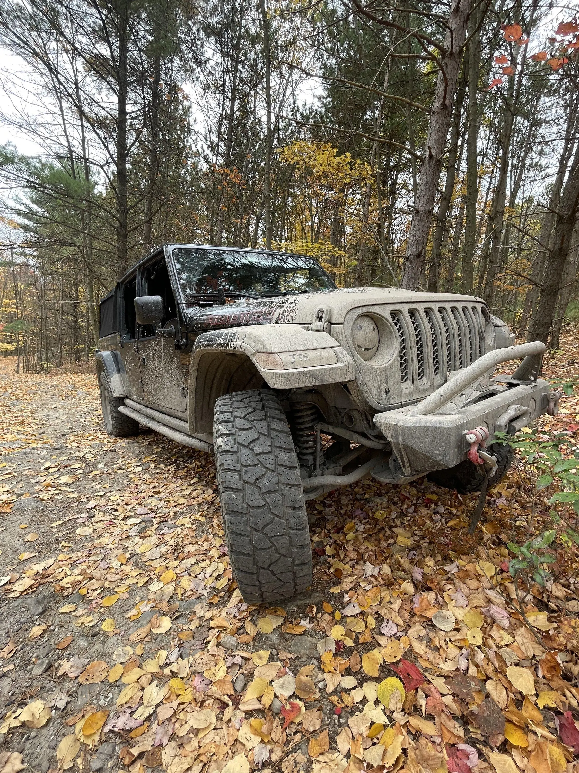

Had it out at Anthracite Outdoor Adventure Area yesterday with a large group - mostly automatics. They kept stopping on Rocky hills. Zero issues starting on an incline, on rocks. I’ve been on the exact same trails and location with a group previously with my stock clutch and I could smell it burning.
