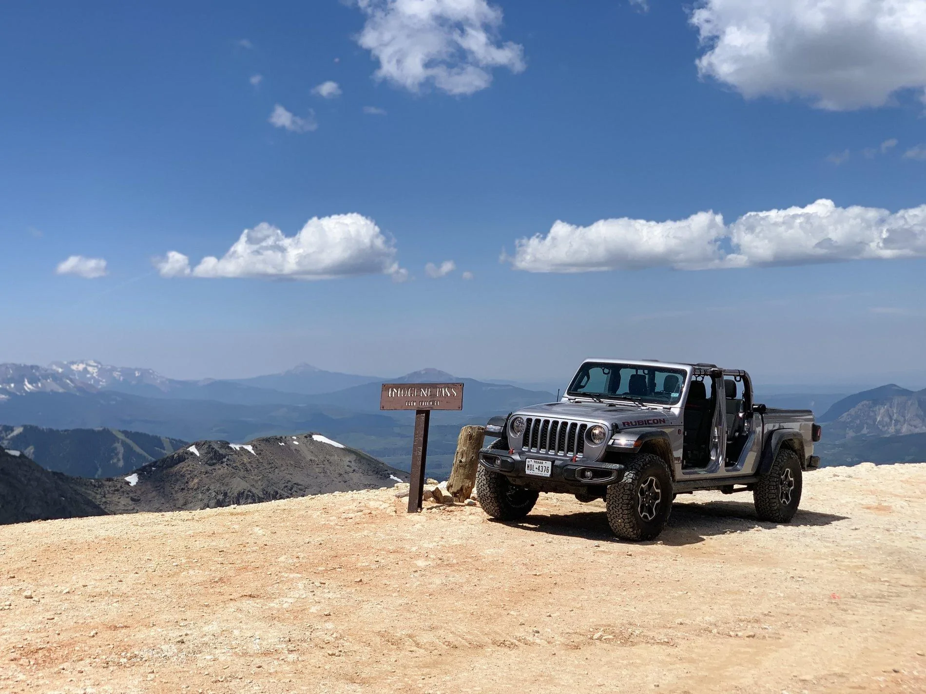

If you need them under the flares to pass inspection, just use stock wheels. If sticking out just a little will pass, go with an offset of +10 to +25. I agree that a lot of the Jeeps we are seeing have ridiculous offset/width. Here’s how mine sits on +11:
Jeep Gladiator Wider fender flares? 36BE2D30-D0C2-460A-A073-3FF259064992
Is that a 35 x 12.5?
