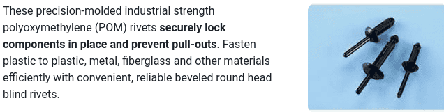

You need a 10mil socket and a 30torx socket and you're off to the races. Though having just done my install last week, i HIGHLY recommend a trim tool, a drill, a rivet gun, and plastic rivets.
Referring to POM rivets, correct?
HF has a tool with a selection of POM rivets and some of those fit these pretty well. Cheap and something a Wrangler or Gladiator is likely to see a need for in the future if they do anything themselves.
I can't say I know what a POM rivet is, but here's what I bought (they were originally purchased to install XR fender flares, but came in handy on the fender light install as well)
Amazon.com: Rexka 100pcs Fender Flare Bumper Door Trim Plastic Rivet Retainer 1/4 Hole Compatible with Chrysler 6506007AA 07-20 Jeep Wrangler, Wrangler Unlimited JK & 02-12 Liberty KJ GM 10184895 Ford N803862-S : Automotive
Here's the riveter i used (though it was tool only back when i bought it, no rivets included)
Hand Riveter with 40 Industrial Strength Poly Rivets (harborfreight.com)
If i had known beforehand the BOLT hoodlock was going to require a real riveter, i wouldn't have bought the small guy and just stuck with this guy that i now also own

Yup - POM rivet.
