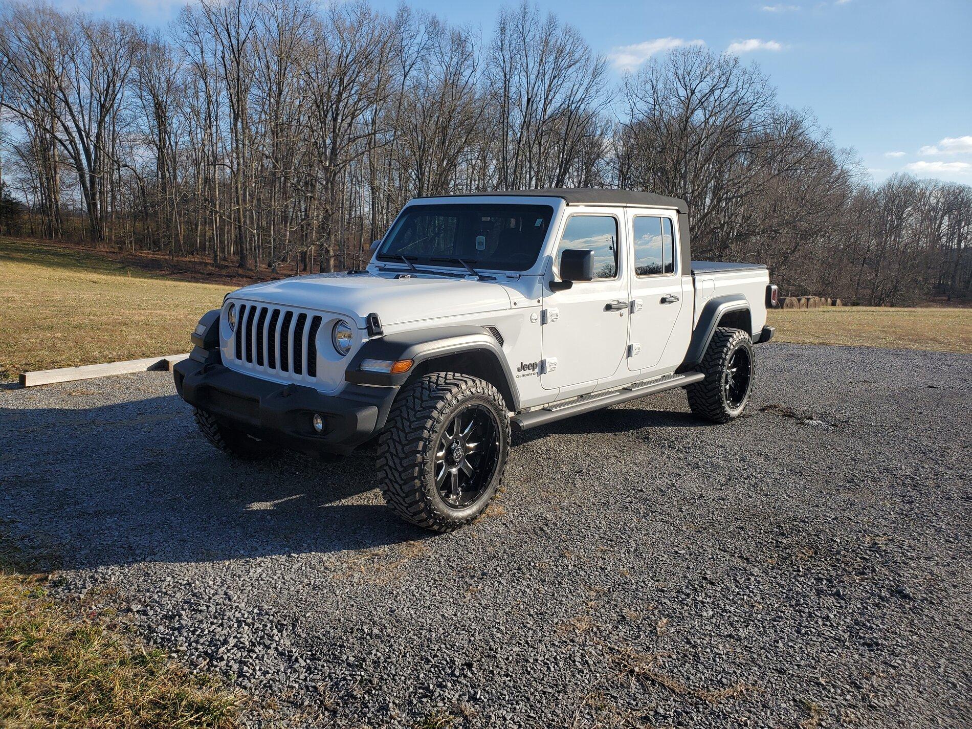

I recently put 33x12.50r20 on my 2020 Jeep Gladiator Sport I had to trim maybe an inch off the plastic fender guard but they no longer rub and looks aggressive also took care of the "death shake"

Wow, those look like they stick out beyond the fenders 3” or 4”
