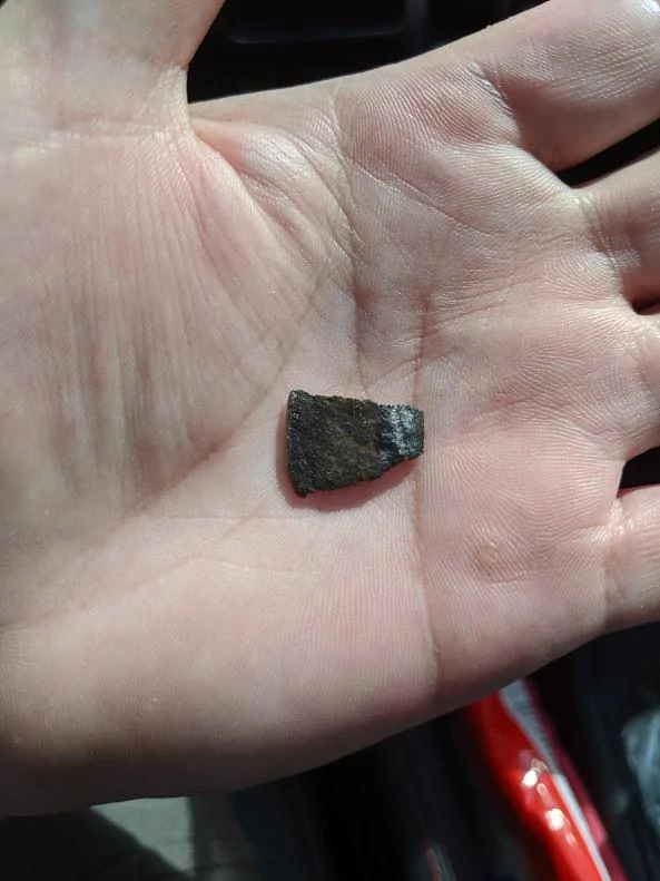

I've heard that more than an inch difference will be like crossing the beams baaad.
I pulled a damn shiv out of one of mine today, and while it didn't go all the way thru, scared me enough that I'm gonna start looking.
Jeep Gladiator Will the 33 Spare Work Work With 35's SPUOLgWGJLGWal_XoTEYvIRAbHmntms76lWYQM1suKISh0_drFQorCcLWIuZwig6sSb-A0q1zUmnlNQ2iFb=w594-h791
