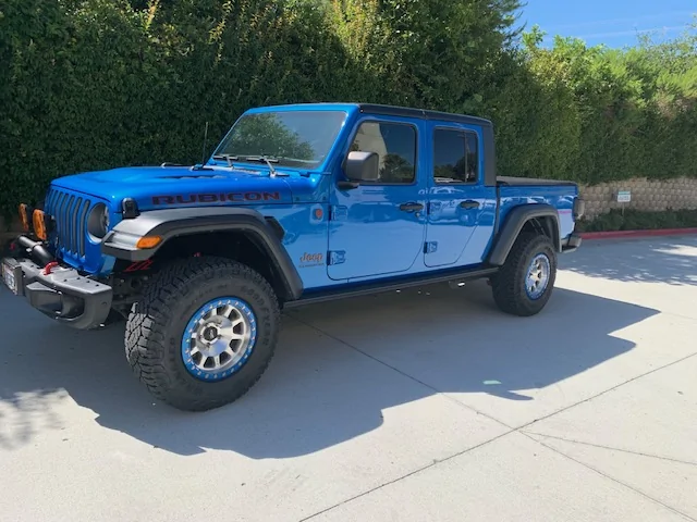

I have the same setup except a stock 2020 Rubicon and Battle Born wheels the same size and 315/70R17, without the winch or spacer kit. But I did replace the front inner fender liners with American Adventure Lab. for added clearance
Ok thanks. Nice looking rig.
