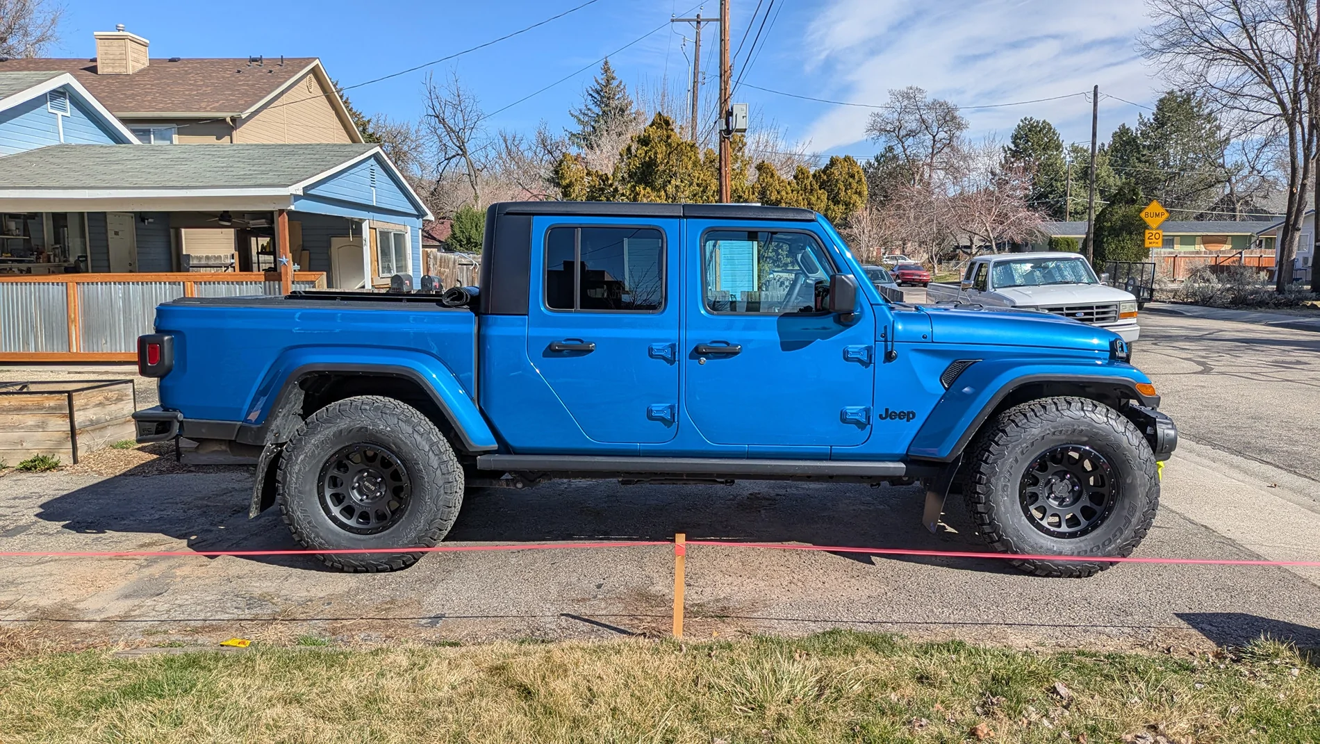

Stock lift, amazingly no rubbing lol:
Jeep Gladiator Clearance for 37x12.5s? Non-Rubicon axle width and 17x8.5 0/4.75" BS PXL_20250310_214806240(1)

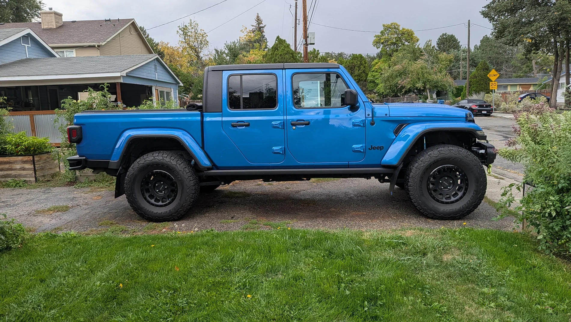

After 3.5" lift:
Jeep Gladiator Clearance for 37x12.5s? Non-Rubicon axle width and 17x8.5 0/4.75" BS PXL_20250930_213225154(1)
After 3.5" lift:
Thanks for the pics. Crazy that it didn’t rub on no lift. Your truck is the exact color combo of mine, blue w black top and color matched fenders, so this is almost like looking at my actual truck. Great example. 👏
