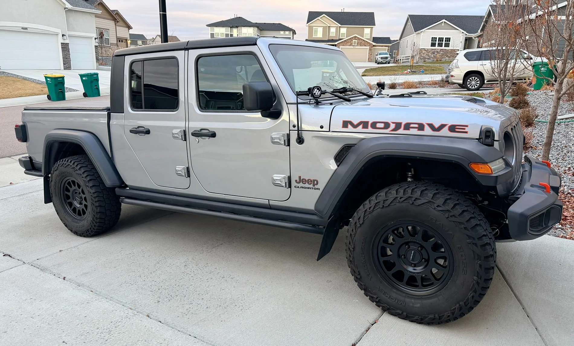

I bought my Mojave used and it came with 315/70r17 tires installed on stock wheels with no lift. Worked fine but decided I wanted a wider wheel for the tires. Installed Method 703s 17x8.5" with +25mm offset last week as I didn't want a lot of poke. Stock wheels are 17x7.5 +37.17 offset. Result in the change is ~1mm loss in back spacing. Still have no rubbing. As noted above, majority of AEV wheels for the gladiator are the same spec as the Methods I went with.
