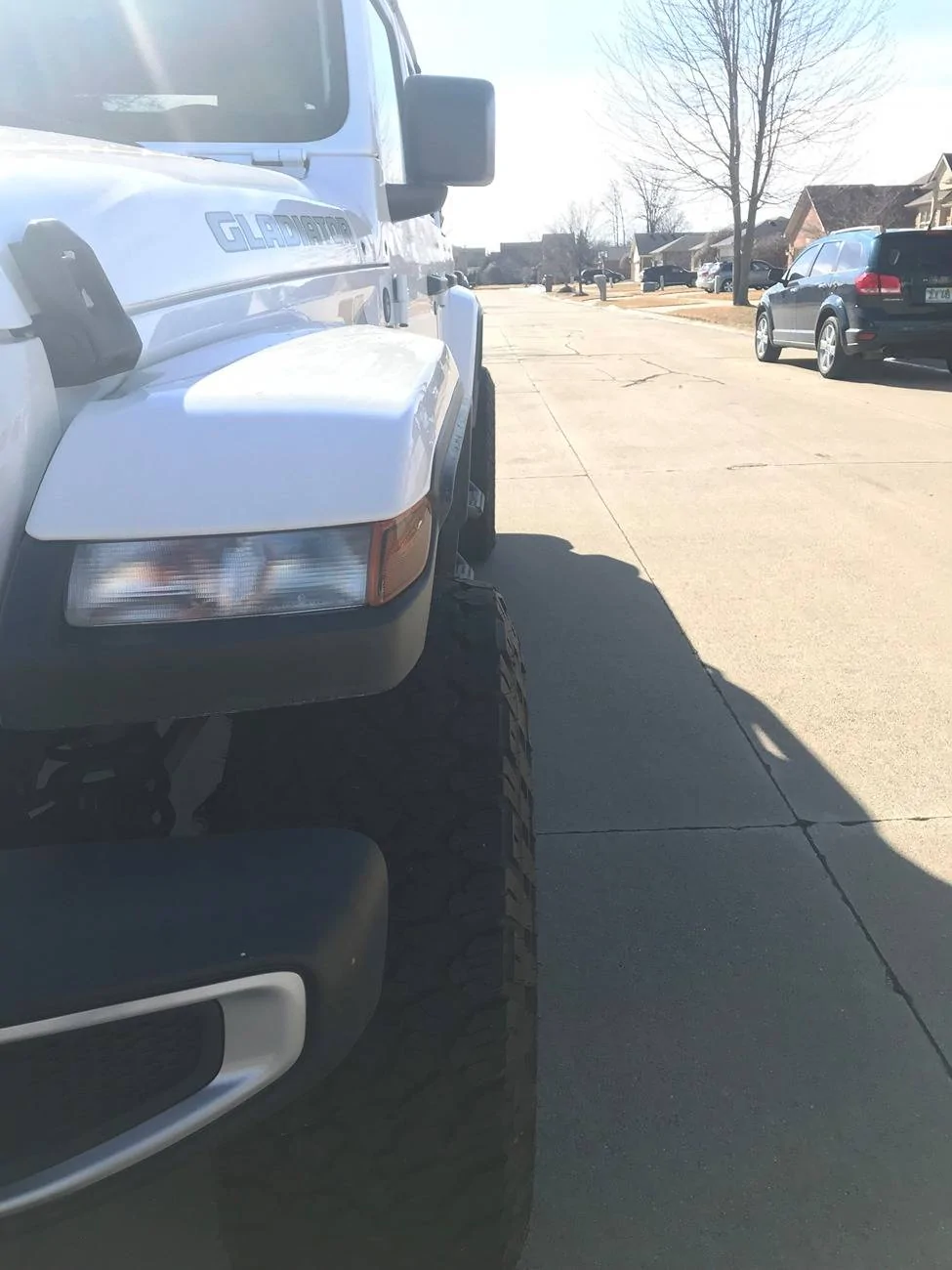

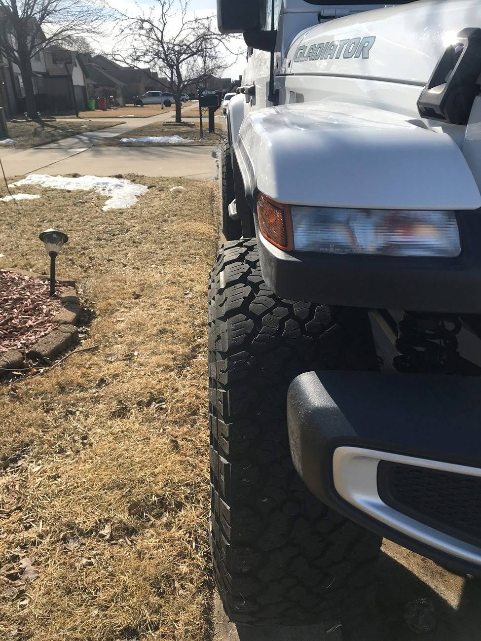

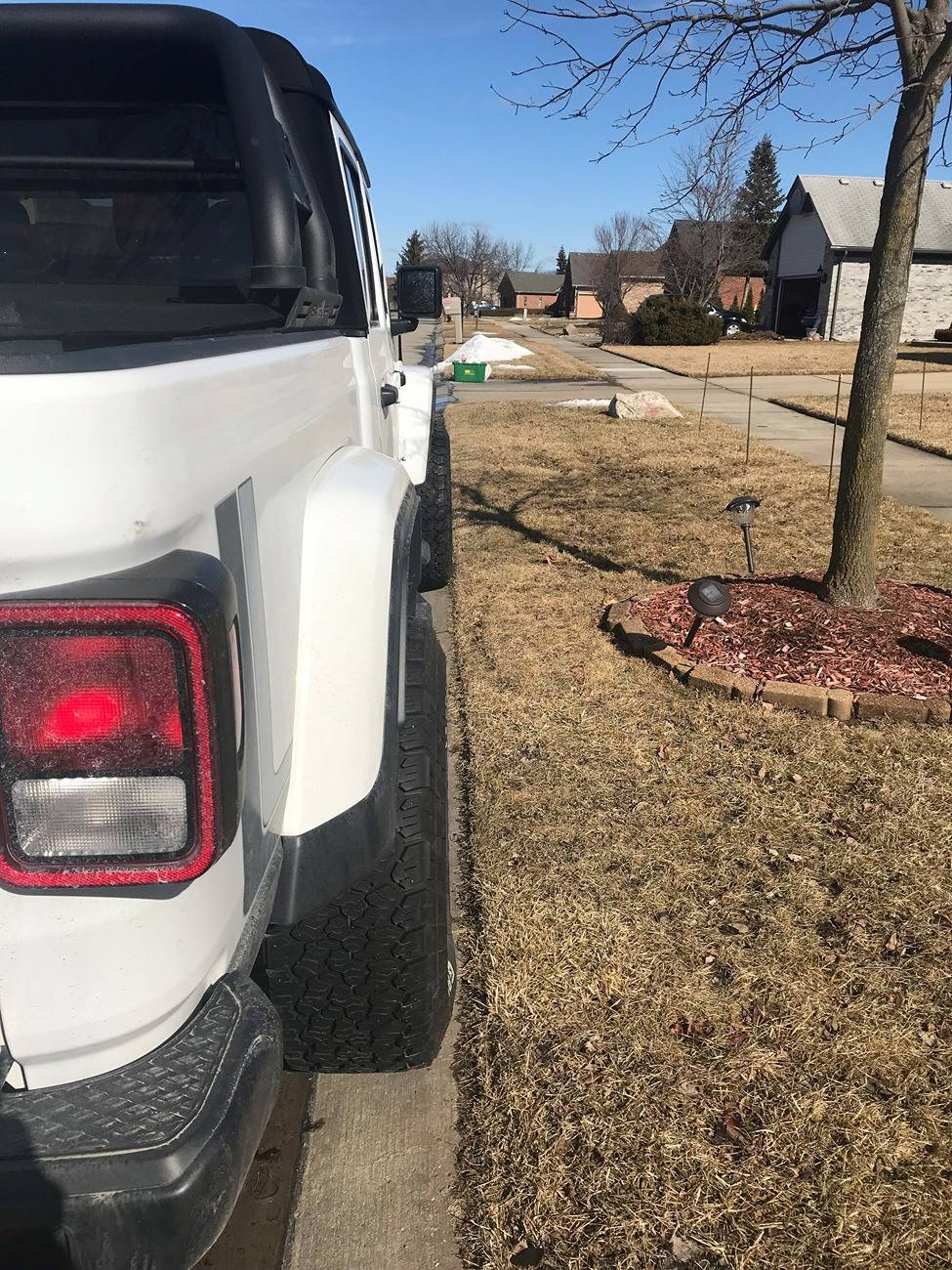

This is a 8.5" wheel on a 5.2' backspacing if that helps. 2021 sport max tow
Jeep Gladiator Tire poke and clearance wheel poke front 2
Jeep Gladiator Tire poke and clearance wheel poke front and back
Jeep Gladiator Tire poke and clearance wheel poke front and back 2
Sandman 4x4
Jul 23, 2024
691
565
Kissimmee, Florida
2024 Gladiator Sport S
Retired. Beach bum.
Yea that’s as far as I would ever want to go beyond the edges. I’m not a fan of wide tires anyway. Especially in heavy rain. I prefer nothing wider than 255, with at least 75 aspect ratio sidewalls. With no larger than 17x9” wheels. That’s what I will add when my stock 245/75-17 loose 1/3-1/2 their tread.

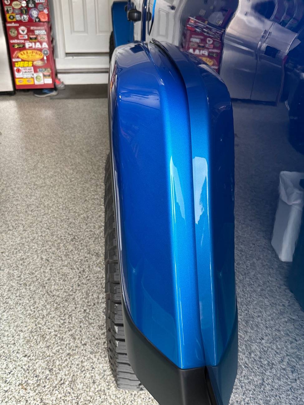

FWIW…. I have 17 x 8.5” wheels with +25 offset.
Granted, I’m running the stock 33x11.50’s.
I would predict your 12.5” wide tire would stick out 1/2” farther than mine (factory fenders with no extentions).
I’m sure, You’d have clearance concerns with 37’s…..
