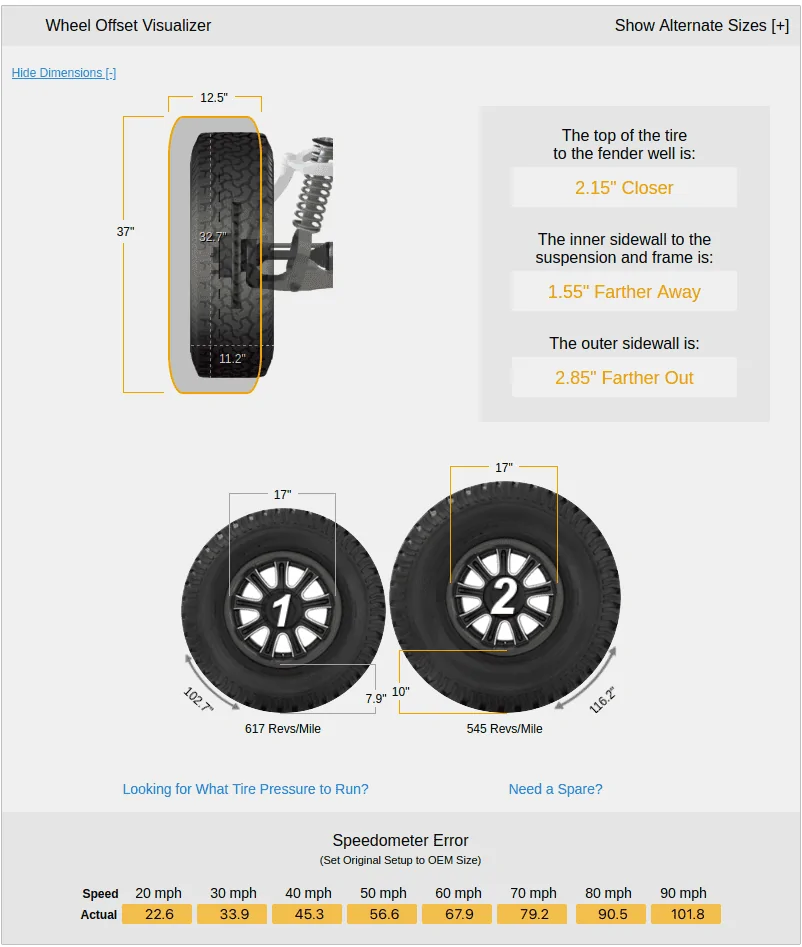

If you access their site from a laptop or desktop it provides a nice graphic representation of the difference too..... here was my picture going from factory wheel on tire on my JTR to a -12mm offset wheel and 37x12.5LT17 tires.

The only thing with this field was that you can’t take wheel width into account.
When you base your measurements on offset, the wheel width doesn't play much of a factor in the overall outcome (other than some minor effect on the resulting actual tire cross-section). The tire size determines the expected width and offset is measured from the hub surface. The numbers that tiresize.com generates should be good for getting a handle on how changing the tire and/or offset will affect the location of the tire. The real number that will indicate how much poke is the one labelled "The outer sidewall is..."

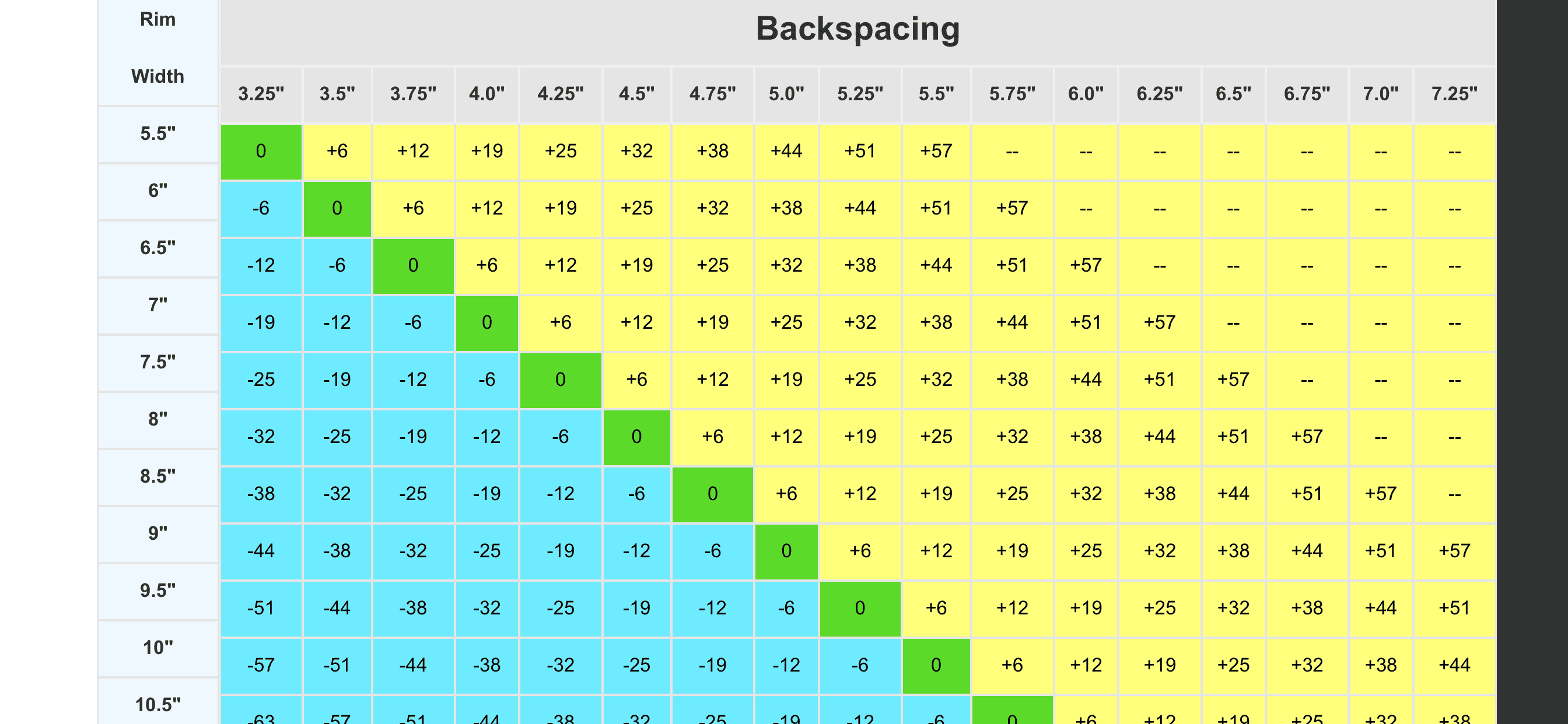

If you are looking at backspacing, the wheel width matters, and that's why they have the chart for converting wheel width and backspace into an offset.

My brain isn't computing this.
Why would wheel width matter at all on a vehicle where the tire is always noticeably wider than the wheel?
The full quote - "then for every half inch of rim width you add, you would need a 1/4 inch (6.35mm) of negative offset to stay even on the poke with the same width tires."
A 7.5 wide rim with zero offset means you have 3.75" of rim set inward towards your steering and suspension components.
An 8" wide rim with zero offset moves the inner edge of the rim 1/4" closer, and thus the tire's edges as well. Same tire, but the bead got moved inward by going to a wider rim, as did the sidewall, tread, etc.
A 12.5 " tire will also sit wider at the sidewalls and tread on an 8 inch rim than it will on a 7.5". So 1/4" is just the mechanical allowance (to keep the inside edged of the rim where it was on rim that was 1/2" more narrow). In reality it's likely to be slightly more than that.
