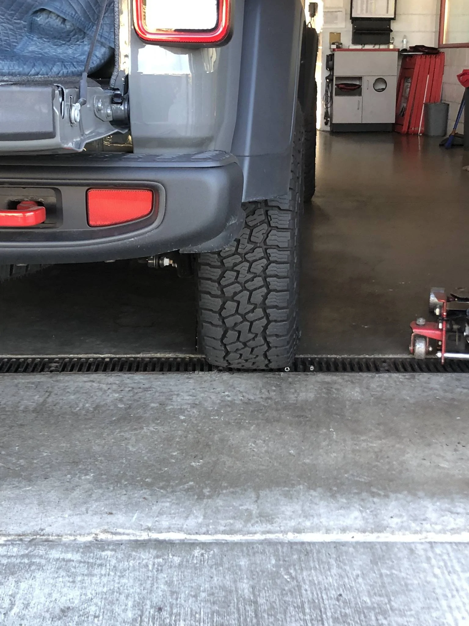

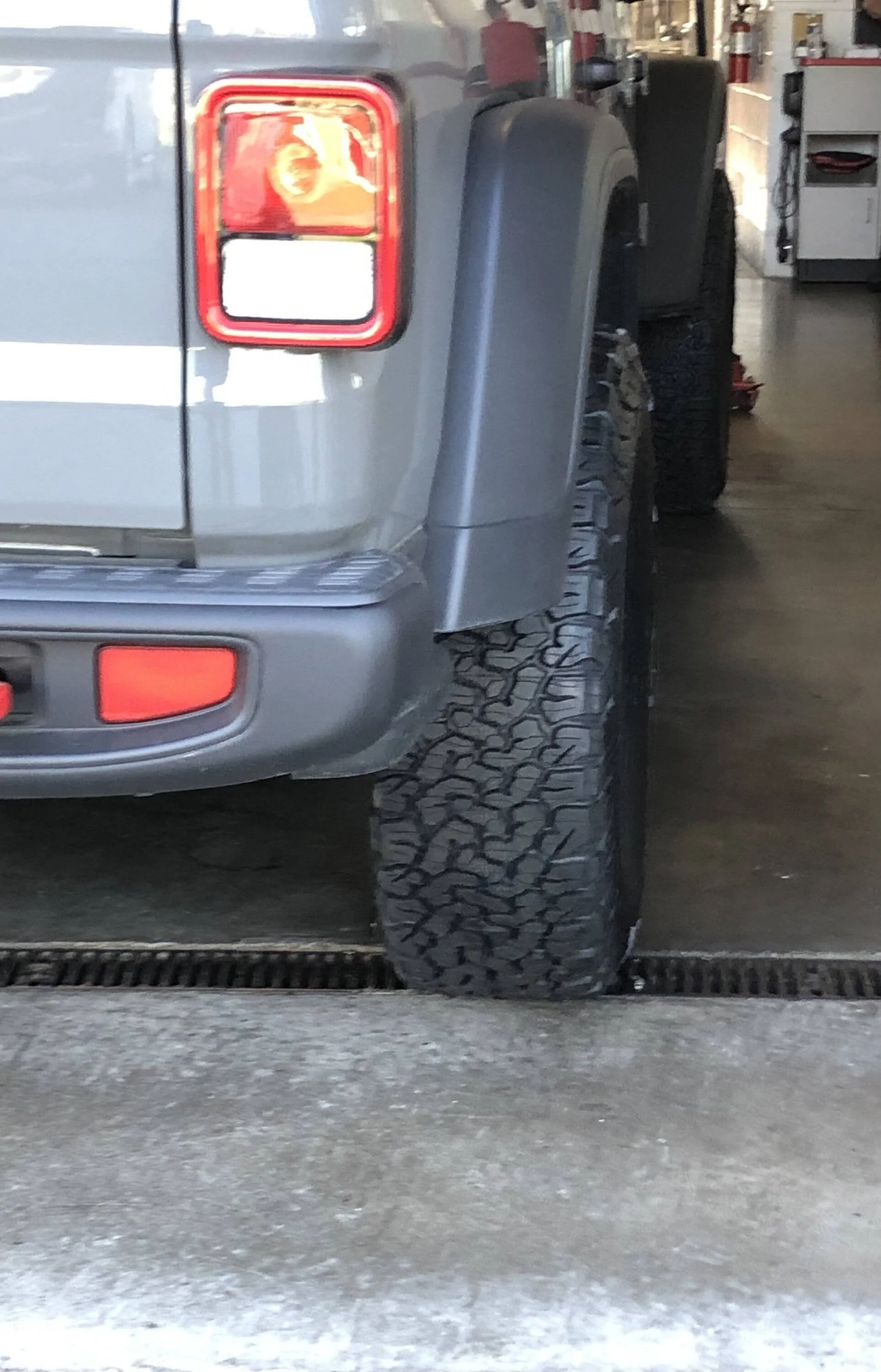

AEV with the JL offset (couldn’t tell you what it is off the top of my head) with 315/70-17 is the perfect amount of poke, in my opinion.
Stock JTR:
Jeep Gladiator Wheel offset to get optimal tire poke? 505AABC3-96FB-4942-B21A-415B7C2C1403
AEV:
Jeep Gladiator Wheel offset to get optimal tire poke? 2A211539-1FEB-48A5-B2A5-B038862ED211

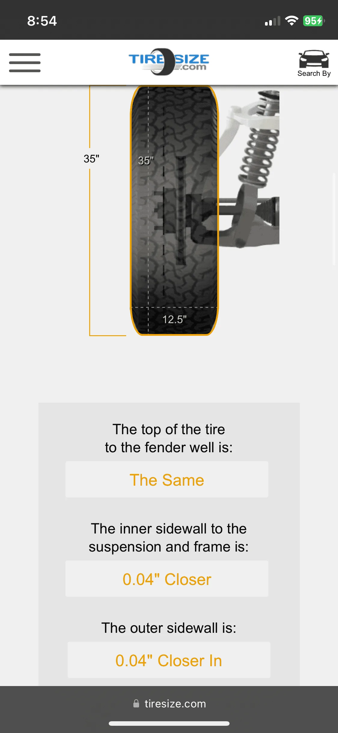

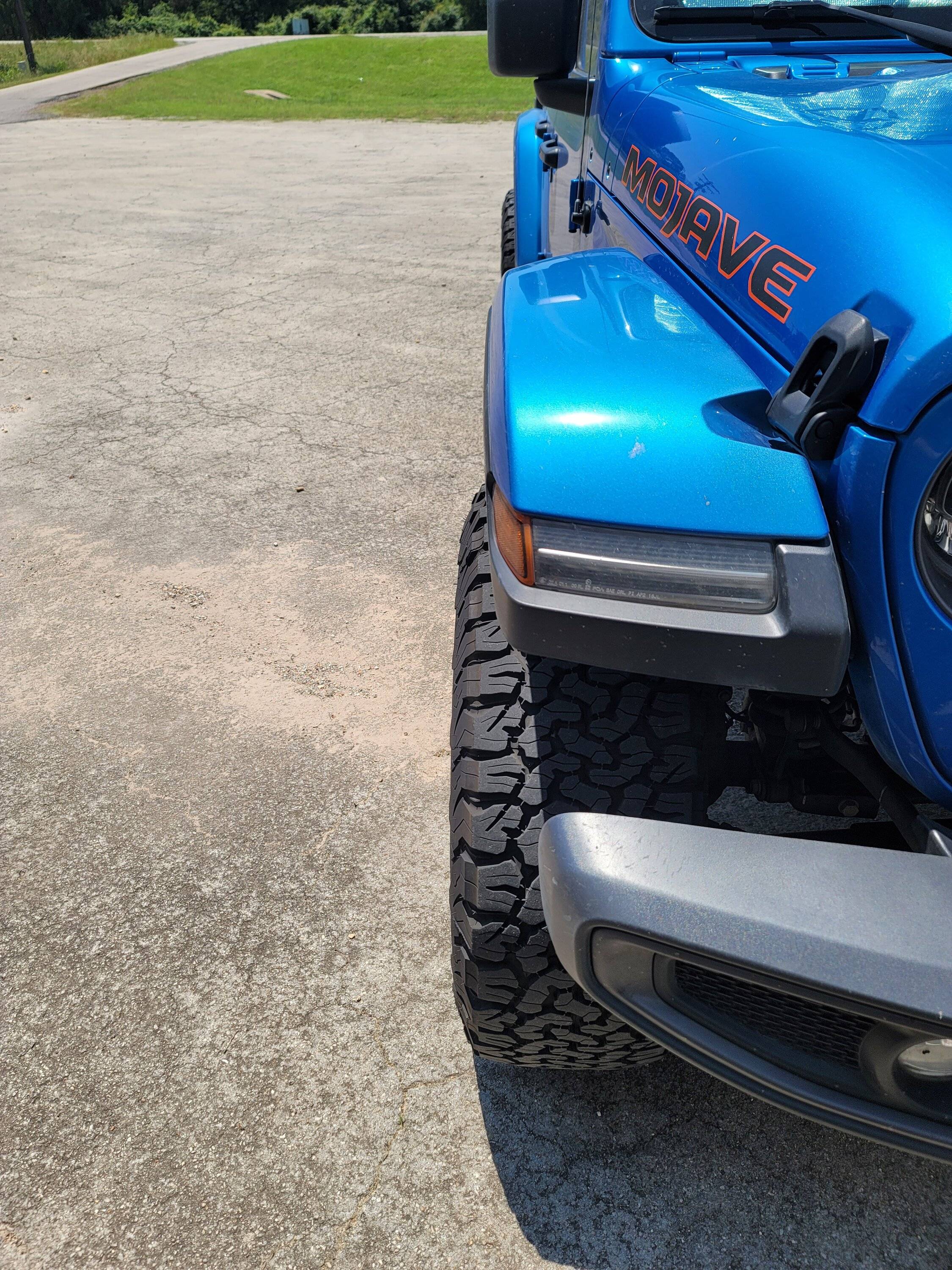

Would this be an accurate comparison for my Mojave setup with 1.5” spacers to new wheel offset same tires no spacers? Mojave wheels are offset +37?
Jeep Gladiator Wheel offset to get optimal tire poke? IMG_1962
Jeep Gladiator Wheel offset to get optimal tire poke? IMG_1963
Those numbers look about right. If your current set up is a wheel with 37mm offset (about 1.46") and 1.5" spacers .. going to the same width wheel with 0mm offset and no spacers would result in 0.04" less poke.
