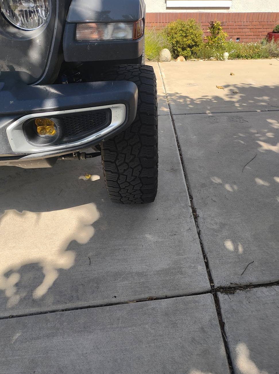

Silverator
Mar 6, 2023
439
761
NorAz
2022 JT Gladiator Rubicon
Music

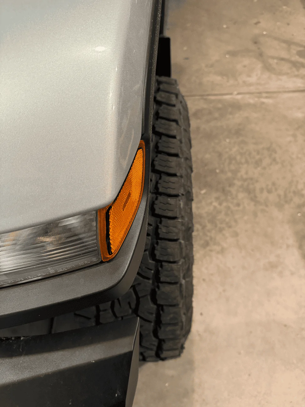

Clayton 2.5 Overland+. -12 offset Method Beadgrips. 35x11.5R17's. A little over an inch and a half of poke. With 12.5's, I'd suspect you will have another 1/2"+. Probably pushing 2". Maybe 1-3/4".
Jeep Gladiator Tire poke based on offset for Clayton lift tempImage3BKHJr
Jeep Gladiator Tire poke based on offset for Clayton lift tempImagejkix6B

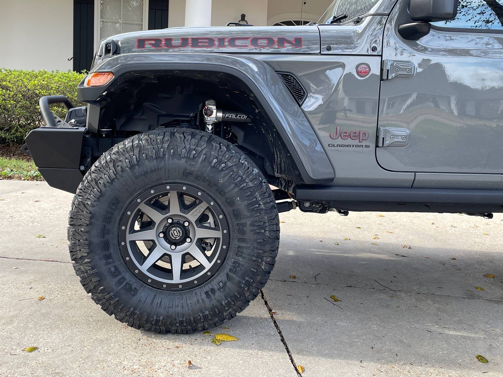

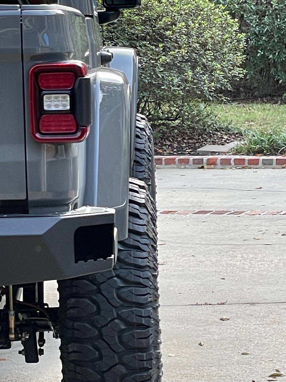

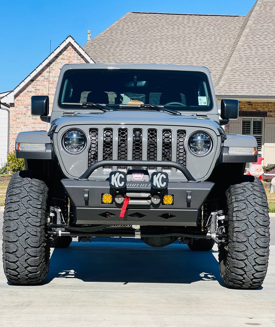

BunkieJeeper75
Conrad
Nov 29, 2021
206
166
USA
2023 Gladiator Rubicon
construction
Anyone have pictures of their JT w/ the Clayton lift and wheels with the backspacing of 4.7 or less, preferably a picture that shows the poke?
I just ordered a set of 17x9 rims from RockTrix with a -12 offset and 4.5 backspacing based on Clayton’s recommendation and want to see what I’m looking at.
I have the 3.5 overland+ lift and will be putting 37x12.50x17 tires on it.
I have the same lift and size of tires.
My wheels are icon rebound with -6 offset.
Jeep Gladiator Tire poke based on offset for Clayton lift IMG_6617
Jeep Gladiator Tire poke based on offset for Clayton lift IMG_6613
Jeep Gladiator Tire poke based on offset for Clayton lift IMG_4305

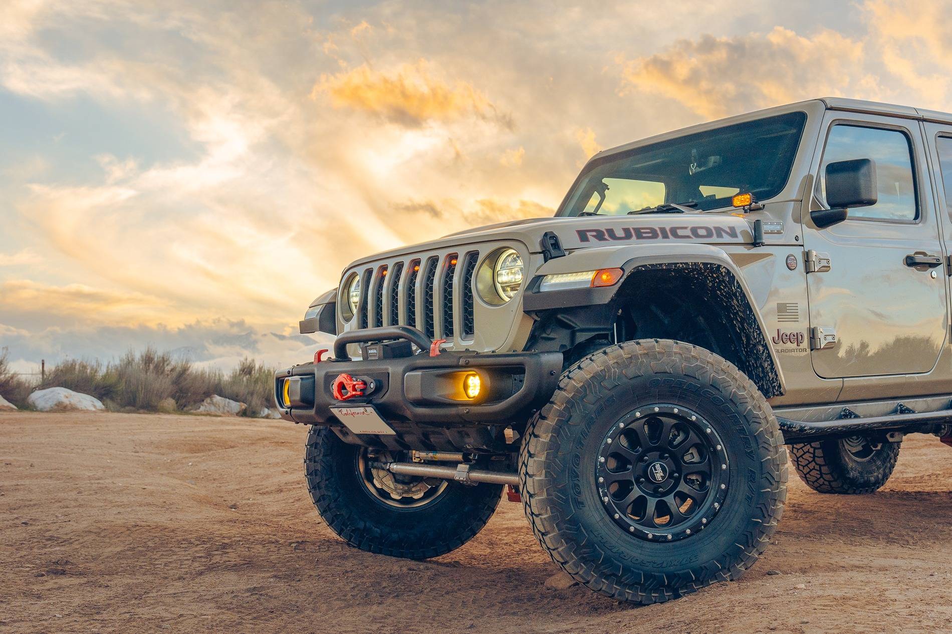

RockTrixWheels
Rock Sponsor (Level 1)
Jun 6, 2024
93
102
Chino, CA
2023 JLUR 4xe, 2018 JKR

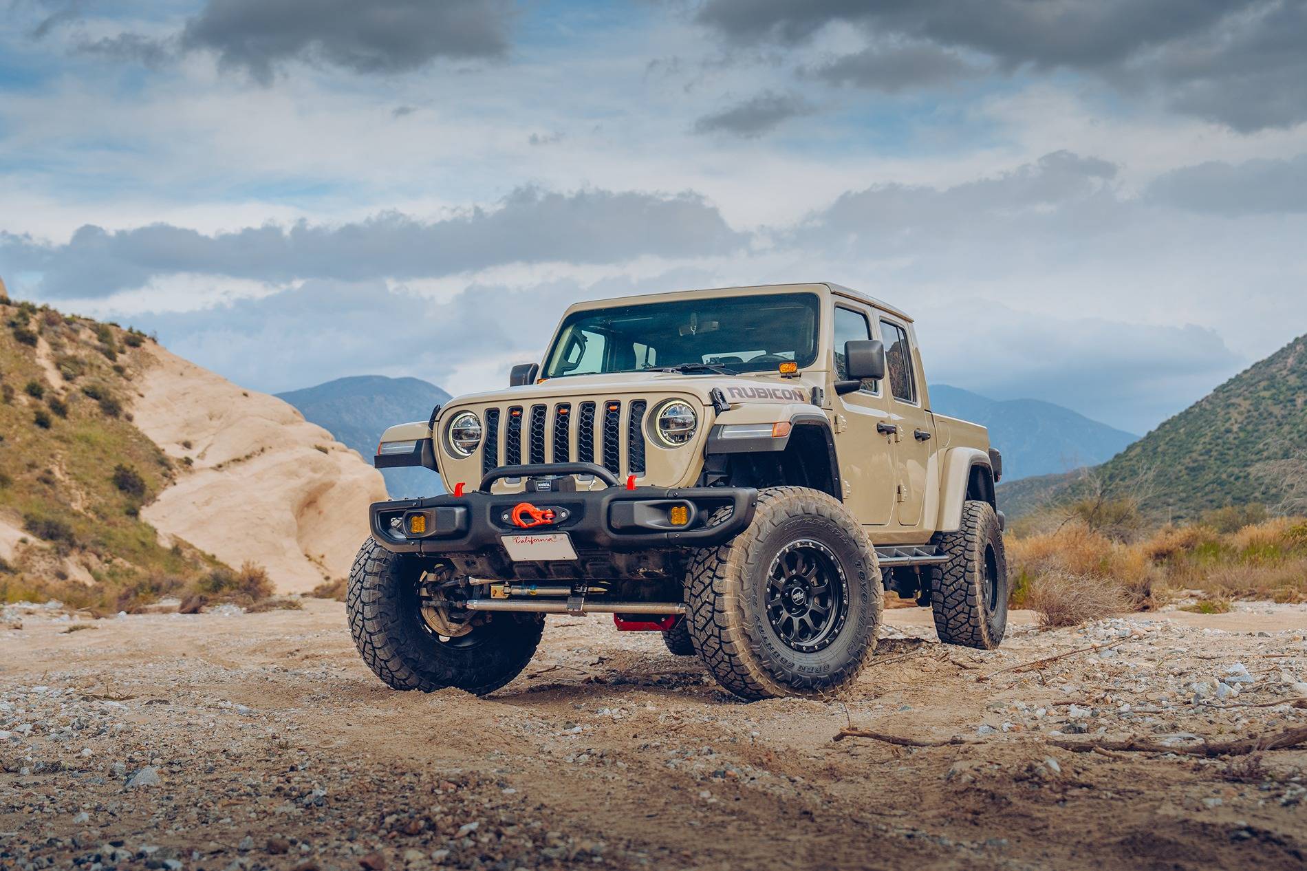

Here are so pictures we have of our customers Gladiator with the same wheel sizes that you goto 17x9 -12 with a lift and 37x12.50x17 tires. Please let us know if you have any questions or concerns with your purchase!
Jeep Gladiator Tire poke based on offset for Clayton lift 03-25-24 George JT RT111 Cajon-28

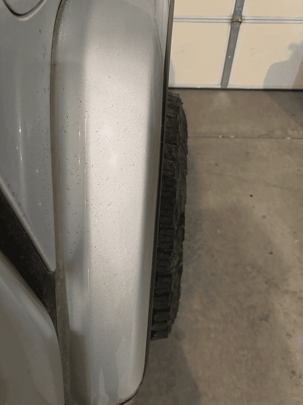

Idlethunder
David
Mar 22, 2022
762
953
Oklahoma
2022 JTR, 23 JTRD
Manufacturing

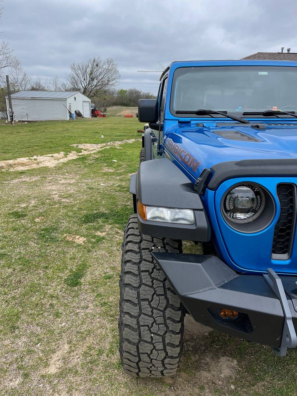

Clayton 2.5" lift, 37x12.5 Baja Boss ATs on Fuel wheels with -12 offset 4.5" backspacing. I just measured with end of tape on edge of fender. Eyeballing poke with a flashlight, it is right at 3"
Jeep Gladiator Tire poke based on offset for Clayton lift Tire poke 2
