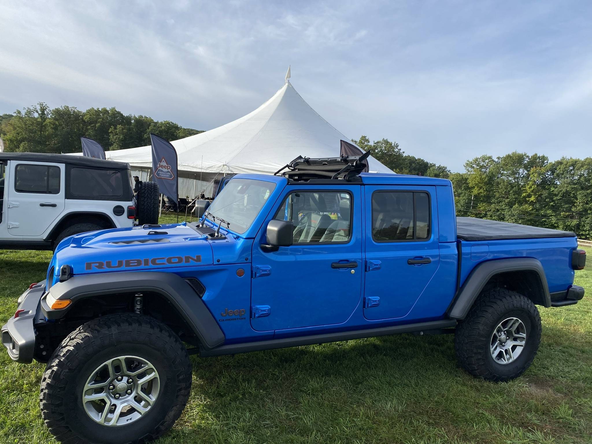

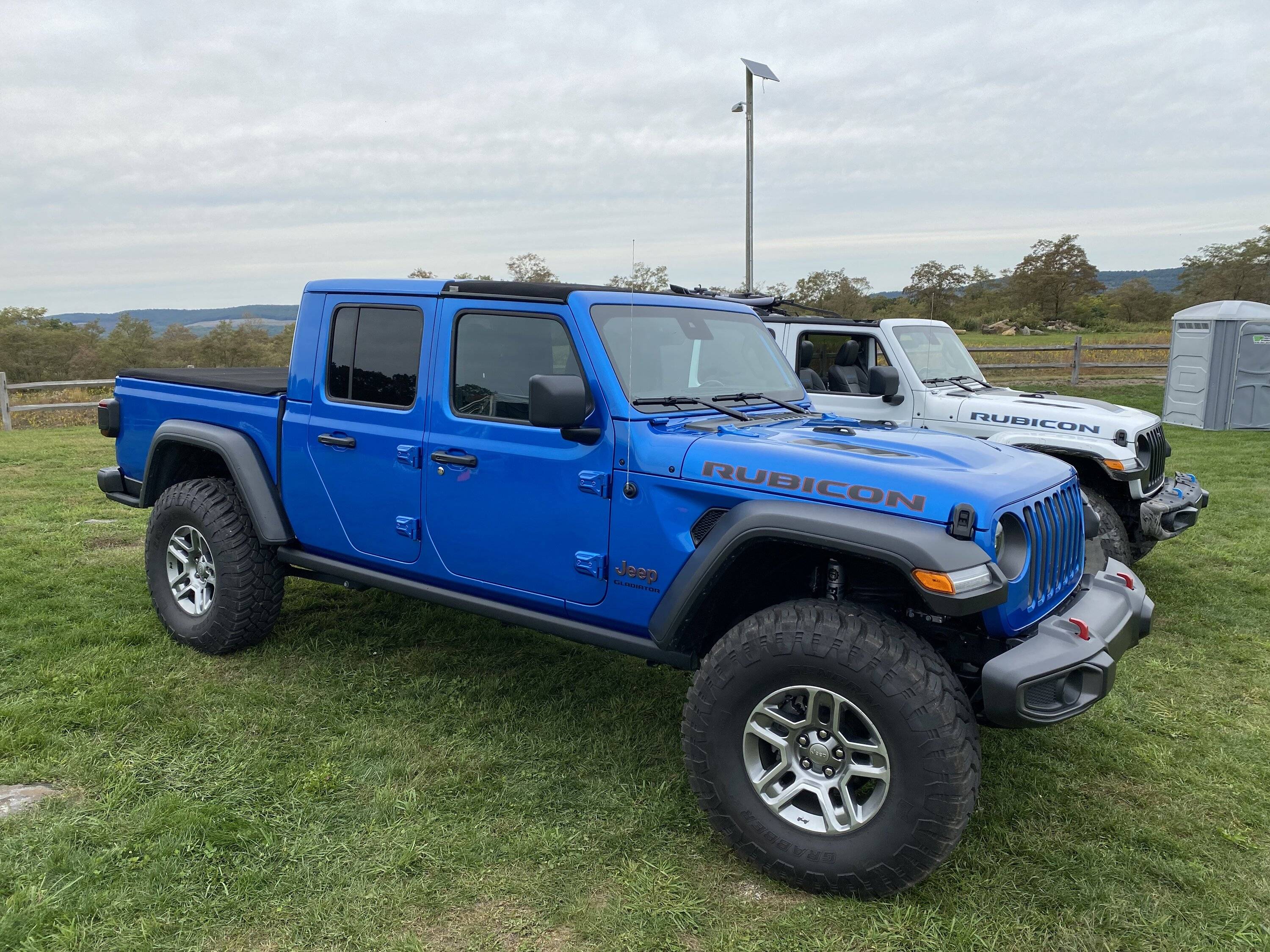

17x9 -38 on 37 trail grappler with stock fender on Mojave. Waiting for Motobilt fenders to arrive and then off to paint. Should gain a little more poke lol.
That’s a bit much for me. Looks like almost 1/2 the tread is outside the flare. If you listen enough, you can hear the faint scream of the poly wrapped balljoints!

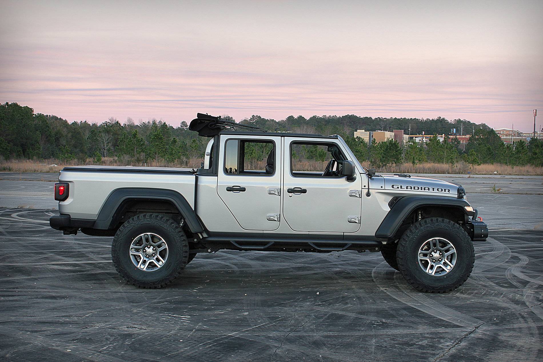

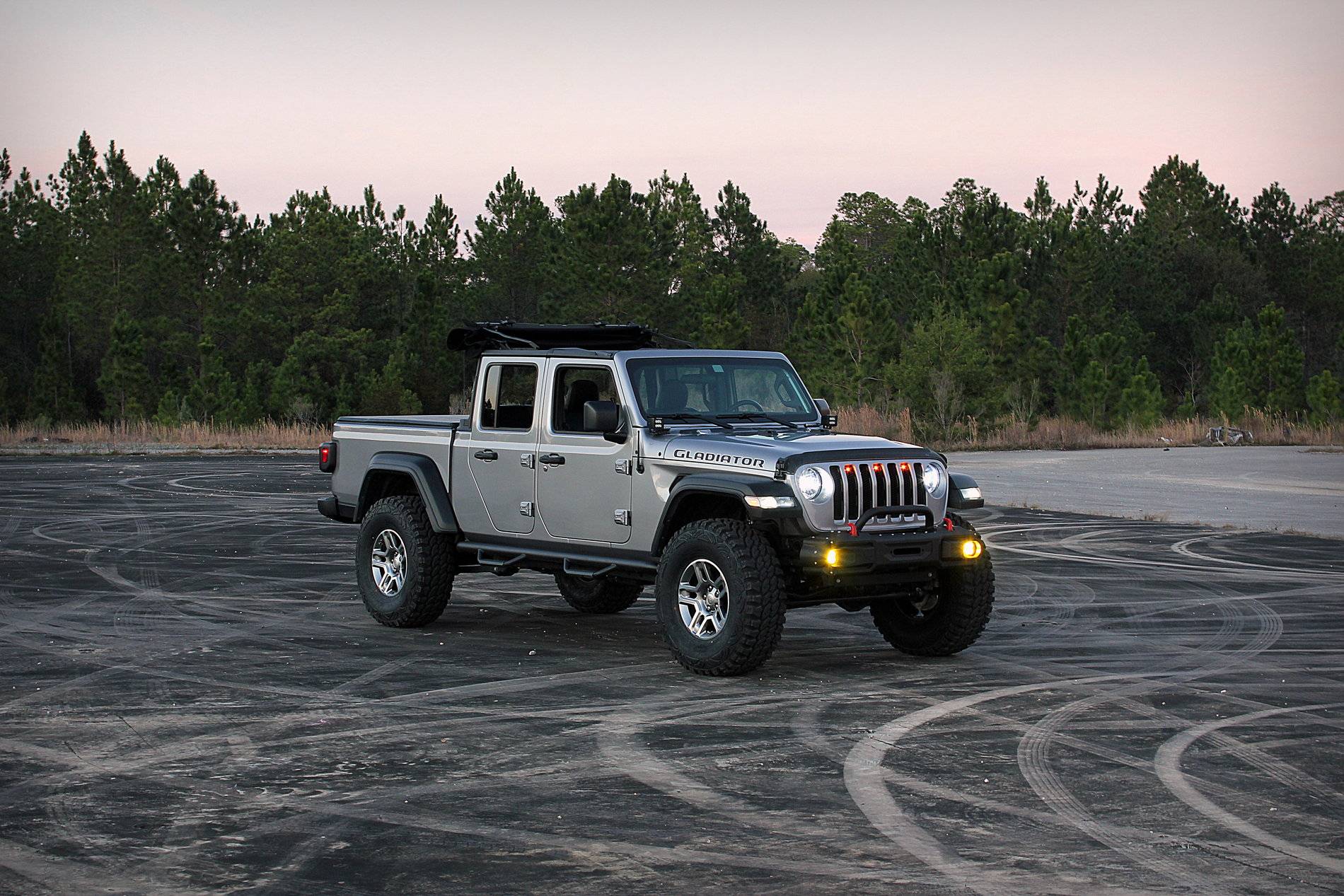

-6 with 35x12.5 on 17*8.5 on stock Mojave.
This looks good…most I’d want. 8.5” wide rim is ideal to me since it will protect the wheels while being suitable for a 12.50” wide tire.
for the other posting, below is one of the “Mopar Off-road” wheels. It’s 8.5 with a +12 offset. It’s actually +13 less than AEV wheels, which are + 25 and run both 35&37 x 12.50’s.
