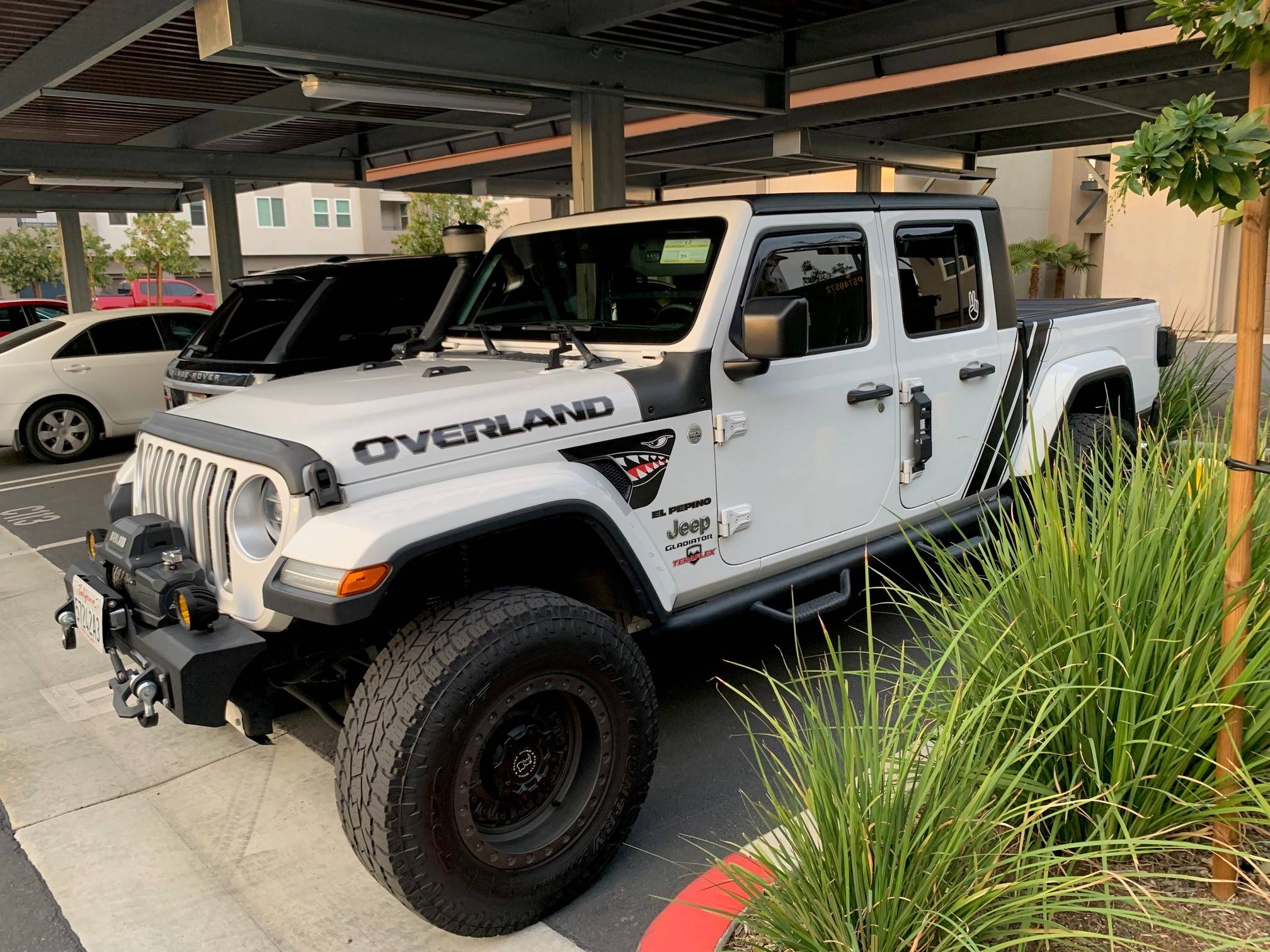

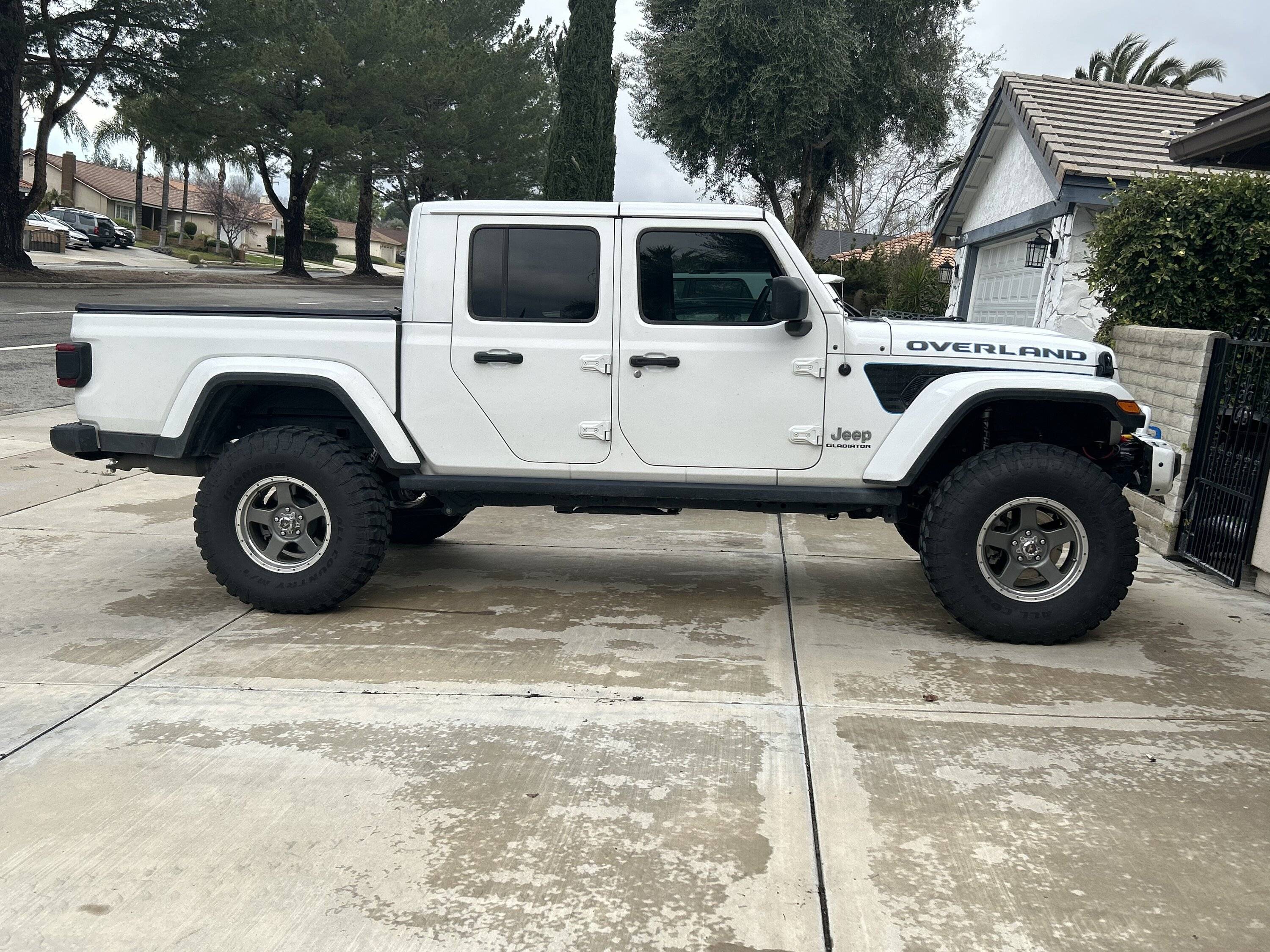

Been driving on 35s with 3.73 gearing for a few months. Mopar lift with a 1 inch puck up front to compensate for the bumper and winch. Used a Tazer to correct the speedo. Took it to Big Bear last month and it ran well. Like others said, gas mileage will take a hit but I'm okay with it since I don't take long drives (5k miles since December 2020) due to working from home. Going over two years of ownership and I'm still in love with it.

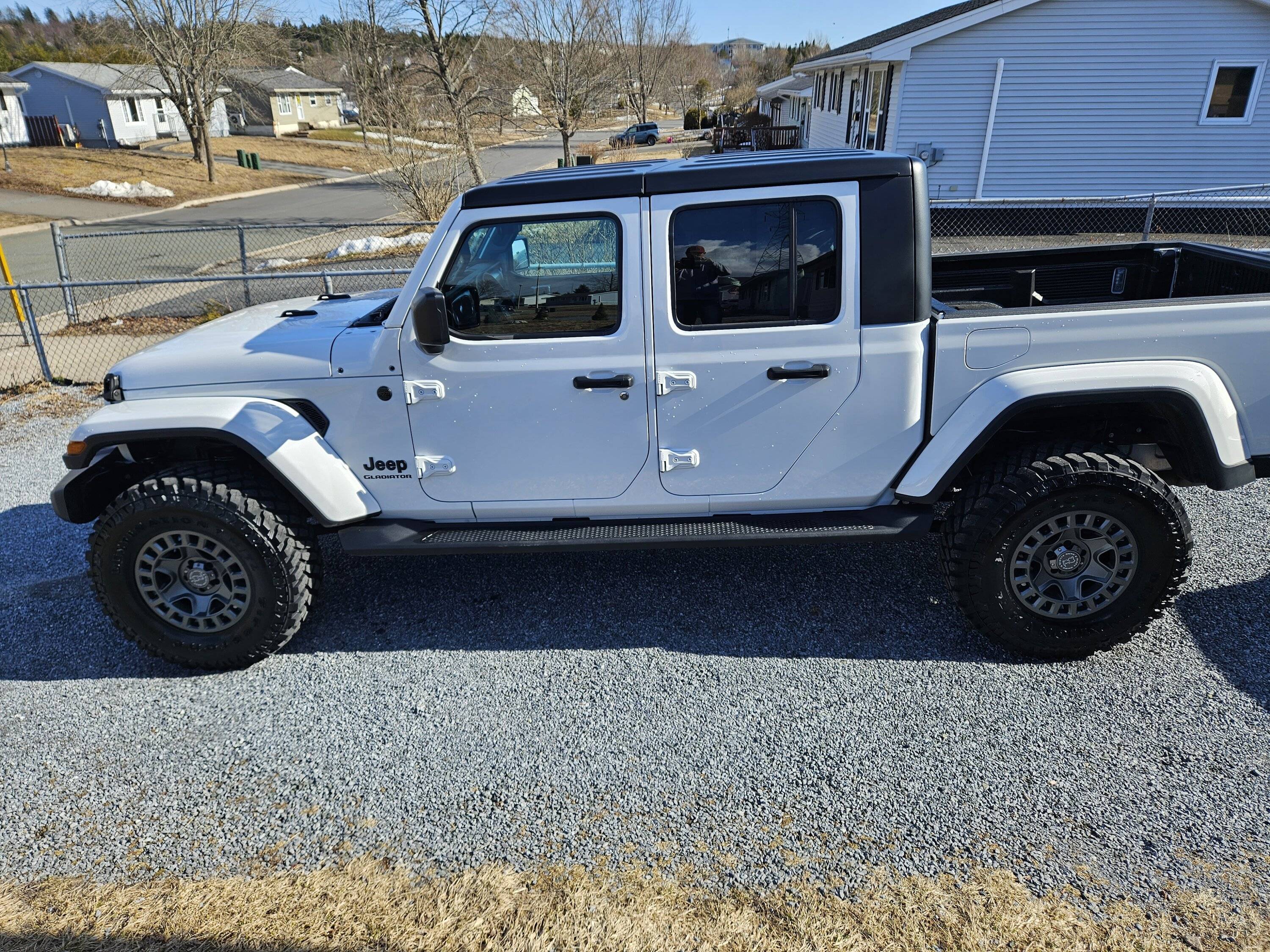

I'm running 3.73 stock gears with a 6mt no issues.
I started with 31 then 33s now 35s. not a huge difference from 33s to 35s

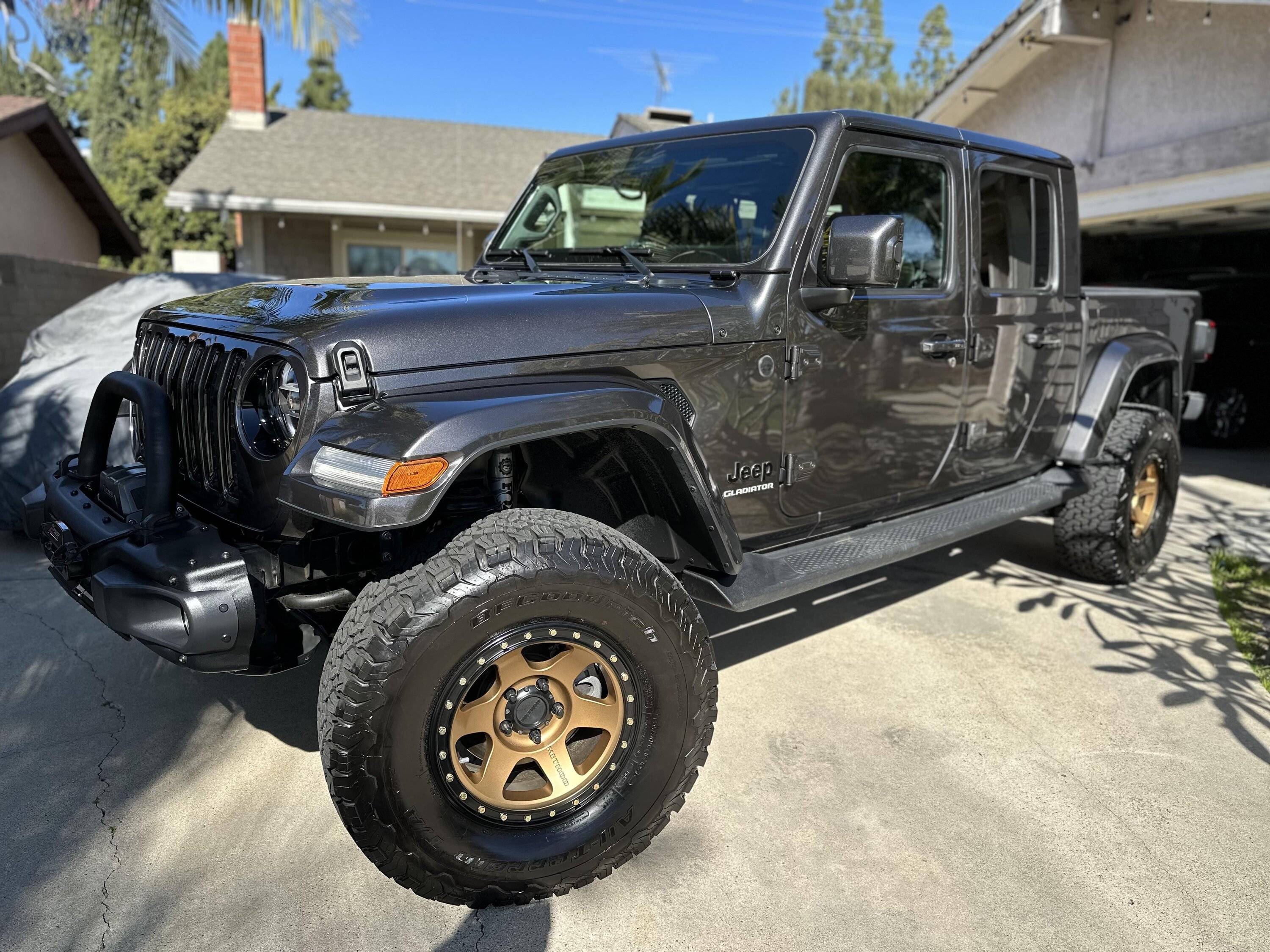

2.5" Teraflex lift with 1.5" spacer lift in the front and daystar .75" spacer lift in the back running 35x12.50R18 Toyo Open Country AT2s on Black Rhino Abram wheels. Stock Overland 3.73 gearing.

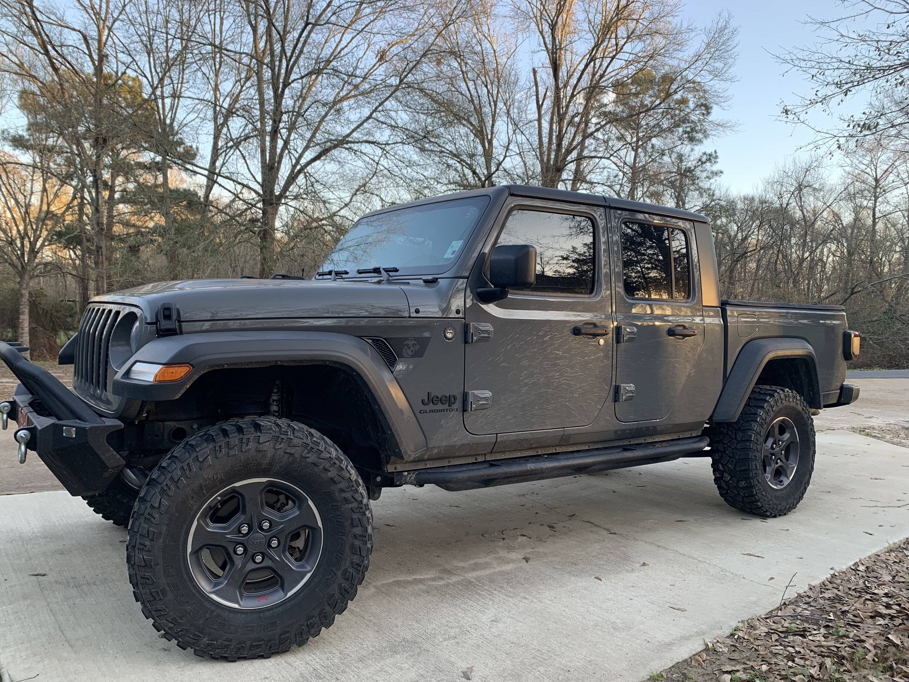

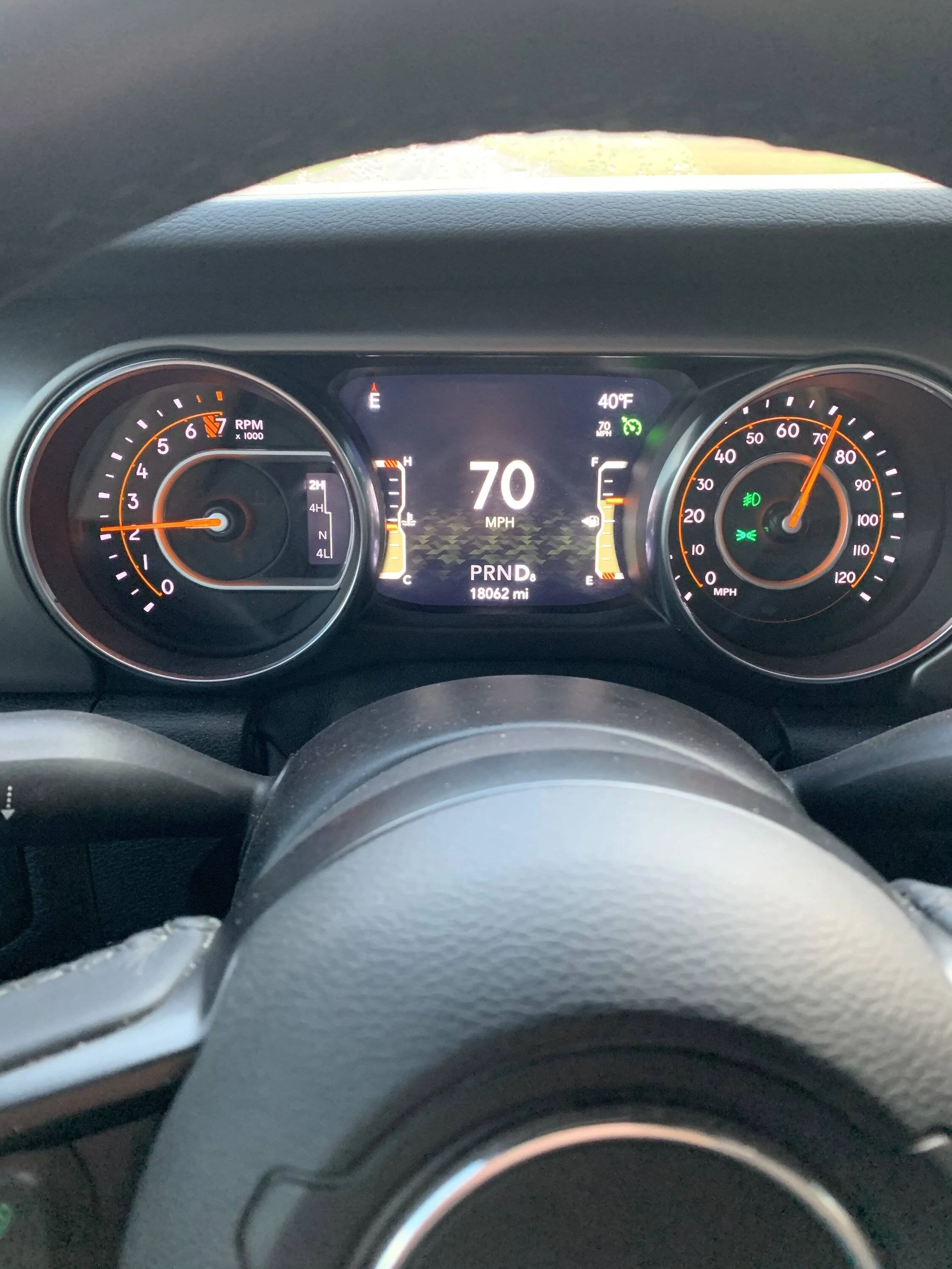

Had a 2020 Sport with Mopar lift and running 315/70 Cooper SST’s. With the 3.73 I saw 7th in perfect conditions and no wind. Never saw 8th unless coasting. 6 months later put 4.56 and would get in 8th at 45mph. It was hoot and would spin those coopers at will.
3yrs later found a deal on a Rubi and traded. I’m Planning to level it and to stay with with stock size.
I’m in La. And it’s fairly flat here and I’m enjoying seeing better than 15-16mpg
but I do miss the 4.56. This rubi in comparison feels sluggish. But I do like it.
Ive talked about my gearing quite often in the past. A quick search should pull up my post.
The rpm’s look a little more than what they were due to camera angle. Maybe 100-150 difference.
I used a JScan to resize and to change gearing as well

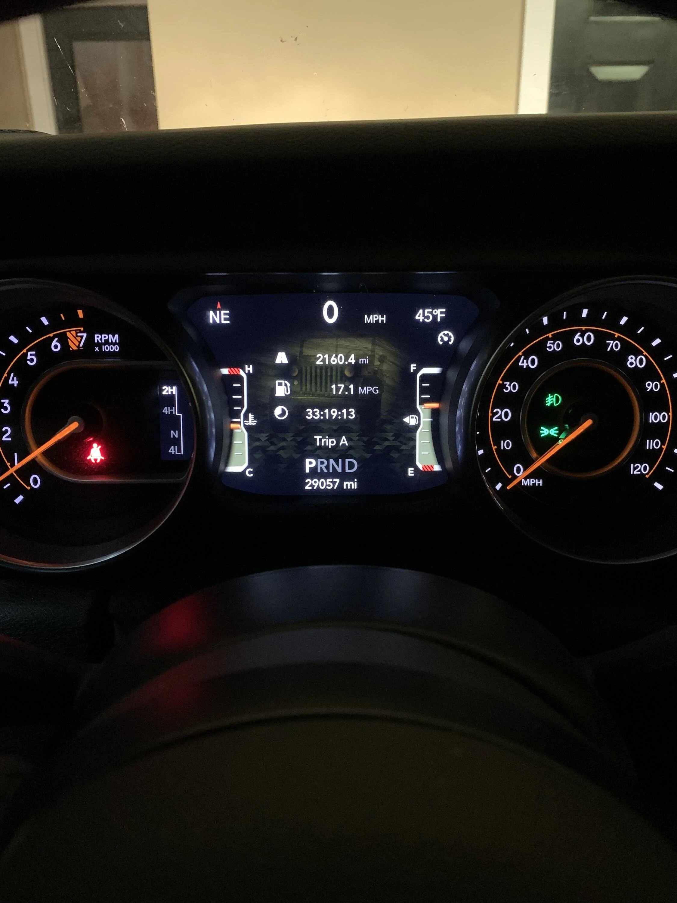

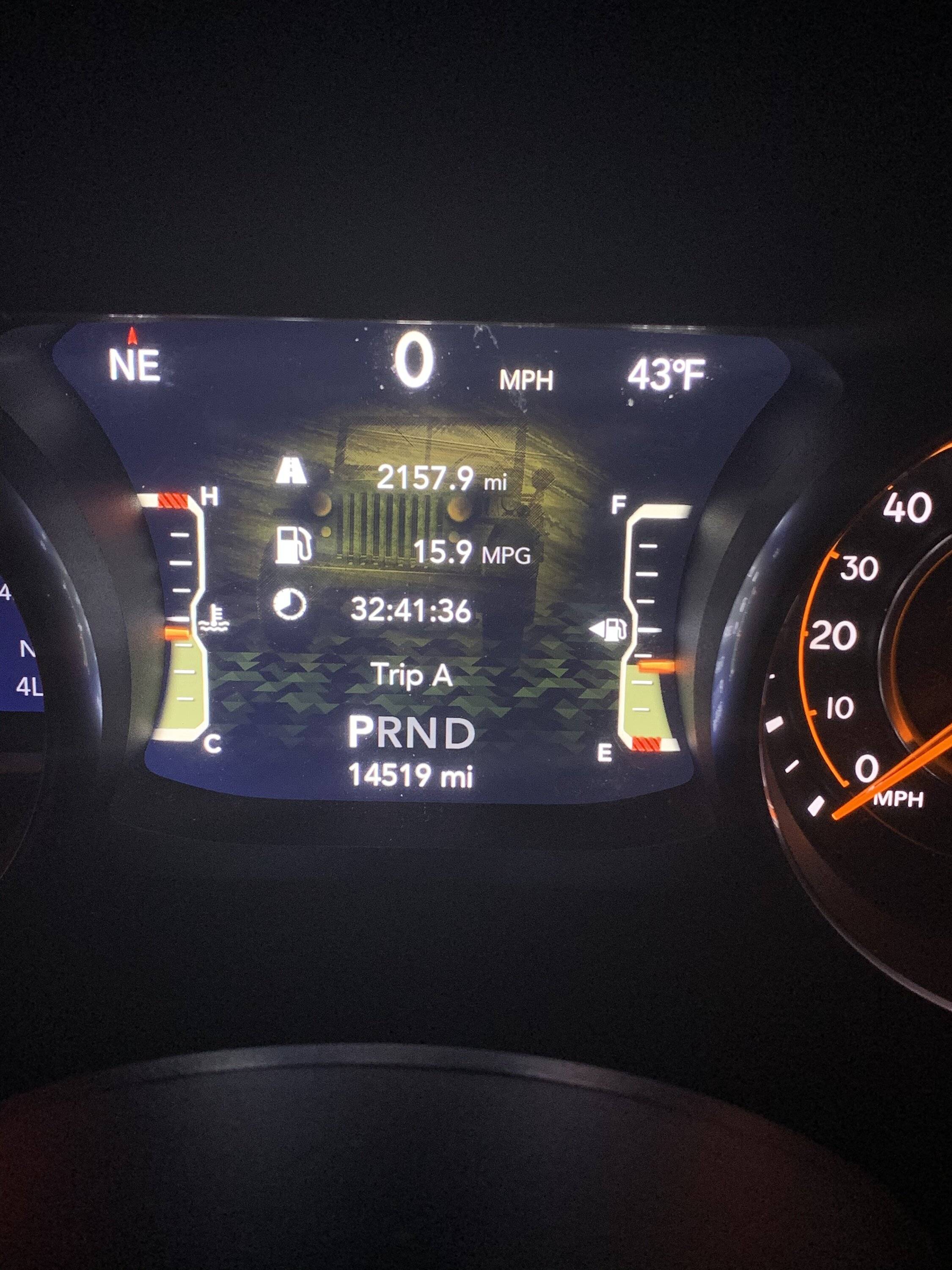

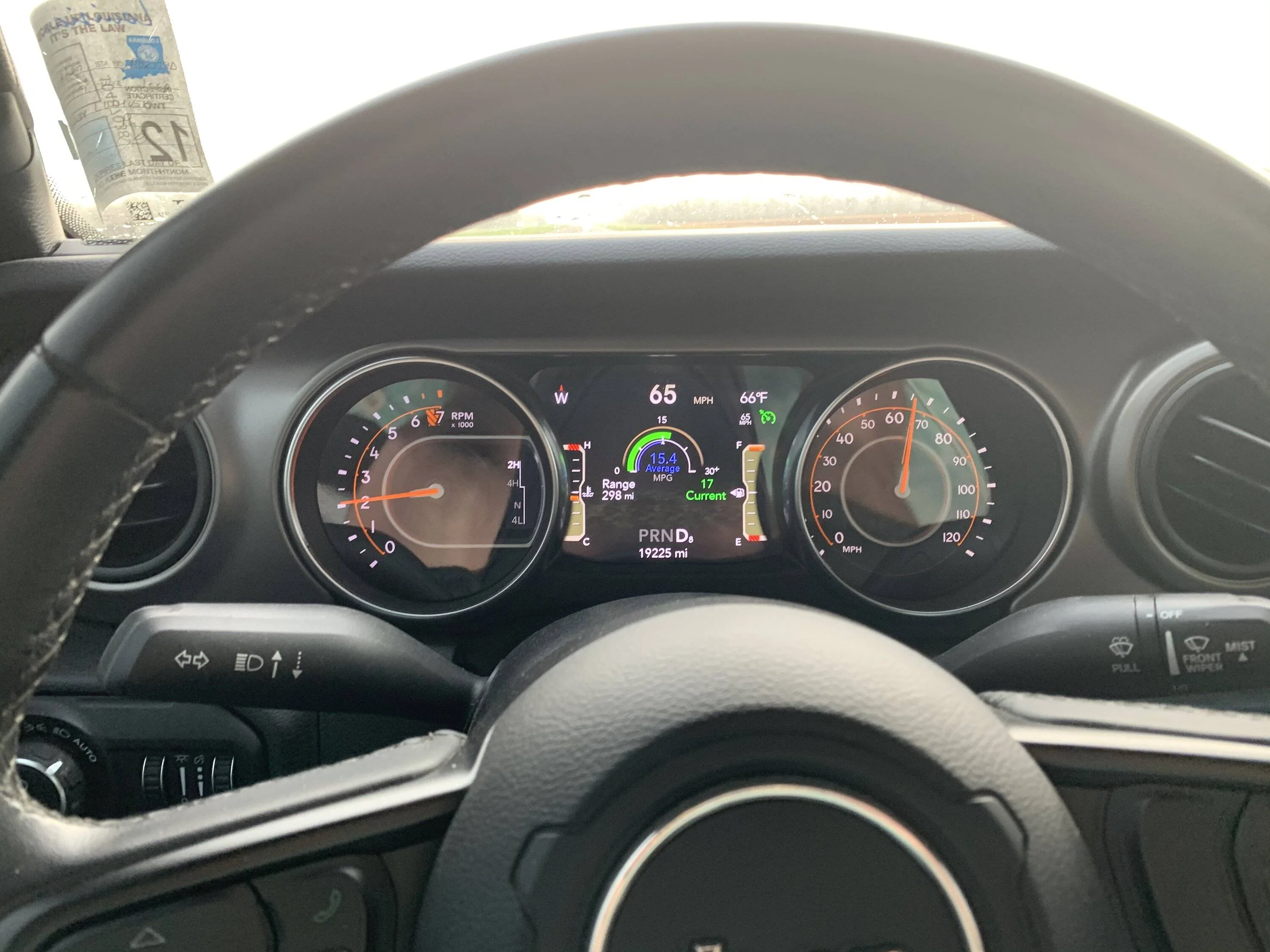

Trip to Ohio and back from La during 1st week of November one year apart. I went the same way both times.
looking at the miles they were practically the same, time wise was a little different and fuel economy well… wasn’t much I guess but there was a difference. Hell the temp was practically same and the miles on the jt were almost exactly double.
The pic with lower mpg was 315/70 with 3.73’s
the other was with 4.56
As far as towing I have a tandem 16’ with round rails and a Honda pioneer.
3.73 stayed in 5th on highway
4.56 stayed in 7th and 8th same roads
In the sport never saw Over 19mpg stock , my Rubi does better so there’s that.
I’m not saying get them or don’t. Just stating my findings.
