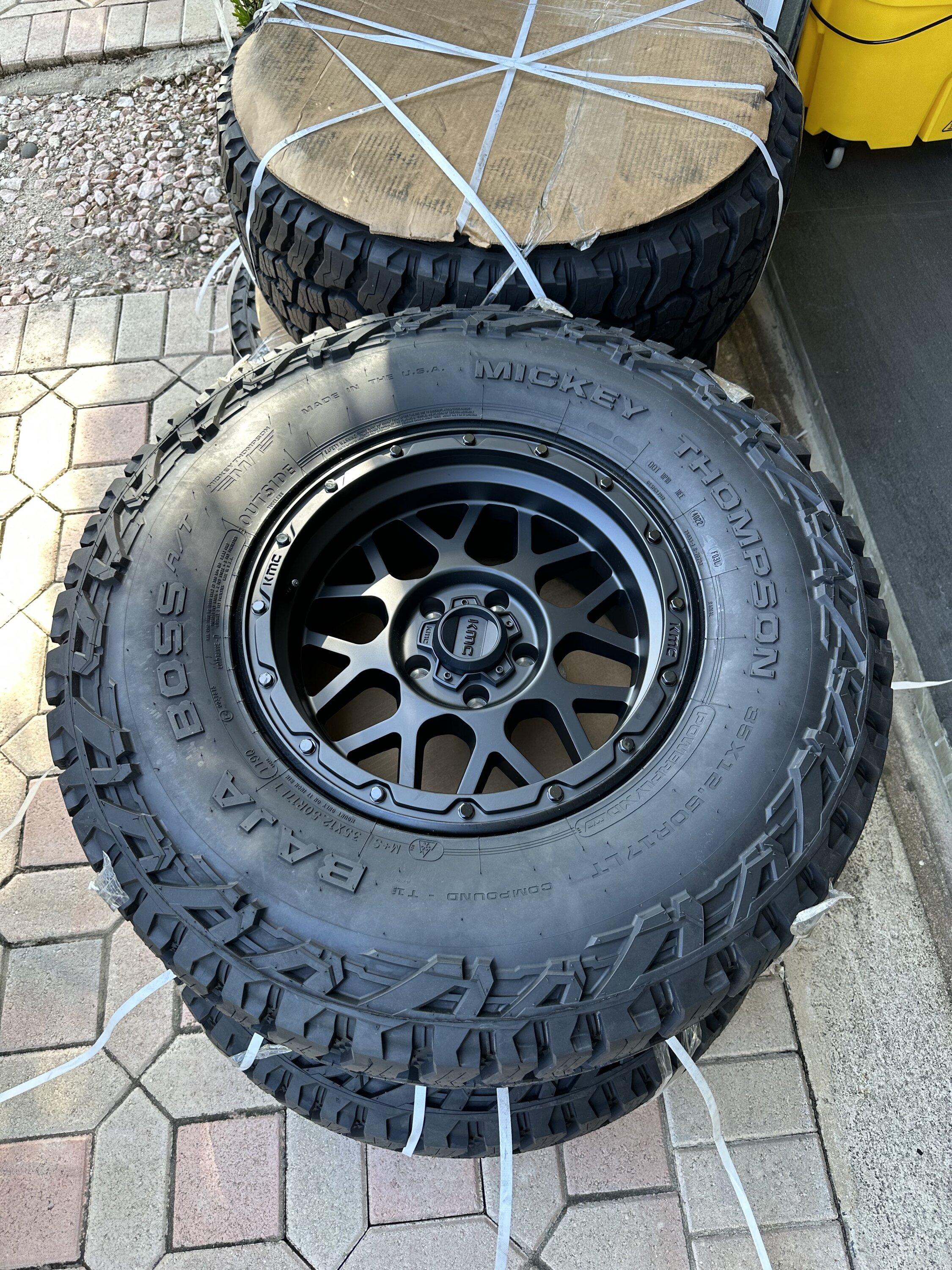

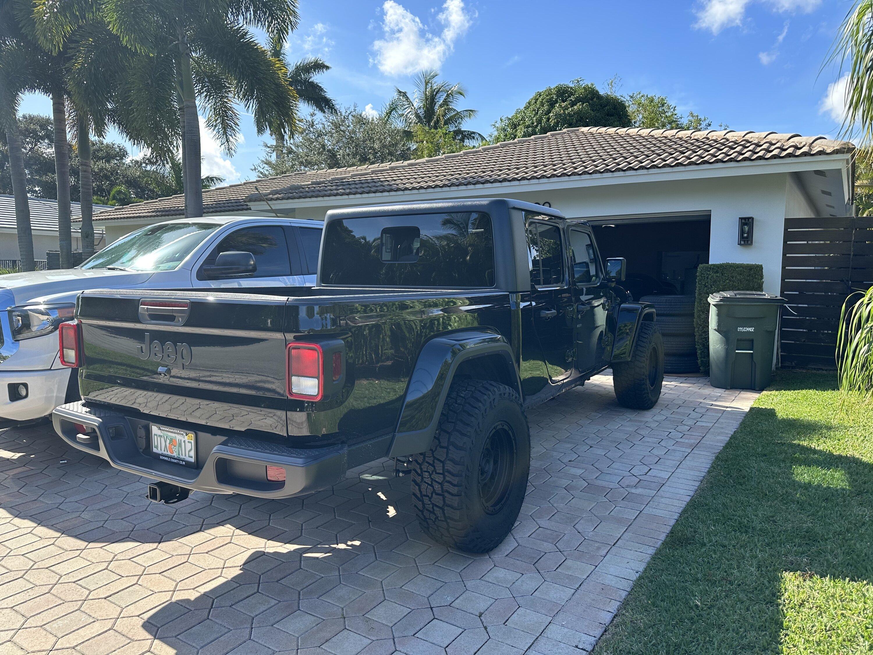

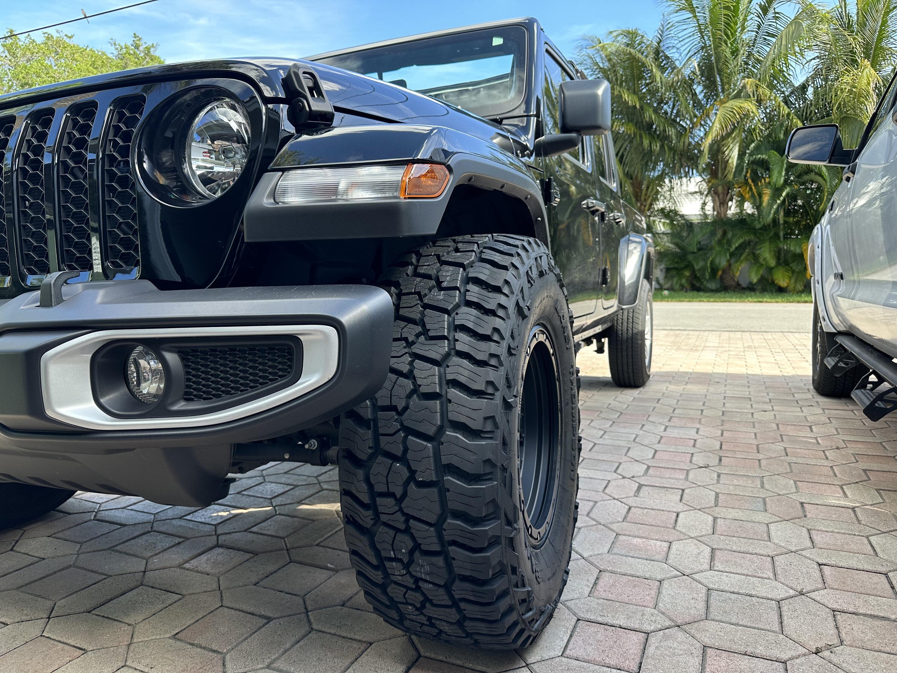

This is a question that gets asked a lot- but some answers vary. I even saw a video where a guy said he needed 2" spacers to fit 35s on his stock suspension and that was not the case with my install. I chose 17" KMC grenades with a -12 offset, paired with 12.5x35 Mickey Thompson Baja Boss.
I went with Mickey Thompson Baja Boss because reviews and testing said they were better in wet conditions and weren't terribly loud- and they live up to the expectation. Road noise is minimal for these aggressive A/Ts and they look great paired with the KMC wheels.
Jeep Gladiator Completed 35" Tires on 2022 Sport S - Stock suspension - 3.73 gears with pictures IMG_2165

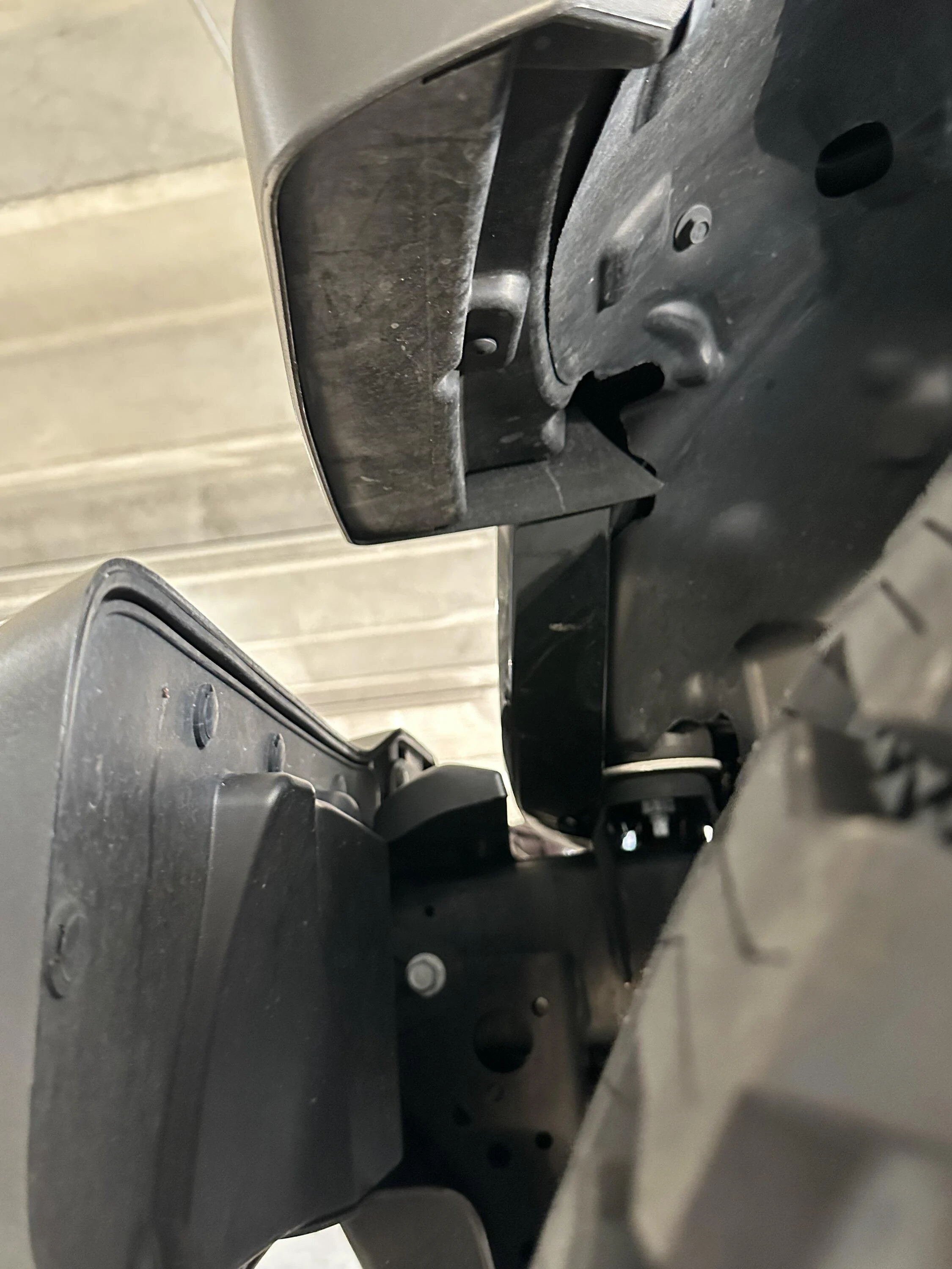

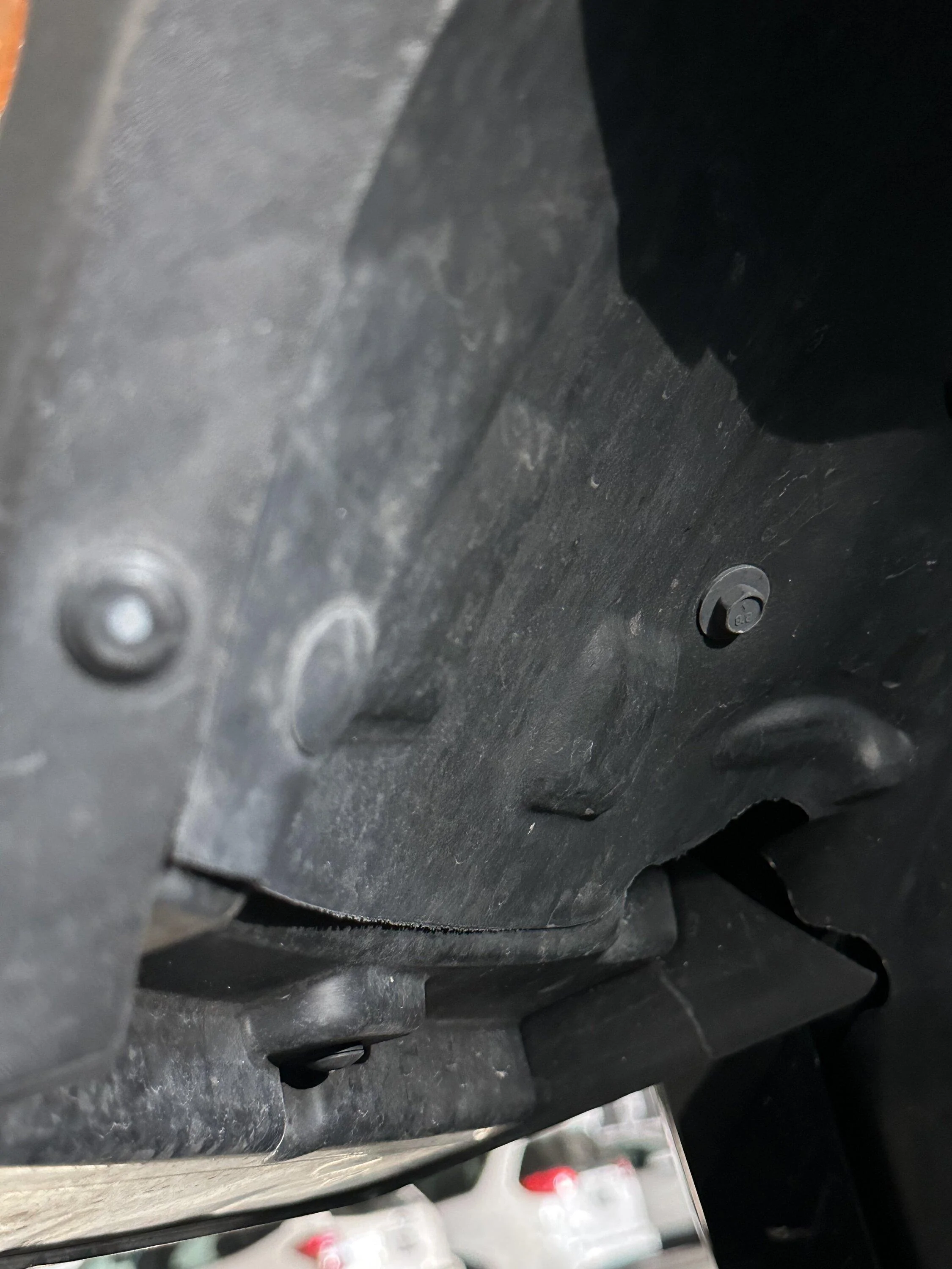

The only thing necessary for the install to prevent rubbing was the air deflector delete from the bumper to the fender.
Jeep Gladiator Completed 35" Tires on 2022 Sport S - Stock suspension - 3.73 gears with pictures IMG_2256
Jeep Gladiator Completed 35" Tires on 2022 Sport S - Stock suspension - 3.73 gears with pictures IMG_2254
Jeep Gladiator Completed 35" Tires on 2022 Sport S - Stock suspension - 3.73 gears with pictures IMG_2255

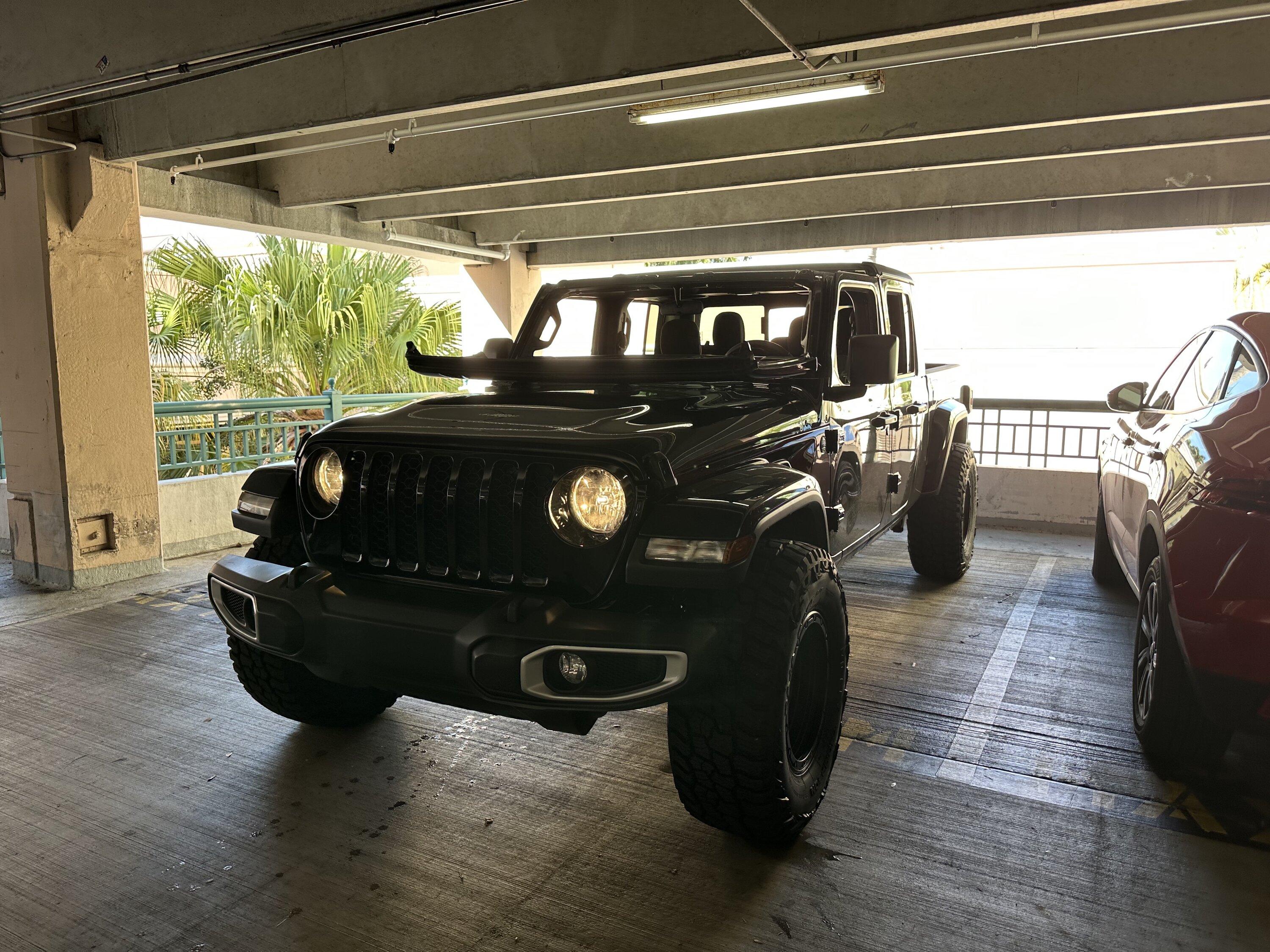

Florida is flat so I decided to go with 35s vs 33s and was primarily concerned about gear searching with my 3.73s on the sport. It's hard to beat the look of the 12.5x35 compared to the OEM pizza cutters
Jeep Gladiator Completed 35" Tires on 2022 Sport S - Stock suspension - 3.73 gears with pictures IMG_2172

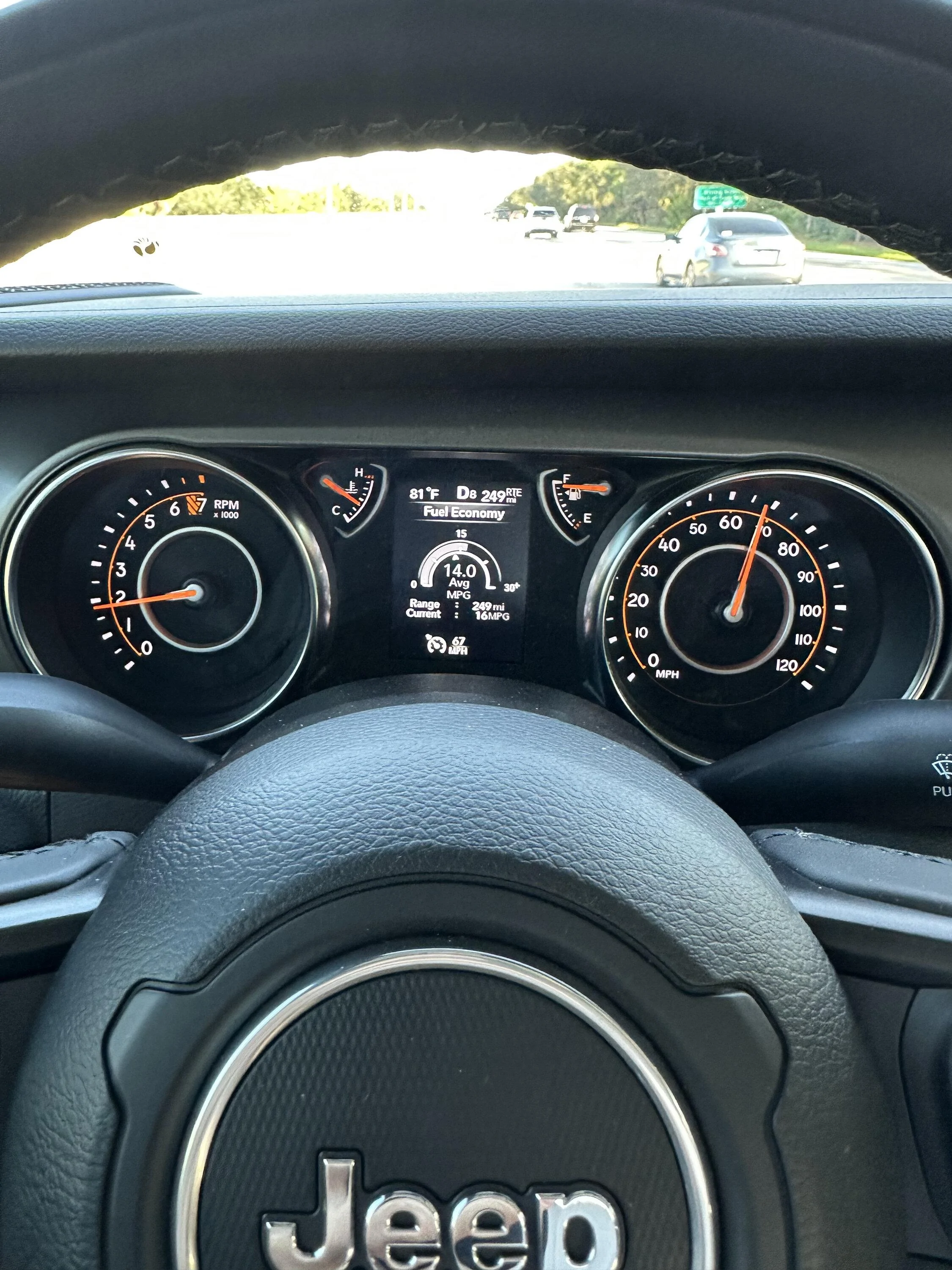

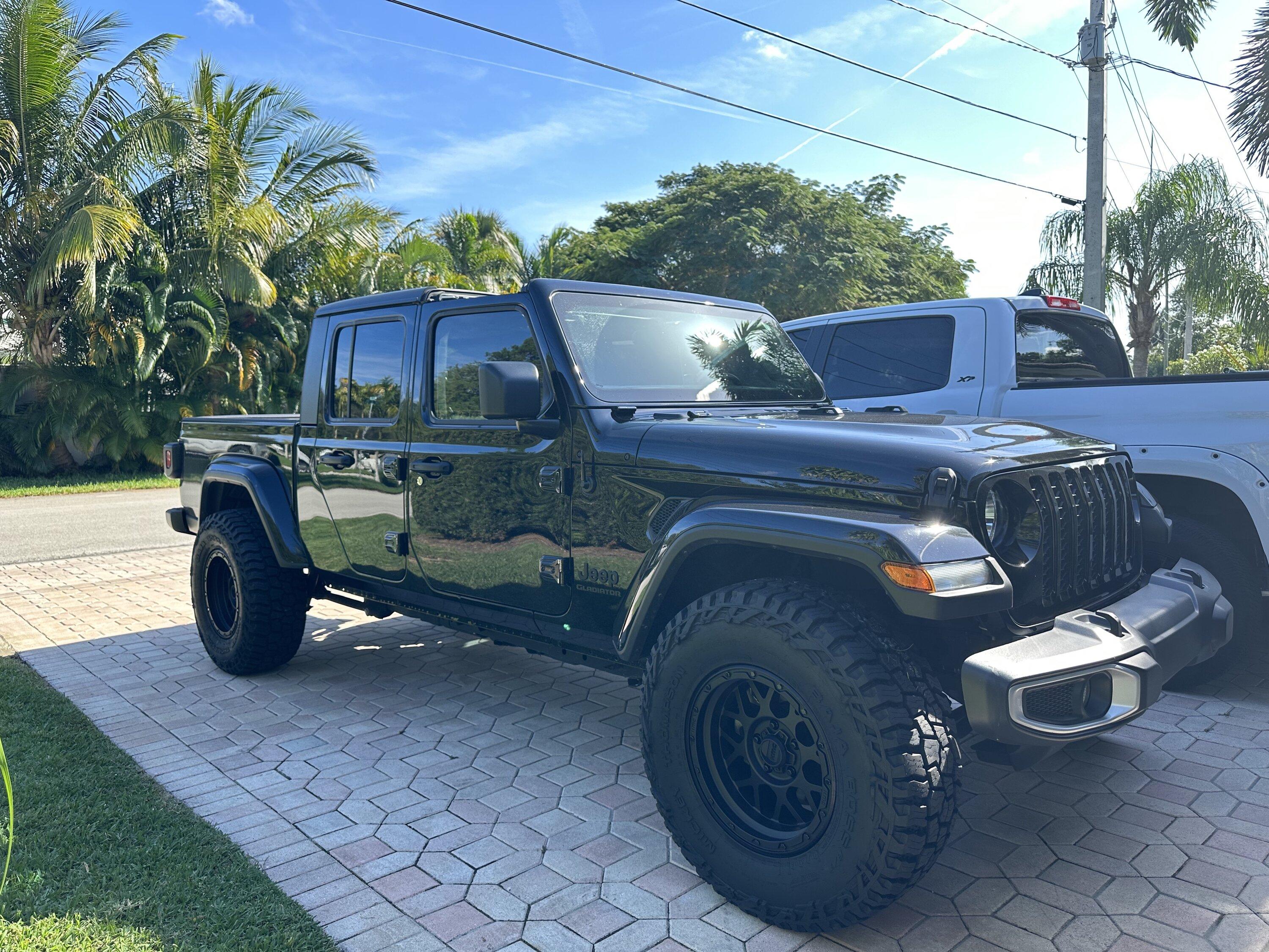

As anticipated, the 3.73 will do some gear searching on the highway-- It will hit 8th gear but will downshift to 6/7with the slightest change of elevation or wind. I am still waiting on the arrival of the Tazer mini to calibrate my system to the tire size but can already see reason to regear. My speedometer was off by 5MPH after the change.
I was averaging about 13-14 MPG with a full tank of gas at 75mph and 14-16MPG with a half tank.
Jeep Gladiator Completed 35" Tires on 2022 Sport S - Stock suspension - 3.73 gears with pictures IMG_2201

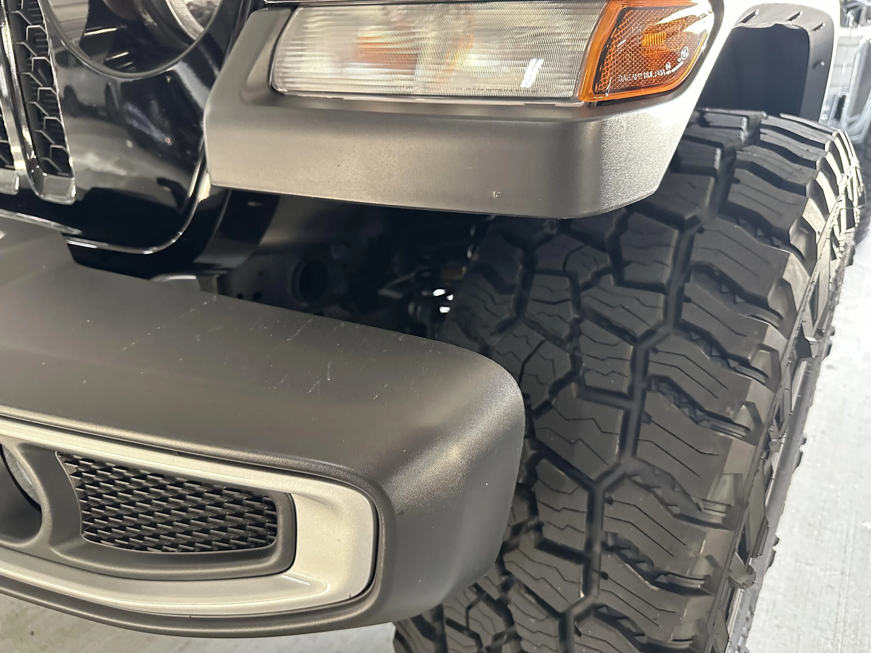

There was no need for any spacers or modifications outside of the air deflector delete.
I was able to get a full turn without any rubbing on a factory suspension. You will notice some rubbing if there is some flex to the suspension, but I was eager to put these on while I wait for my level kit and mopar lift to arrive.
So, yes this is totally doable without major modification or add-ons. Not sure if I would recommend this for someone running 3.73s living in an area with hills, the shifting would probably become annoying.

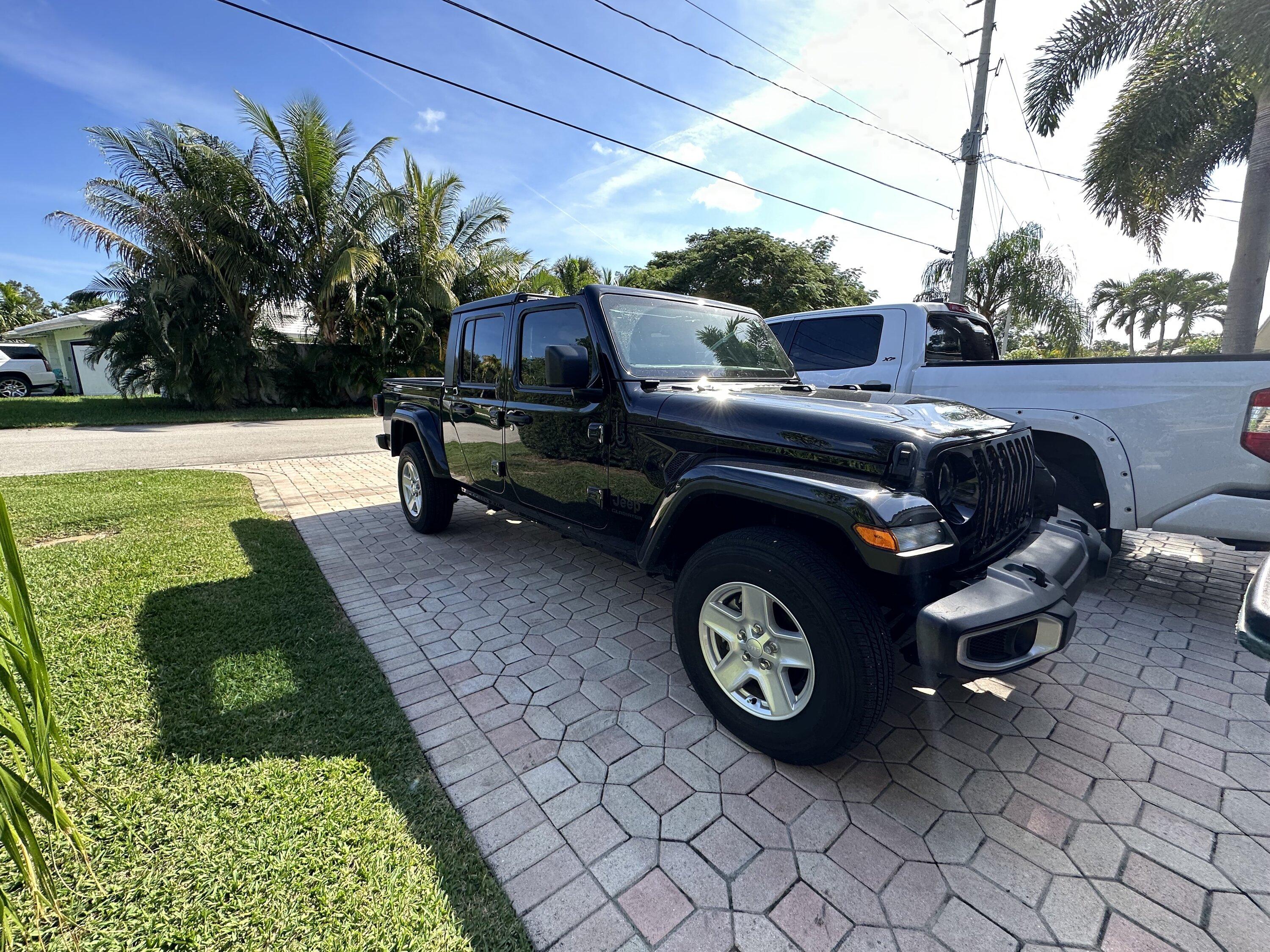

Here are some before / After
Jeep Gladiator Completed 35" Tires on 2022 Sport S - Stock suspension - 3.73 gears with pictures IMG_2163

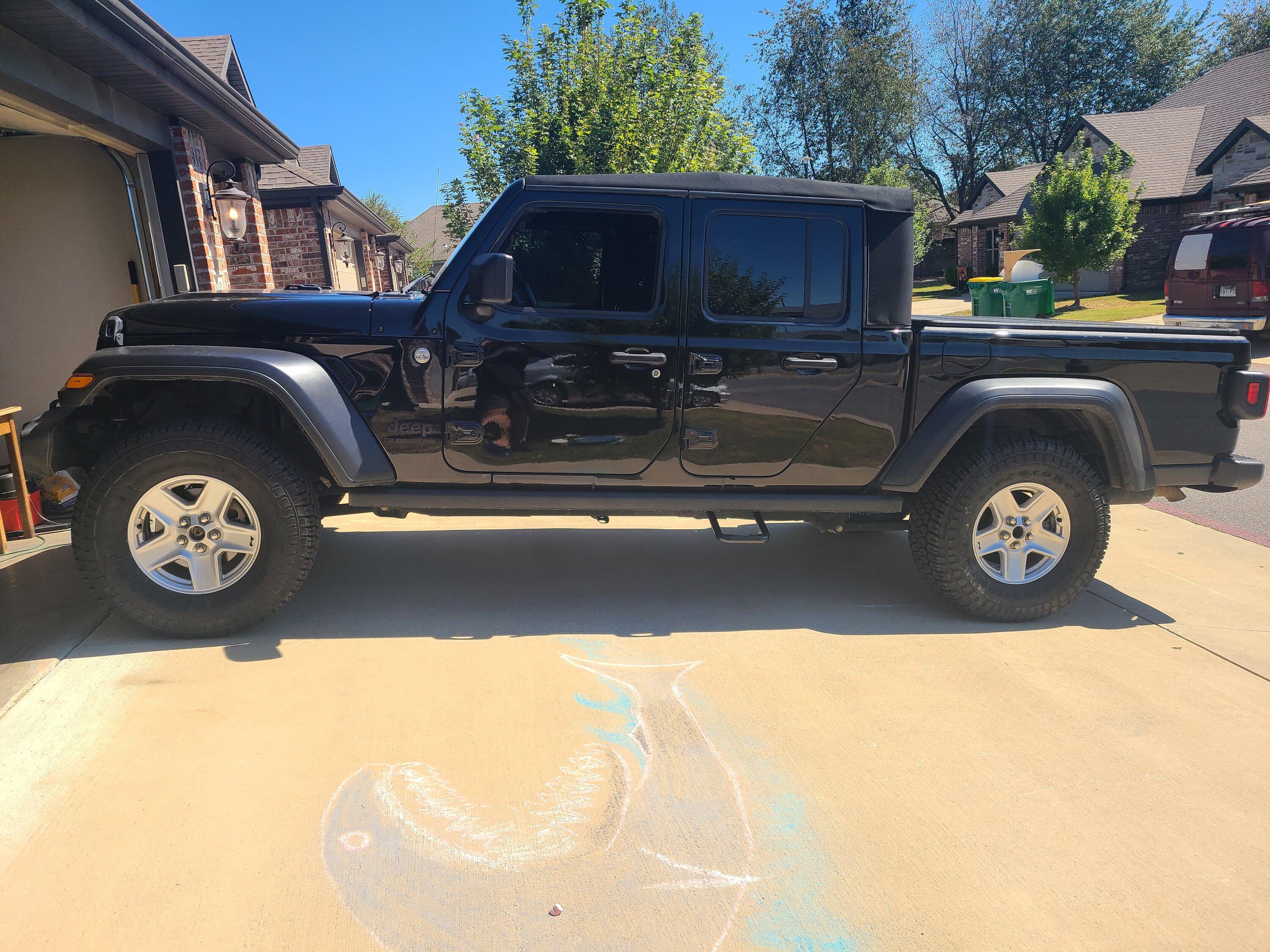

35's on a Sport S with 3:73 but manual
dcmdon
Mar 31, 2021
60
3,654
4,388
You may find that the best way to drive on the highway most of the time with those tires and that gearing is to move the AT into manual and just put it in 6th or 7th and leave it there.

First: 35s fit Stock sports. There is only the issue of backspacing that people have with the wheels they choose. Have you attempted to full lock your steering wheel to see if there is rubbing? That is the other issue people run into, normally from backspacing again.
