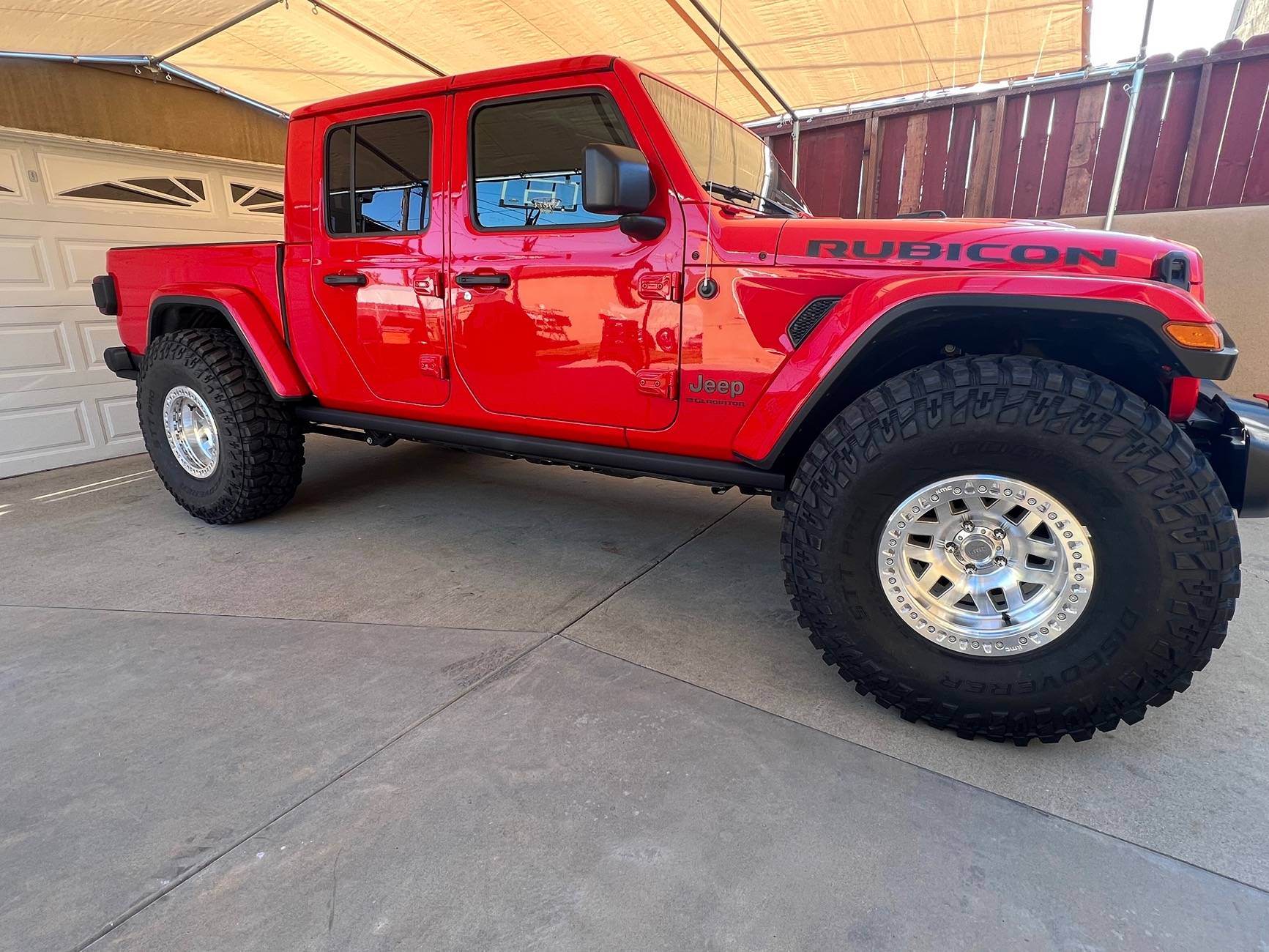

wheels didn't load. Whats the offset?

Apologies. I just updated the link on the original post. But it’s either -12 or +12. I probably like to run +12 if possible.
either of those will clear by a country mile. +30 is around the bare minimum for non wide axle JTs

You shouldn't have any problems. I ran a 2" Mopar lift on metric 35s without issue. I ran Falken 35s and -12 offset Rocktrix wheels on my JKU and no rubbing.
Now I'm running -12 offset Fuel wheels and 37" Falkens and still no issues with the JT
Thanks for the feedback! How did you like the rocktrix? How aggressive was the stance on the -12? Did you really ever have it at full flex to test (not that I imagine I ever will)? Did you have the AT4s?

thats super aggressive negative offset and MT 35s which have a noted aterisk on AEV of requiring trimming due to MTs having aggressive lugging in areas which AT tires do not
Got it, good to know! Thanks for the feedback. In your opinion, outside of looks, is there much of a difference of how a +12 versus a -12 would ride or long term wear differences?
+12 is better long term and looks better fitment wise. The more offset you add over stock the more you mess up the scrub radius which adds wear to the tire, ball joints, and wheel bearings. I run +20 on my 37s
The Rocktrix wheels are really good quality especially for the price. The finish was great too. I did go with the -12 offset since I like a little more poke.
Both my JKU and JT are strictly daily drivers. So no flex to report on.
