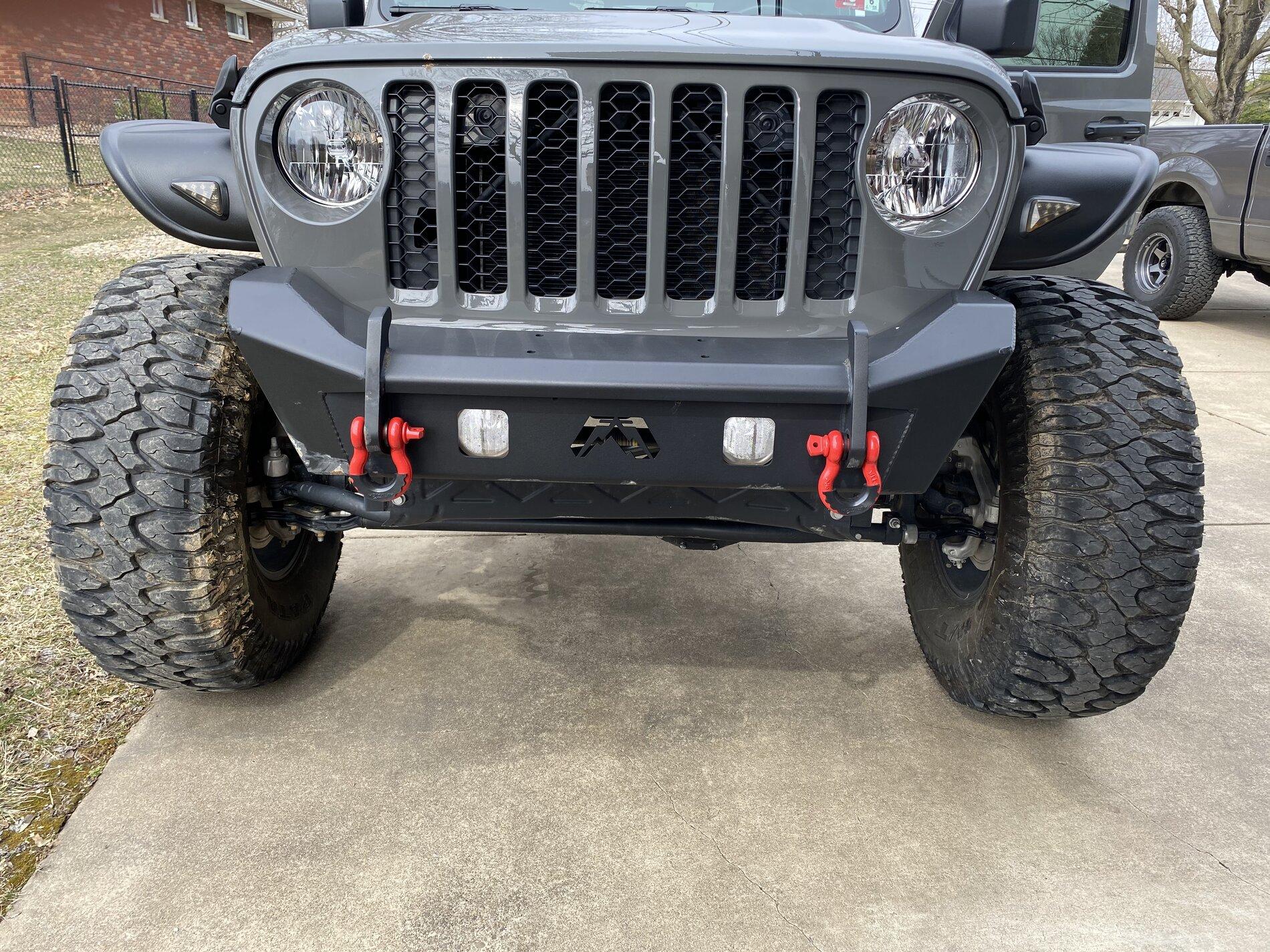

Do I need anything additional to mount this winch onto this bumper?
Badlands winch onto Fabfours bumper.
Thank you.

There is a motor controller relocation bracket in the bottom of the box, but I don't think the bolt holes would work out.

You will need somewhere to mount the fairlead.
https://www.northridge4x4.com/part/...er-front-bumper-fairlead-mount-black-textured
I just installed this winch last week and do NOT remember seeing anywhere to mount it on the winch.
Other than that, everything is in the box.
Now for the bad news, probably going to have to take the bumper off, mount the winch, then reinstall everything at once.
Ok. So that bracket will go in front of the winch and share the same holes that the winch uses?
kevman65
Mar 8, 2020
52
3,876
5,751
H
J
The side of the plate with four holes goes on winch plate on bumper, set winch on top and bolt through bottom of winch, through the fairlead bracket, into the nuts in the winch.
Your fairlead housing will bolt to front of fairlead bracket.

Oh, not recommending the plate I put up, it's just an example.
Thank you. I really appreciate the help!
