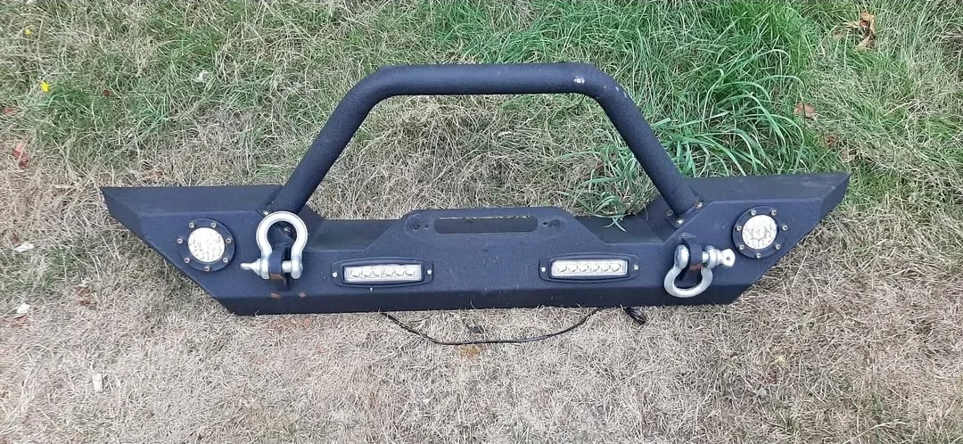

  2. Locally, I have someone selling this one for $300 Canadian, from the looks of it, it doesn't look very nice, but not sure? 🤔
    Jeep Gladiator Winch mounting question 1000025816
So, I was wondering the following:
  1. is the aforementioned winch plate good enough? Or should I consider a different brand? Keep in mind that I'm planning on installing a 10k lbs winch
  2. What do you think of the used steel bumper?

I am leaning that way as well, I also like the look of the OEM one more
I personally would go with this winch plate. I actually am using this one currenly. Its priced well and most importantly its American made. The Vevor is made in China.
https://barnes4wd.com/products/jeep...B24Q8dL32YTefe5Lm6t6KHeriSeIiEOPB-01HLXeFRVnZ
Thank you very much for the suggestion, but I live in Canada, and it's easier and cheaper for me to get the Chinese made ones than the US made ones into Canada. And this one seems to need powder coating, which adds to the cost.
Both this one and the Vevor are made from 6mm thick steel. So seems a no brainer to go with the Vevor one
