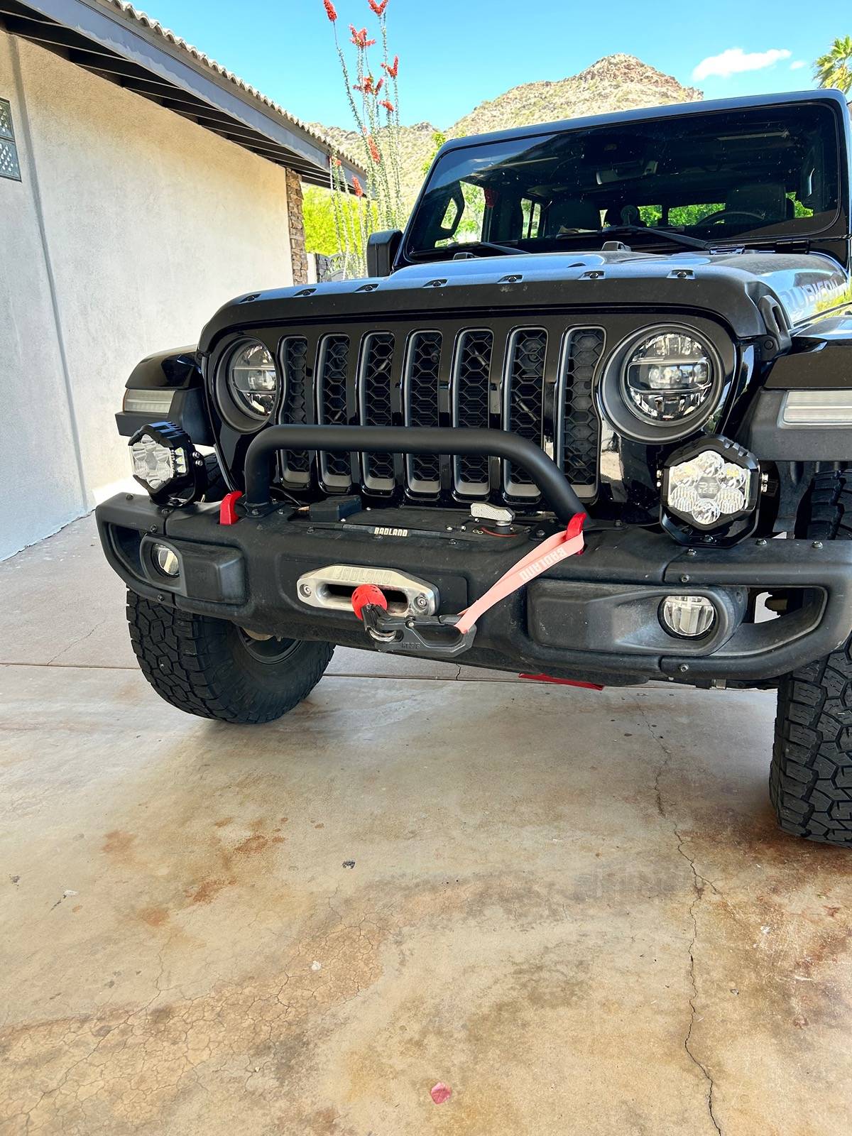

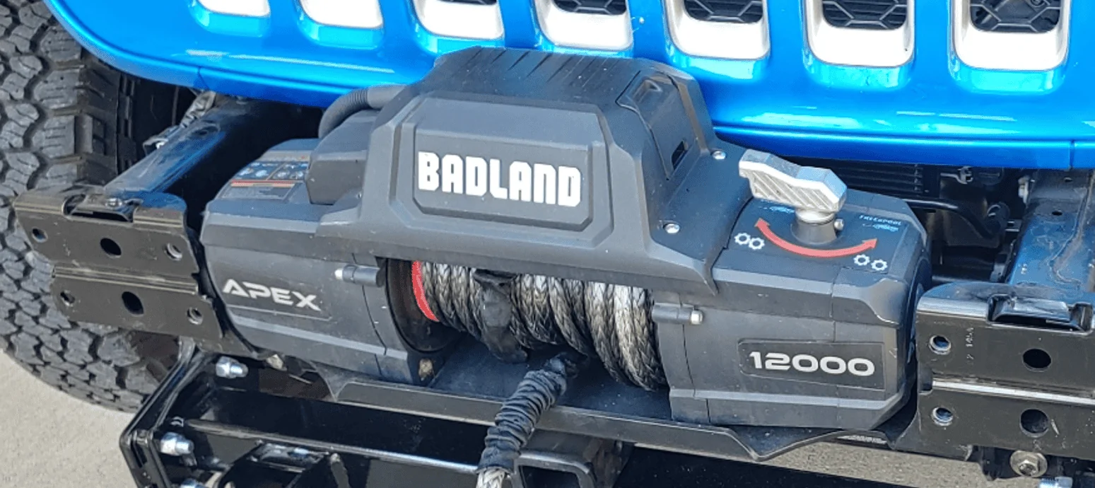

Love my bulldog winch plate. It's heavy/beefy and has support notched in and welded to the bottom of the plate. It sits behind the bumper mounting flange so doesn't interfere with bumper mounting at all. It's an easy install.
Thanks Shadow. I was looking at this one and saw one of the reviews saying they didn’t recommend it with the badlands 12k. Obviously it’s what you’re running from the picture so just curios on your thoughts. It does look well built and easy to install and I’m cool with that price point.

It does make the winch I have sit lower than a cheapy plate I used before. So I had to notch the clutch release lever a bit more.
Ideally, you'd space the winch up a little bit.
And if I trade or decide to "re-do" any of this, I will do just that, space the winch up maybe 3/16" up. It would also center the rope a bit better in the bumper opening.
That's the only things I can think of - might want to space the winch up a tad. Otherwise, it makes the winch sit fine with the grill and all other aspects.

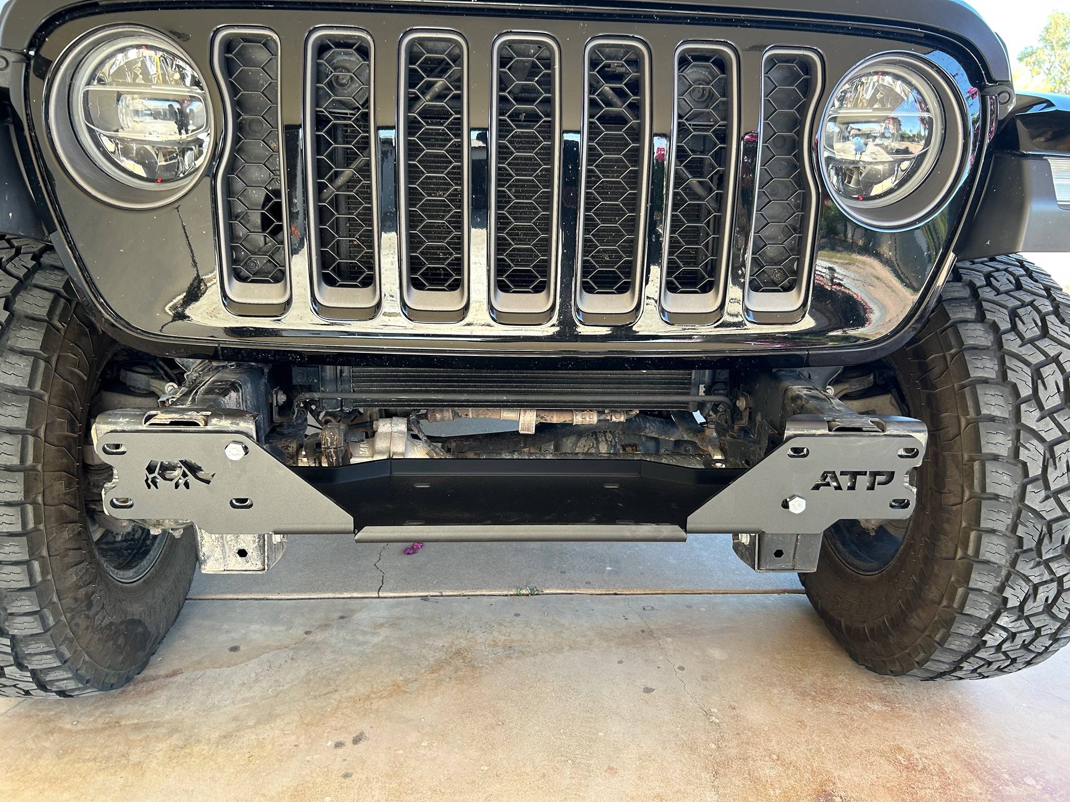

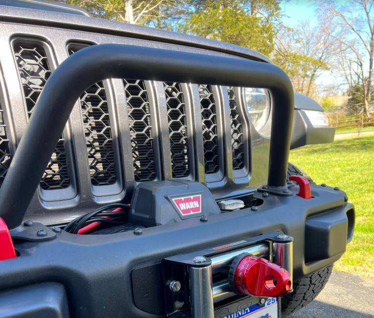

I purchased a winch plate from ATP (american trail products) out of California. They make the winch plate here in the US and they powder coated it. The only issue I had with installing the winch was I got a warn steel cable on sale late last year and the power cables stick out a lot (could be me the installer's issue but it's a good snug fit and the price was very reasonable. took some time to get the plate since it was during the thanksgiving/christmas holidays but overall i'm happy.

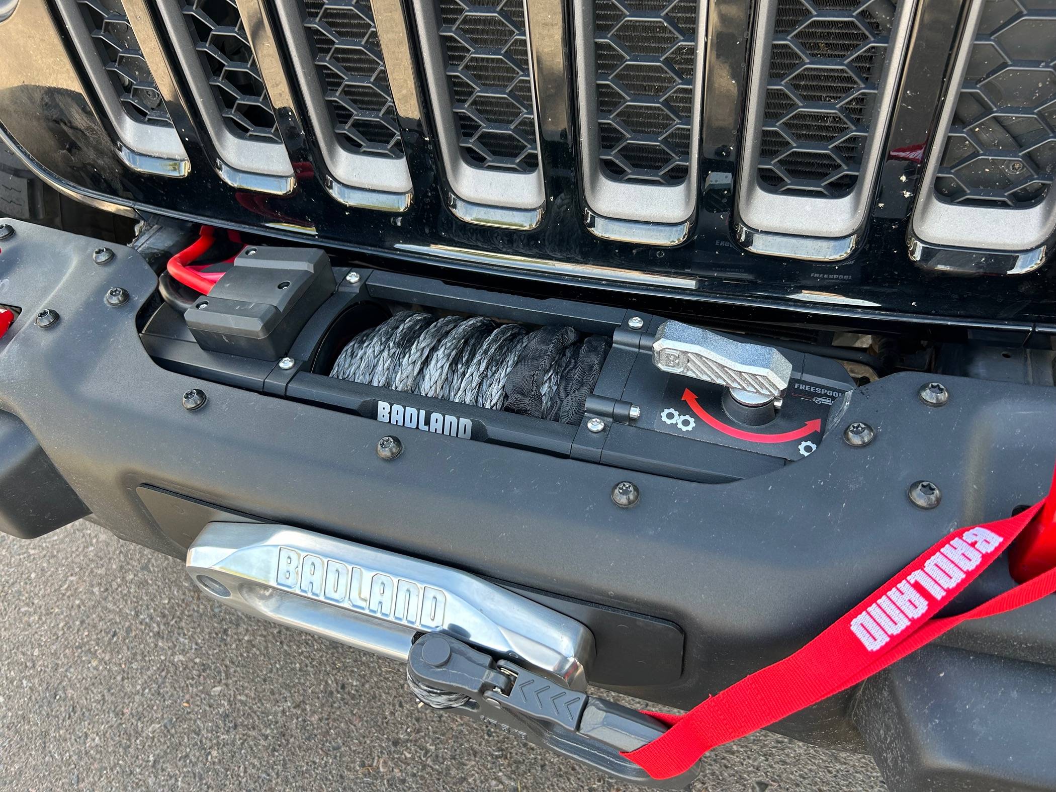

I used the American Trail Products winch plate. Very beefy and very easy one piece install. I also used spacers to bump the winch up to help the clutch lever on the Badlands clear the OEM steel bumper.

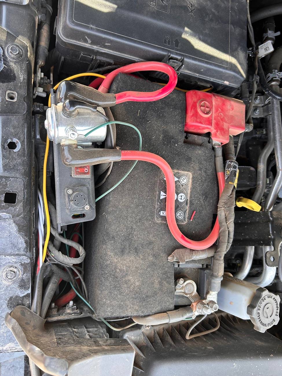

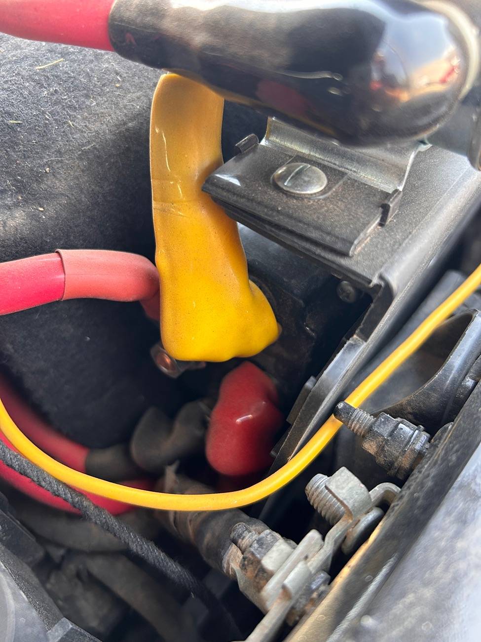

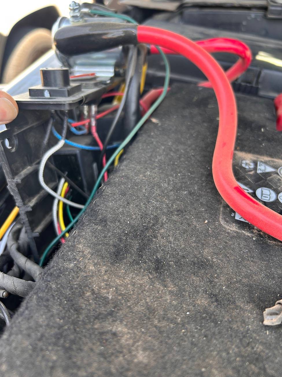

I modified the “box” that comes with the Apex so it would all fit in the space next to the battery. I also recently used the Warn winch solenoid kit to clean up the wiring and have the solenoid act as my cut-off switch which I can then control via my factory aux switches.

I then added an ABS plastic cover over the exposed line. I wrote about this here:
