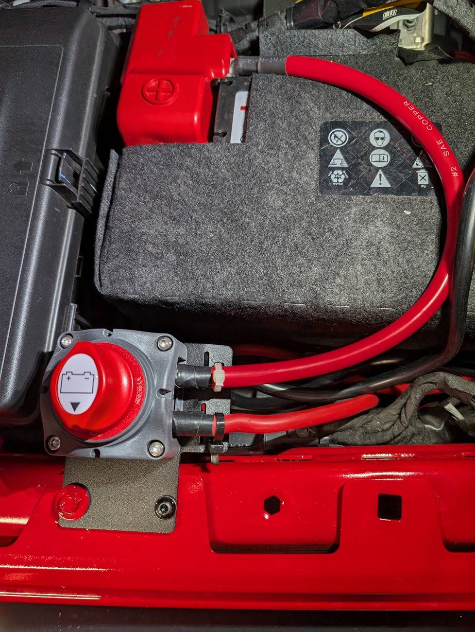

Here is how I routed my positive winch cable and shutoff solenoid. The solenoid trigger goes to an aux switch.
Where did you get the solenoid bracket? I like that set up. I assume the solenoid contact is normally open and the aux switch activation closes it thus providing power to the winch? Also is the coil on the solenoid momentary or maintained (ie: requires continuous 12 power to stay closed)

yes, it is normally open and closed only when powered through the auxiliary switch. I made the bracket by bending a piece of sheet metal.
