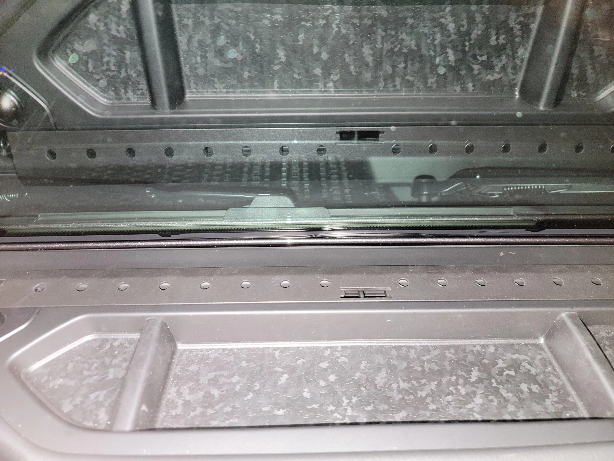

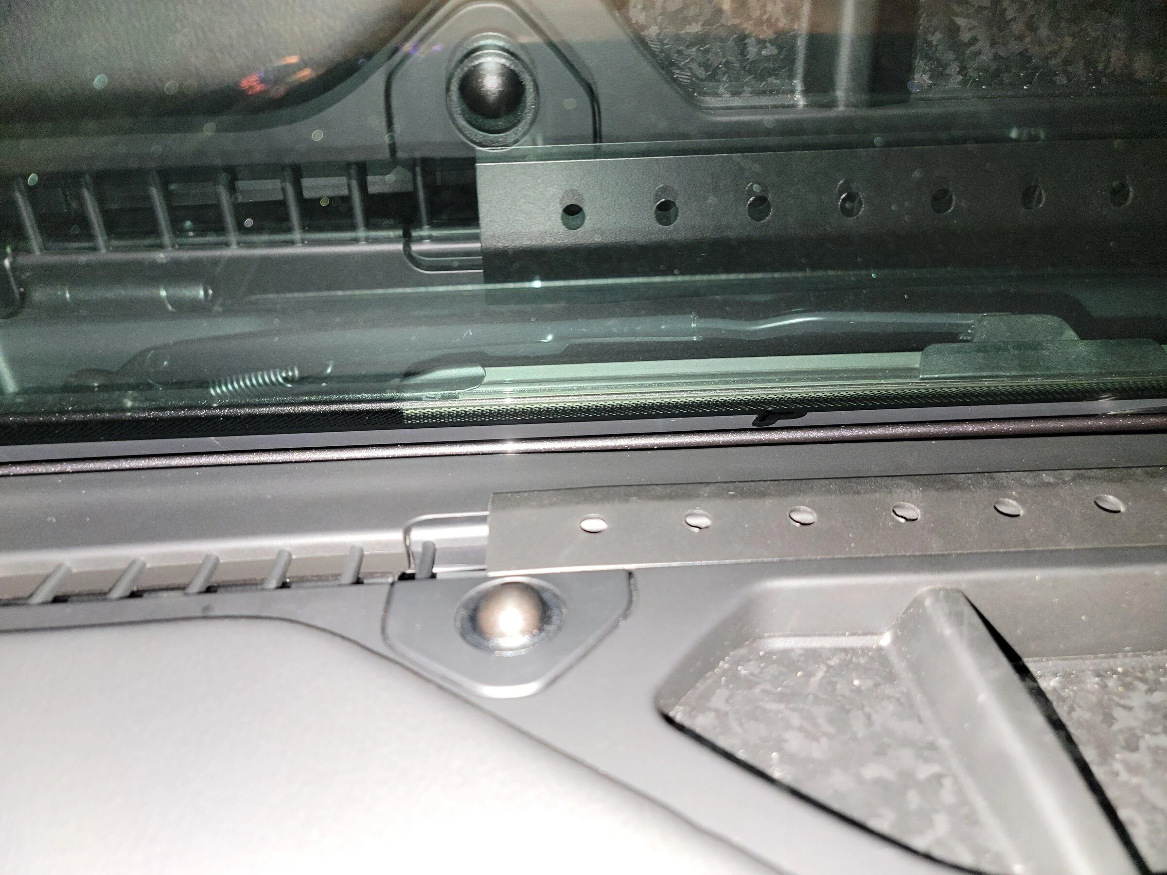

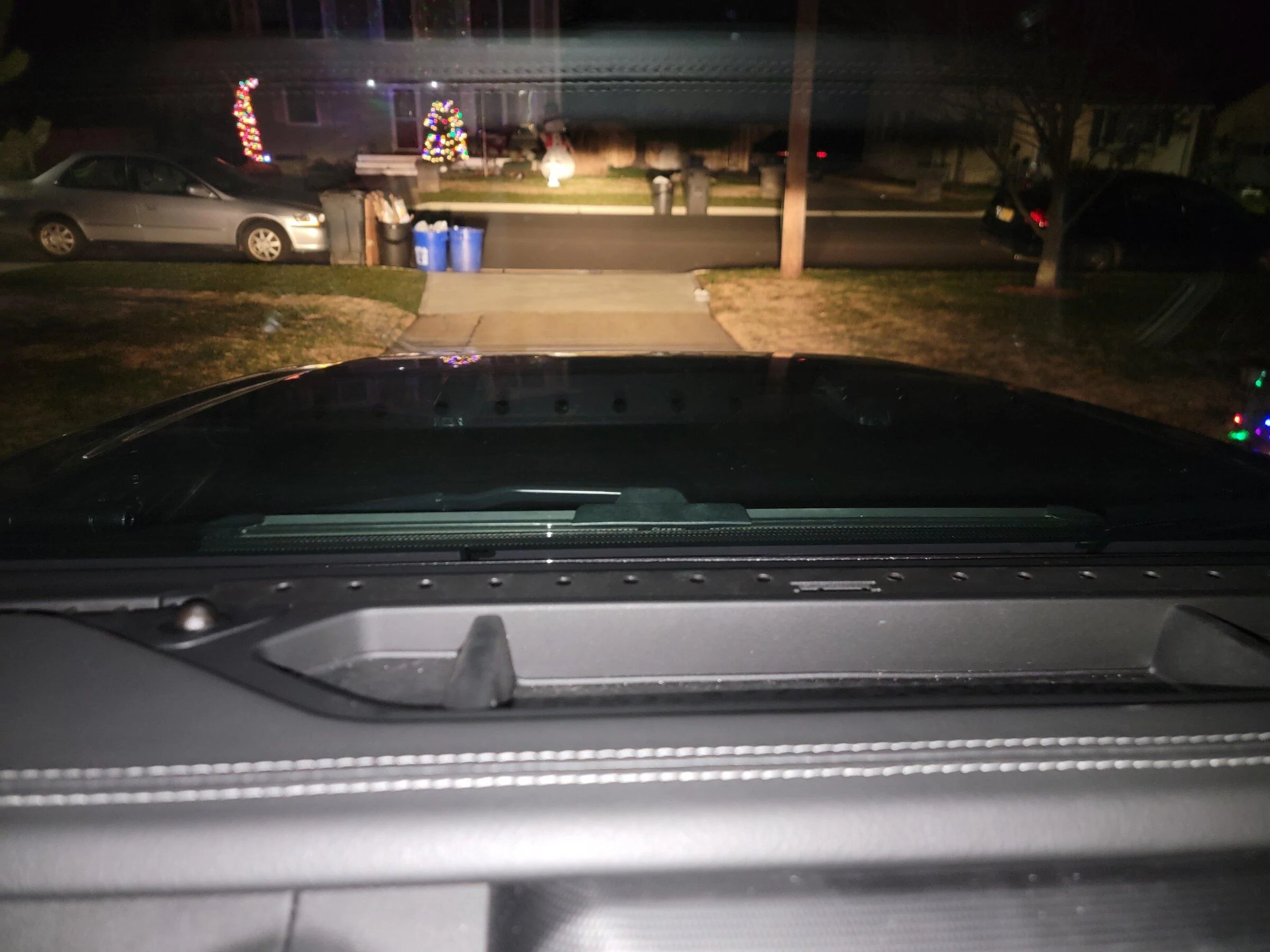

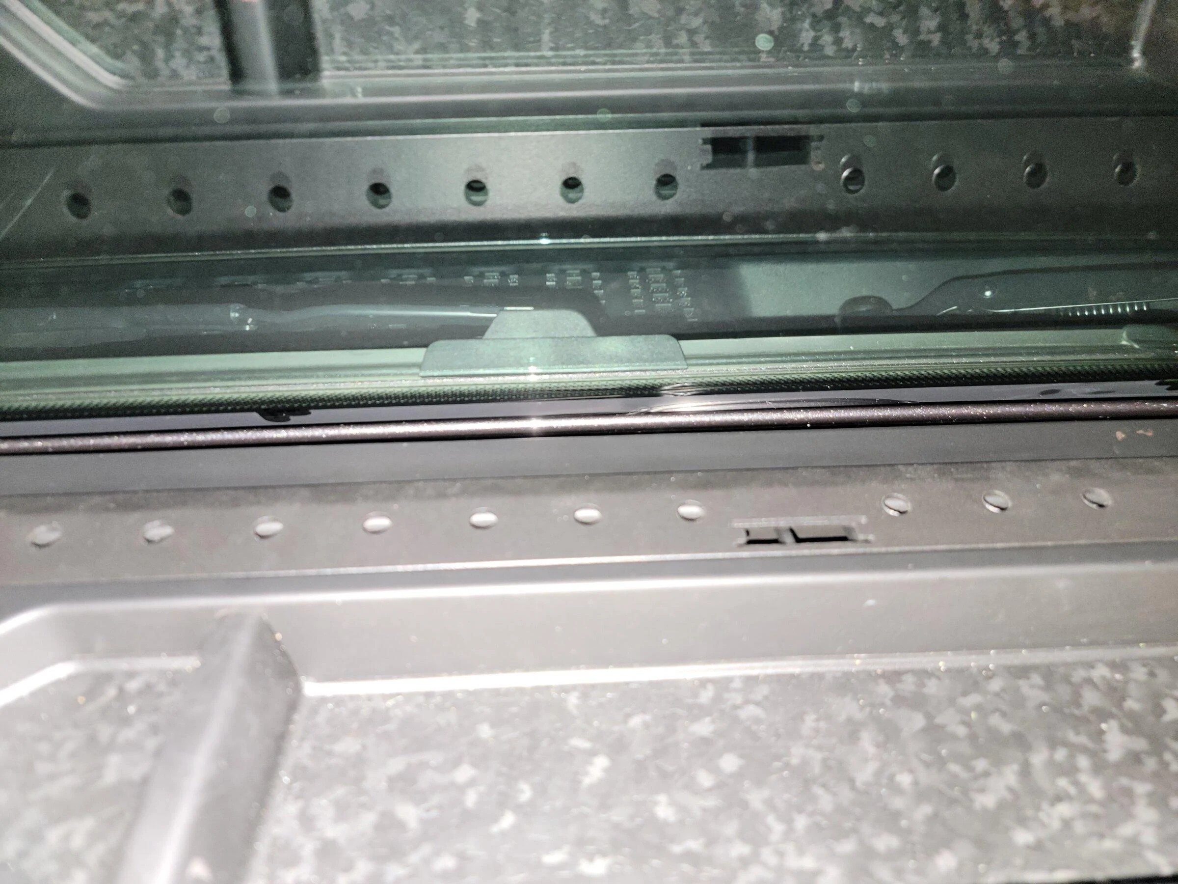

did not feel to comfy with the plastic squares i wound up using a french cleat for a picture frame found at local hardware store for 12 dollars painted it black and used double sided tape. works great plenty of air to the sides and still great flow in the middle. sorry not the best photos
Jeep Gladiator Windshield Defroster fix mod from JL forum 20211221_223152
Jeep Gladiator Windshield Defroster fix mod from JL forum 20211221_223157
Jeep Gladiator Windshield Defroster fix mod from JL forum 20211221_223215
Jeep Gladiator Windshield Defroster fix mod from JL forum 20211221_223253

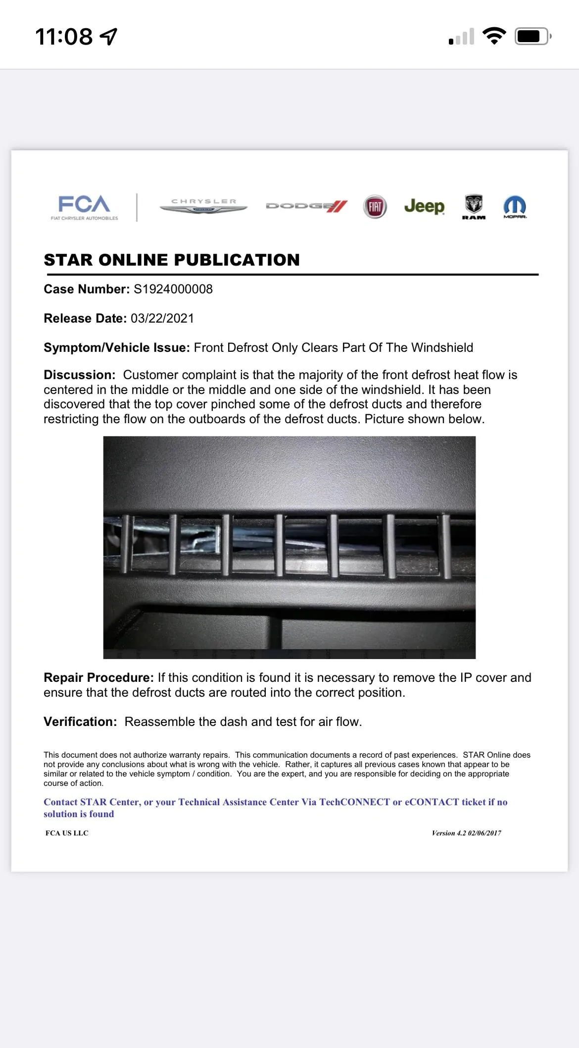

For those having real troubles, has anyone talked to the dealer? A few Gladiators made it through with actual defects -
Download and print the PDF below and take it to the dealer if you have real defroster trouble.

They do have a STAR publication regarding the issue, anyone confirm they don’t have a pinch / incorrectly installed duct work???

Well just checked mine, not pinched shut / assembled incorrectly…..guess I’ll have to look into the vent blocks, I just do not like the looks of them at all…..maybe I can 3D print some low profile fins to angle It toward the edges. Has anyone tried removing the dash/vents? How much of a PIA is It?
