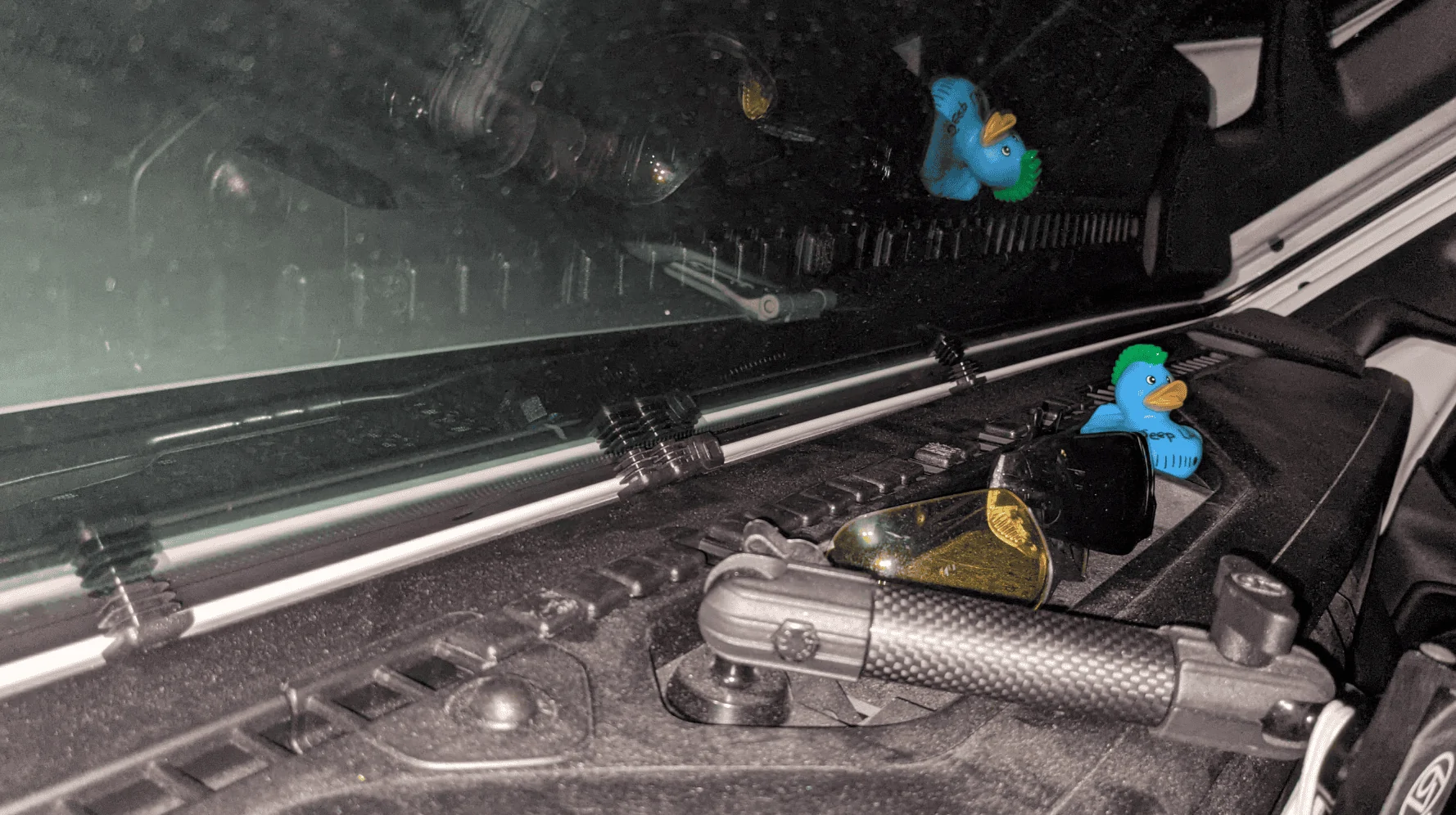

I tried some end caps, the ones I had didn't fit flush and looked like crap. They pushed themselves up and we're uneven looking. I found that if I trimmed them shorter they fit and looked better. So I sat in the drivers seat and trimmed a bunch of them, I installed them in front of me just to test the fit, then I was going to place them in the middle where they are needed. I found out that being shorter now, if I drop one they can fall through the grill. I dropped 2 into the shallow part of the vent, I was just thankful they didn't fall into the vent abyss in the middle. This could have been a lot worse. Laughing at myself, I got a mirror and tweezers and fished them out. What a bonehead. I'd try it again with a different manufacturer, but I tossed the ones I had after the unsuccessful and idiotic attempt.

I did the caps from Amazon as a temporary fix and it does help by forcing more warm air to the problem area which for me is the extreme right and left sides of the windshield. Snow builds up and won't melt. Working on a design with my Wentworth Tech son for him to 3D print on his printer at home.

I bought and installed these a few days ago. So far, I can’t find the right amount of plugs in the center area to even out the airflow to the edges. Also, I’ve had a few plugs come loose and pop free.
I think I might try drilling 1/8” holes in about 20 plugs and cover the whole center section.

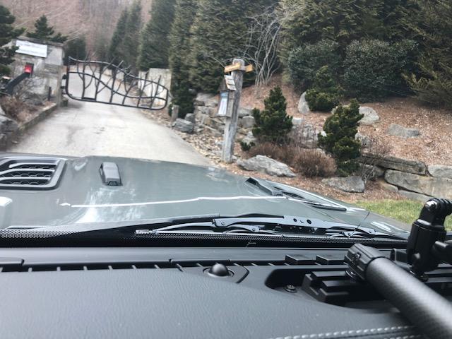

before you do that, put all of the plugs in the middle of the defrost "bar". What i found is enough air still escapes past the plugs to defrost the center, and pushes extra air to the left and right.
i first tried spacing every 5 or so holes, found EVERY HOLE was the best solution.

i put all 24 of them one next to each other from basically that circular thing on the dash just to the left of the phone holder all the way to the right where there's another circular thingy.
Also, it seems like not having any open plugs in the middle makes the pressure stronger, and as it gets colder and the pressure in the vent goes up, more of the plugs blow out.
