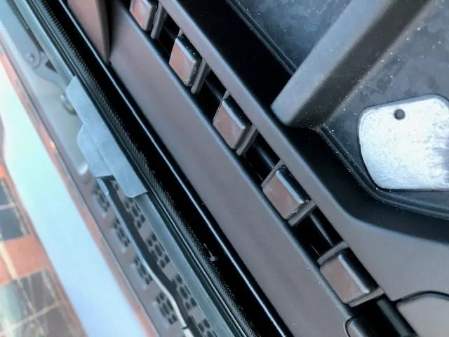

I was able to improve defrosting the sides with just 10 plugs spaced as shown. By default the vent is blowing straight up the center so any blockage in the middle will divert heat to the sides.

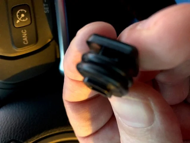

I ordered 5/8" plugs off ebay. Although they fit, they do not fit snug. They tend to pop up when fan on high. I fixed that problem by installing two O rings on the bottom two ribs. I tried just using one o ringin different ribs, but nothing works as well as using two.

5/8" plugs off ebay fit, but do not fit snug. They tend to pop up when fan on high. I fixed that problem by installing two O rings on the bottom two ribs. I tried just using one o ringin different ribs, but nothing works as well as using two.
Nice - Where did you get the o-rings?

Snagged them from work but I'm sure Lowes or any hardware store will have them

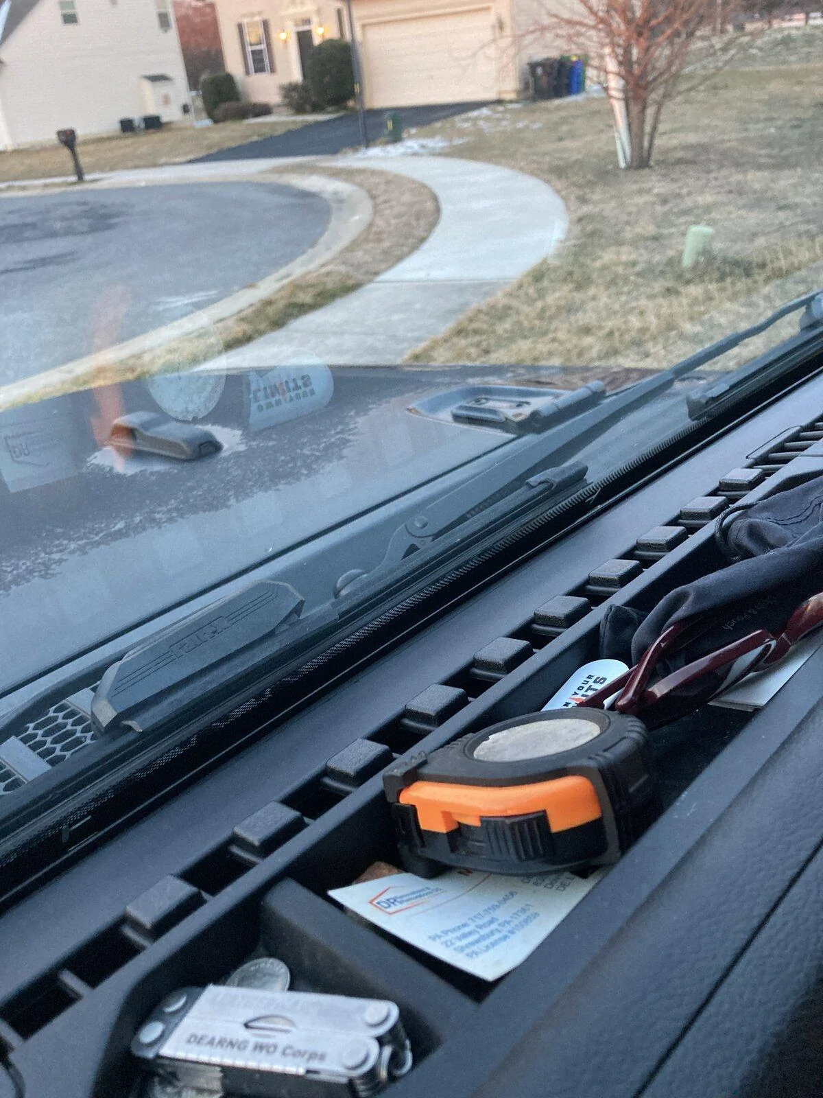

Put mine in this morning. Ive cracked too many windshields on my JKU...not trying to do that with the JT.

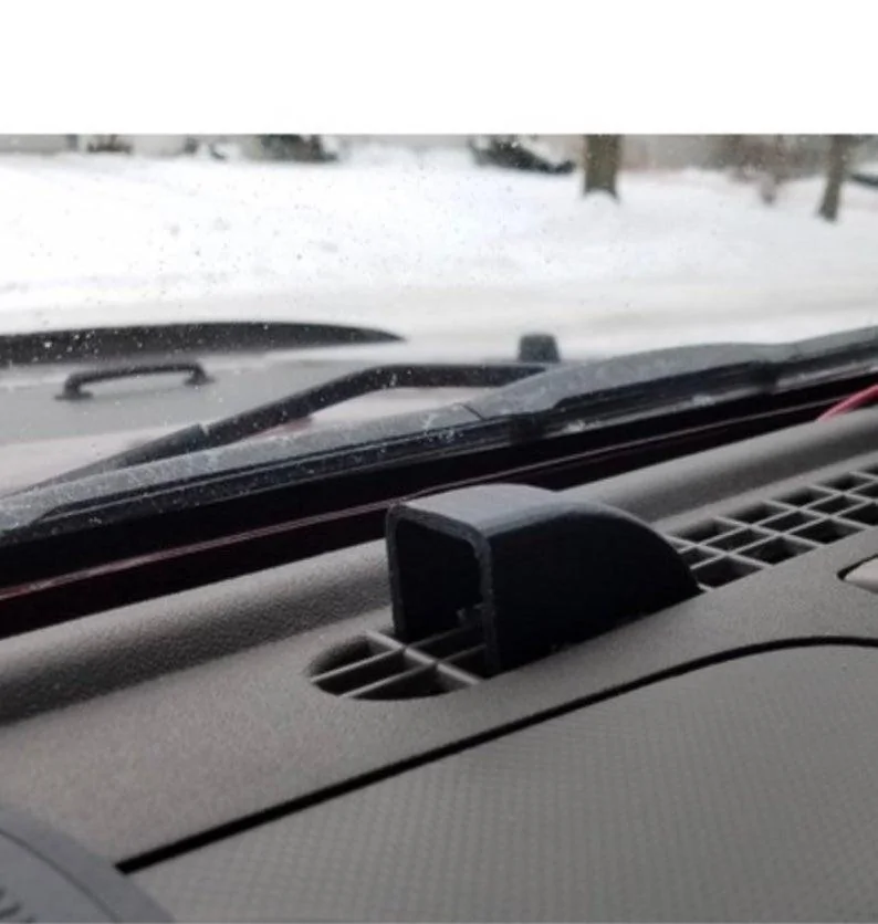

Still waiting to see some of those 3d printed versions from that thread come to market. The plugs look a little cheesy, and nobody seems to agree upon how many/where they need to be placed for optimum air flow to the sides....
Some real airflow engineering was going on in the JLforums thread, and then it all went quiet.
