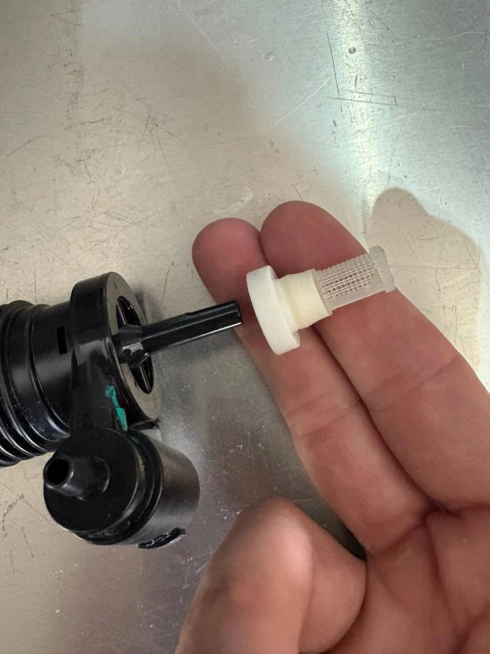

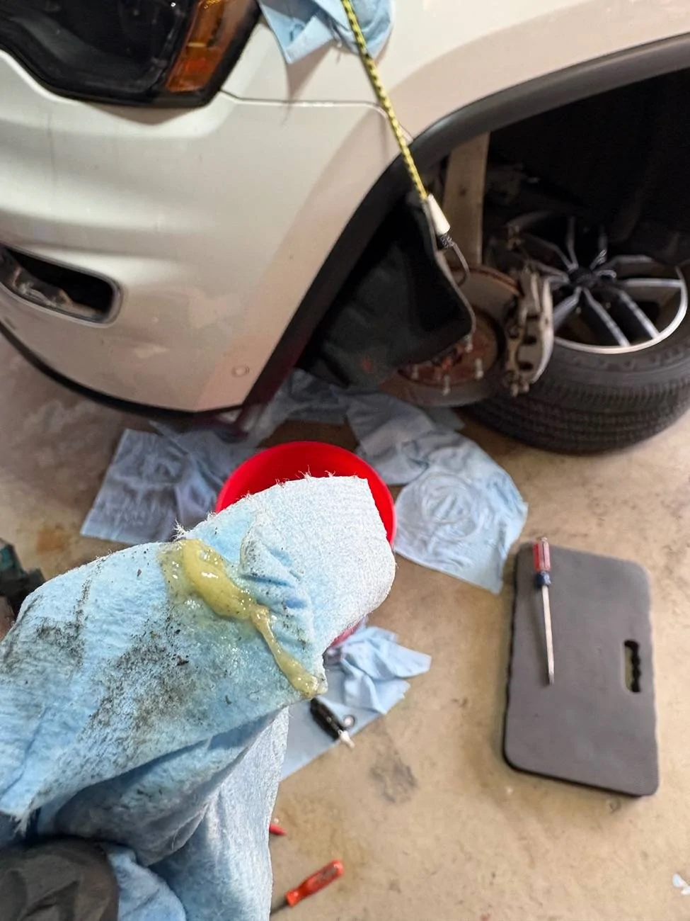

Just had this issue on wife’s grand Cherokee. This is what came out of the pump filter. Using rain-x bug remover. Never again

So, it’s on the end of the pump, it’s attached to the grommet that seals the pump in the reservoir. Now this is on a 2019 grand Cherokee, so may be different from our JT and JLs. Really this would just block large debris, but it was completely gummed up with that stuff from the rain-x. Looks like yellow snot. Had to soak it in vinegar and pinch out all the little holes. Working fine now. Didn’t get in the lines thankfully.

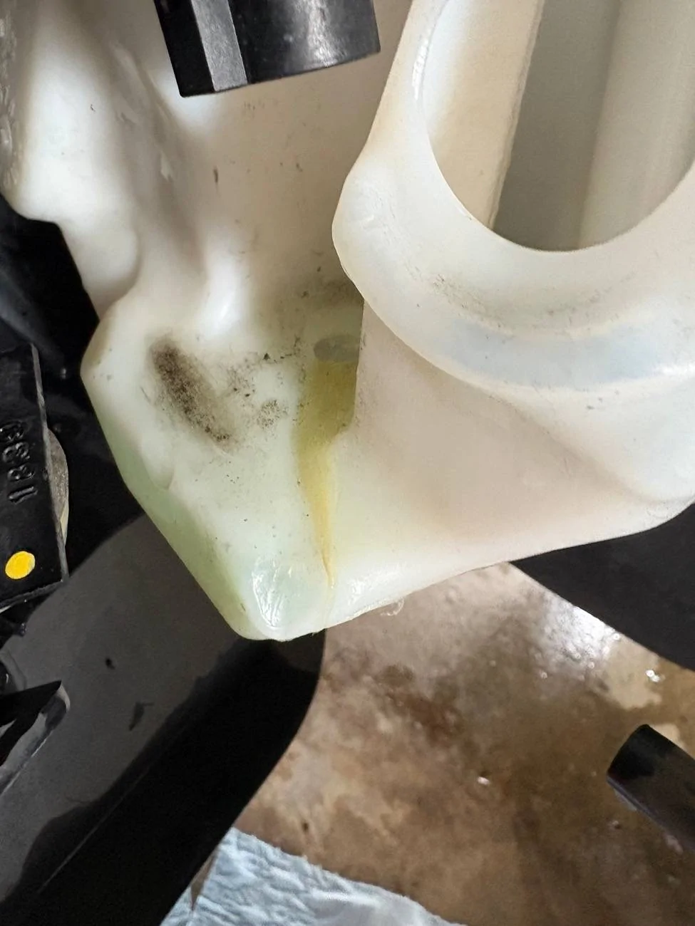

Noticed yesterday my windshield washer fluid wasn't spraying correctly. Wouldn't reach the windshield. I thought it was almost used up so I filled it up but the tank only took half a jug. Still won't work. I can hear the motor working. Is it clogged up? I've been using the green RainX bug remover fluid. Jeep is just over 1 year old.
I just experienced this same issue at the first wiper fluid refill on my 2024 Gladiator. Had to disconnect the plumbing line at the 90, back blow to clear the pump and pump all of the fluid out of the reservoir into a gallon jug, required back blowing through the pump several times. Then ran a half gallon of vinegar/water solution through the pump several times to clean out the pump. Refilled with wiper fluid and has worked fine for the past two weeks.
