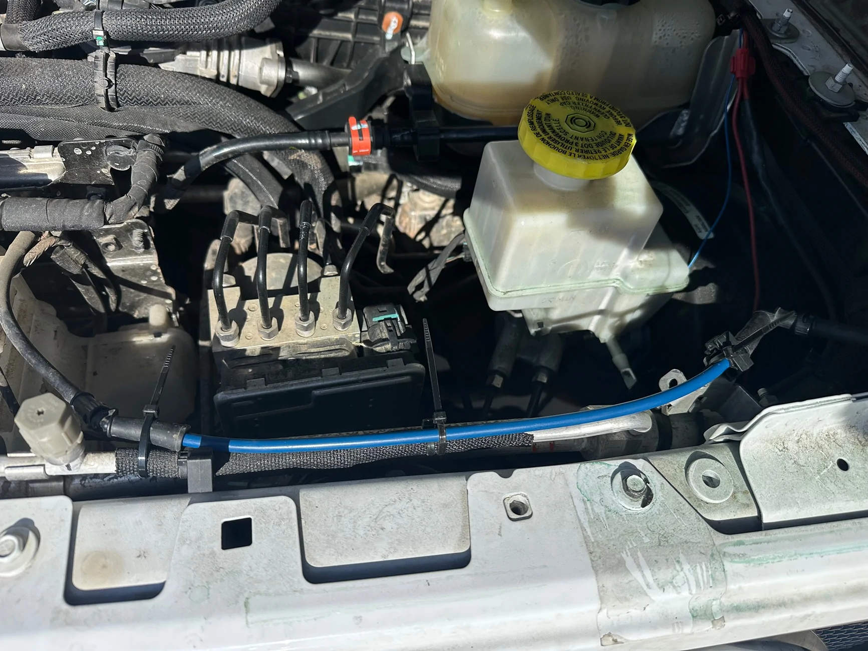

My washer jets were super weak all the sudden. I was thinking pump or jets needed replacement. Upon further diagnosis found the rigid line that runs up the driver side fender was cracked lengthwise and shooting fluid out under my hood! Tried to find the part but the diagrams left a lot to be desired to find the right part.
Turns out some 1/4” air line I had left over from the suspension airbags works great. Pulled the cracked hardline out and put in the blue air line. Photo was from the first try to see if it worked. I’ve since made it longer and straightened it. Works great now, maybe better than before!
hope this helps someone in the future.
