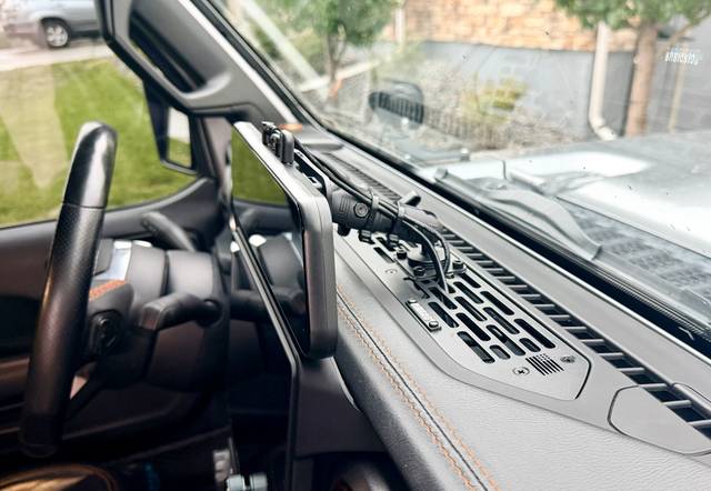

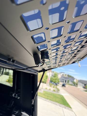

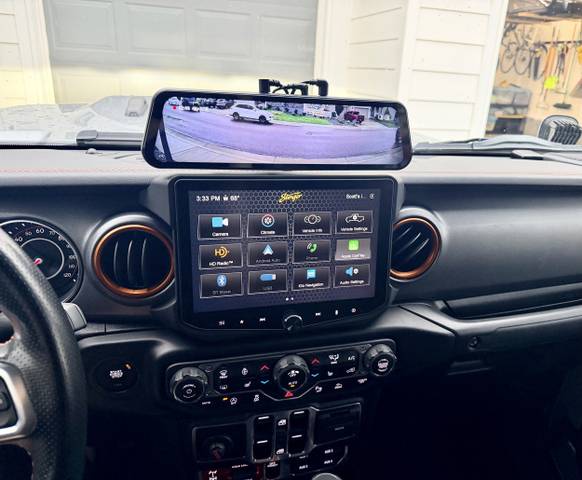

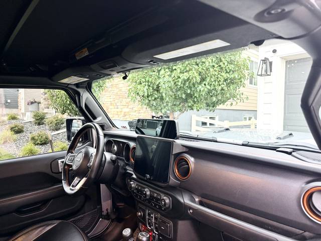

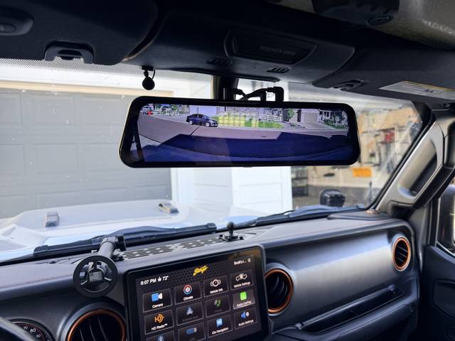

When I added my topper, I also installed a Wolfbox G900 Pro to maintain good rear view visibility. I used their Jeep mirror mount that replaces the OEM mirror. What I hadn't seen discussed anywhere during my research on the G900 Pro was the effect it has on forward visibility out the windshield. The thing is large and JT windshields are small. Not sure if it's because of my height, but I found myself constantly having to duck down to see under the mirror and check oncoming traffic to the right. I saw Bulletpoint has a Wolfbox mount and already had the Rubigrid system, so I gave it a try and it ended up working really well. Drilled a hole in the top of the dash under the mounting plate and ran all the wires through the dash. I did have to file the slot on the Rubigrid a little to get the cable heads through. Now running with nothing hanging down where the stock mirror is and can see MUCH better.
Before:
Jeep Gladiator Wolfbox Mirror Visibility MaHrlN
After:
Jeep Gladiator Wolfbox Mirror Visibility fYqOf8
Jeep Gladiator Wolfbox Mirror Visibility BXkMRZ
Jeep Gladiator Wolfbox Mirror Visibility aRhTvF
